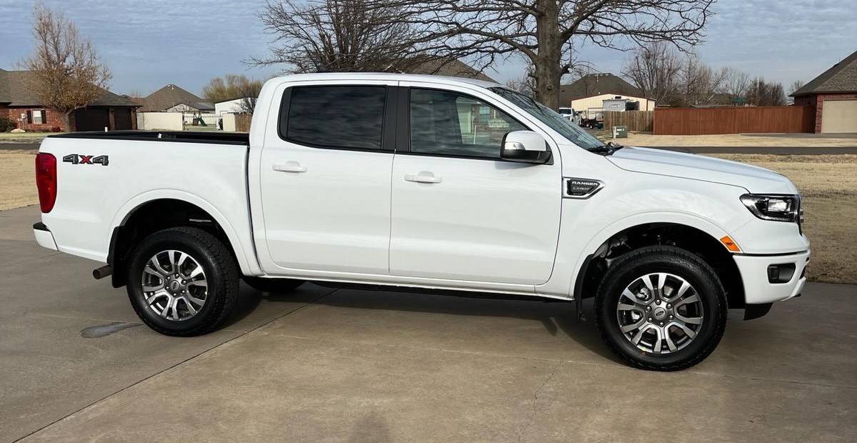

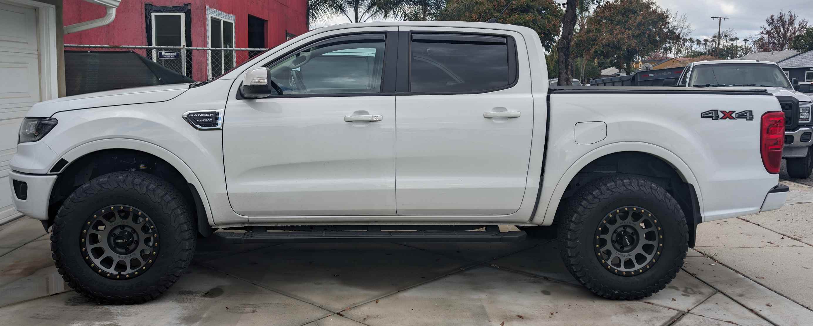

Got myself a bonus at work, so I naturally spent it on my truck. Fox 2.0s adjusted to just level front, with icon UCAs. Methods 17s with 0 offset. 285/70/17. Some slight rubbing on left side on full lock left turn. I believe it's just the liner. Have not been on dirt yet to see how articulation will rub.

That setup looks great. It’s a lot of tire and the level is good. Go do a quick, somewhat aggressive 3-point turn. You’ll soon learn if there will be an issue under compression with your wheels cranked.

OOO trust me I am already looking at an inch lift from where I am now. :)

Nice transformation! The BFG's are likely rubbing on the rear felt liner in the wheel well. I had to cut some of the felt away on the trailing edge and it stopped. I've got aftermarket crash bars that allow more room, but they still slightly rub at full steer and flex.

I’m really liking the look of the smoked out led sidemarkers. Did you go with the Morimotos?
