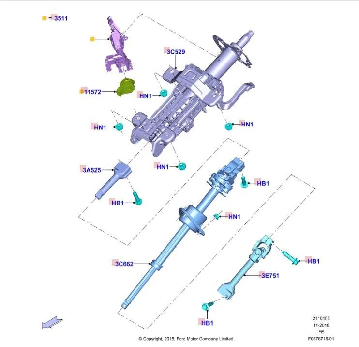

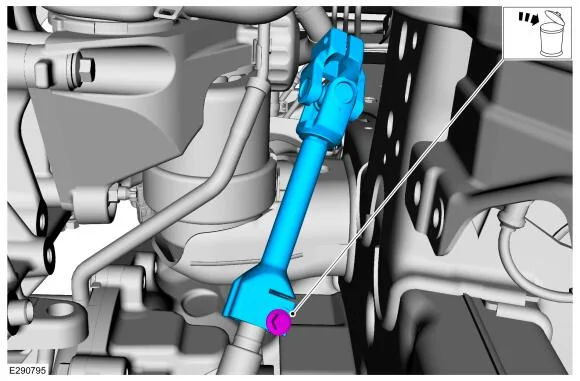

So I assume this was already replaced and they found this to be binding.
The upper shaft (cab side of firewall) also has a coupler union like this, so when you have it in the condition for it to (Thump), place your hand on the shaft while turning the steering wheel and see if you can feel it - most likely (YES)
With you noting that it appears after 10 minutes of driving, directs my attention to the engine bay side of the steering.
So steering gear (EPAS) or steering knuckle, tie rods, ball joints, stab bar links etc, binding slightly when they are heated up (expanding) mainly from braking action - heating up the knuckle.
So when hot (if it does it while stationary) - place your hand on various points that move, I would focus on the stab bar end links and feel for the (Thump) that you are feeling in the steering wheel.
My hunch is that with hands on and possibly a stethoscope you will be able to isolate it down.
Plus - also note Is Lane Assist (On or Off) when its (Thumping)?
Turning Left or Right or does it do it on both turns?
Feel it on (Turn) or (Wheel Return to center)?

That is exactly the part they replaced. I got to looking at it last night and it is still clunking somewhere in the steering shaft. Everything else in the steering is still tight. I will attach a video of what found. I cannot tell if it is coming from the new part they installed or if it is the EPAS. But you can clearly hear the thump or clunk. I am going to send this to my service advisor and see what she says. I will also add that no matter if its hot or cold there is more vibration in the wheel than there should be. It is definitely not a tire issue either because it is not a shake but more vibration that can be felt.

Before the dealer replaced the lower coupling (part with the u-joints) I was getting the clunk when backing up and dry turning in park. Now that it has been replaced it only happens when driving and usually turning especially into a parking lot when it is hot and the truck has driven a few miles. So that lower coupling fixed the binding that was going on which it sounds like what you have. Have you tried replacing that lower coupling?

The main question is what caused the (Lower Shaft) to wear to the point that it started binding.
The (Upper Shaft) also has a (U-Joint) but the shaft is fixed at the firewall.
So pinpointing down to something that is heated up from driving points to something on the engine bay side.
I am just throwing out the possibility that with steering parts expanding and increasing tension on the EPAS - the weak point could be the (Lower Shaft - U-Joint)

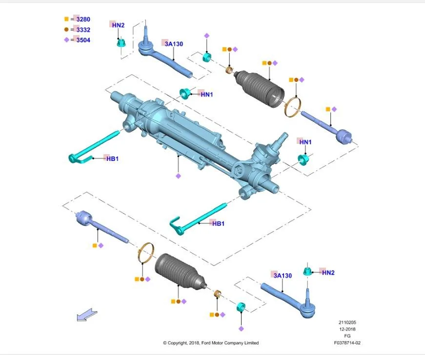

I think I would check the EPAS Gear attach bolts to ensure they are tight, my THOUGHT is that those attach bolts may not be secure, when cold (less resistance) and they may not allow movement of the EPAS Gear, but when hot (more resistance) may allow the EPAS Gear to move slightly, this is the clunk / thump you are feeling and a possibly reason for the (Lower Shaft) to wear out.
Torque Spec for the EPAS Gear Bolts = 122 Ft Lbs
Again this is something to check along with Steering Knuckle Etc

Is the EPAS gear bolt the long bolt that bolts the steering rack to the frame?
airline tech
Aug 24, 2022
4,447
8,496
Midwest - KS
Aircraft Tech
Yes - EPAS - Electric Power Assisted Steering - Gear is its official name.
It incorporates the electric portion of it as
PSCM - Power Steering Control Module adjusts assist - speed dependent.

I just checked and both are properly torqued so I don't think that is the issue.
