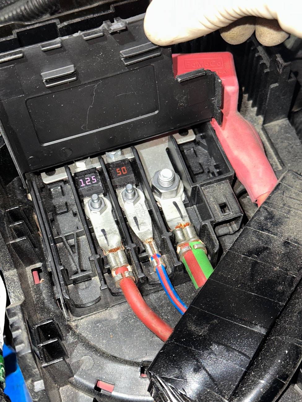

Some other quick checks.
Check the High Current Fuses (Under the BJB) must be removed to get access to them and pull and reseat the DC/DC Convertor connector.
125 Amp = BCM
50 Amp = DC/DC Convertor
The Red / Green Cable = Runs up to the BJB
This area is prone to water intrusion.

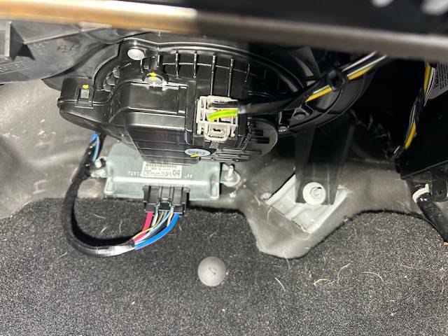

DC DC Convertor - Location
Right behind the Blower Motor
There are numerous things that can be the issue, so we need basic T-Shoot first for power checks.
