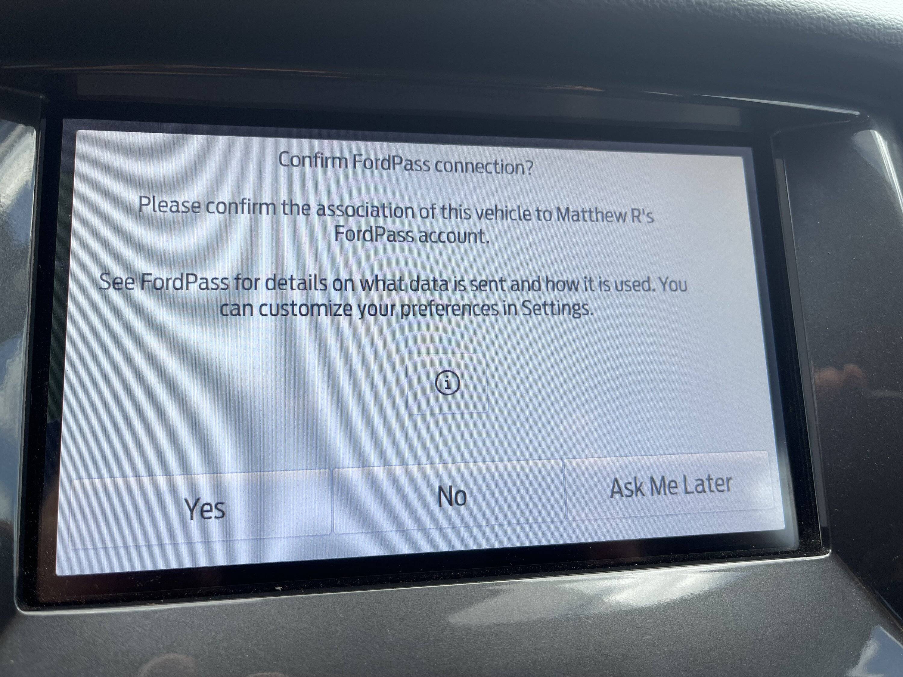

...and out of the blue, Fordpass started working again. This screen popped up when I got home, screwy!
