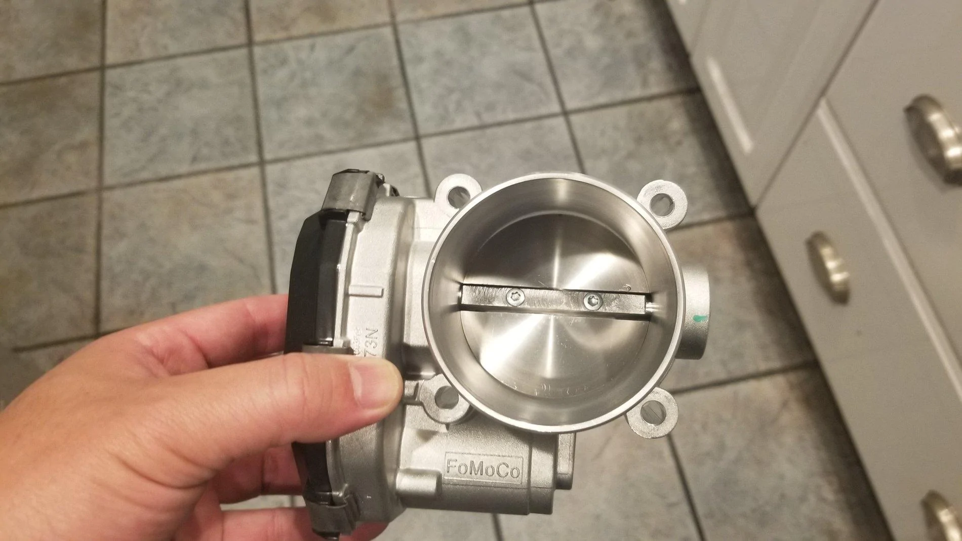

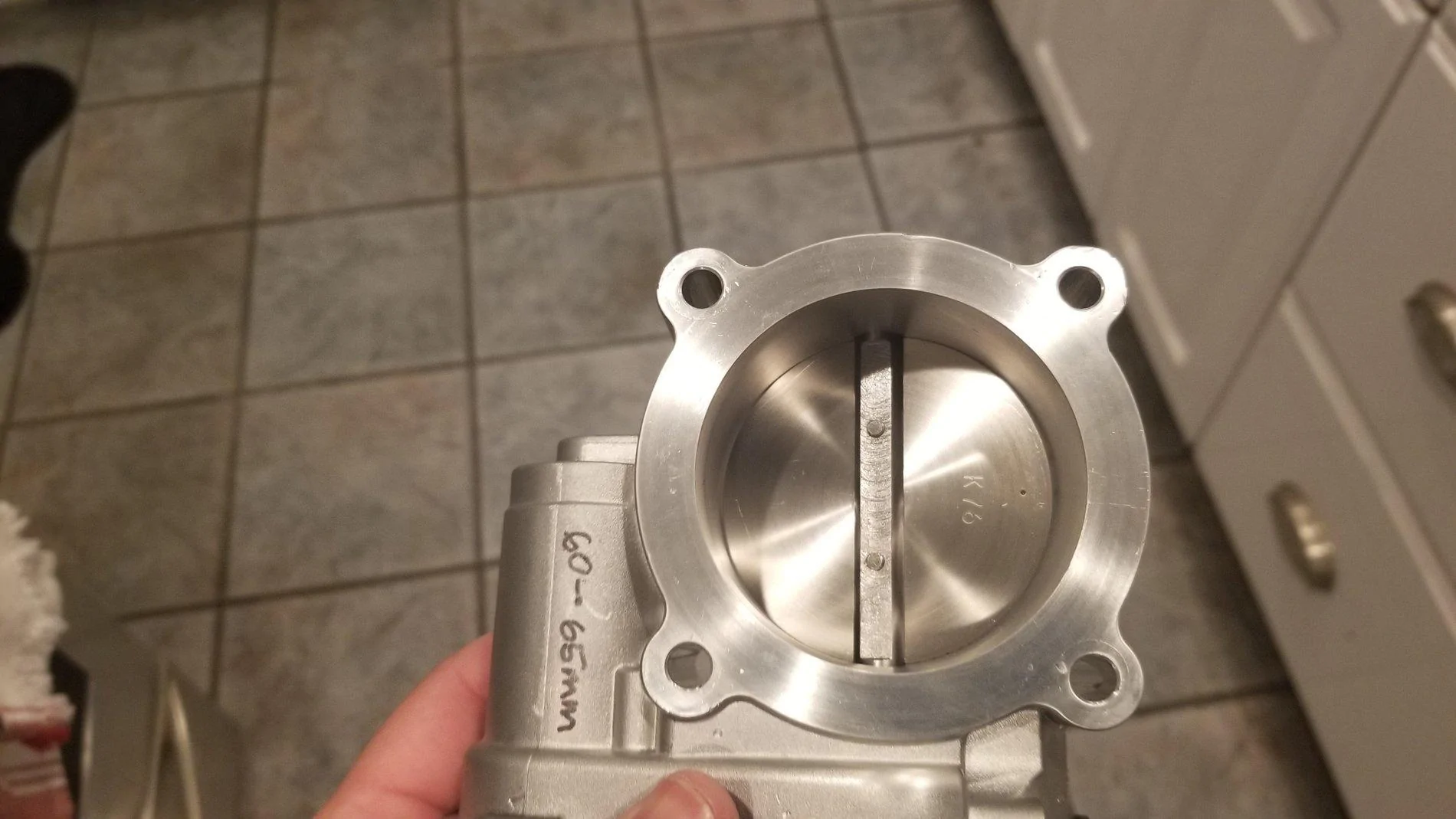

Bored throttle body. 65mm. Anything more is useless as the intake is 65mm.

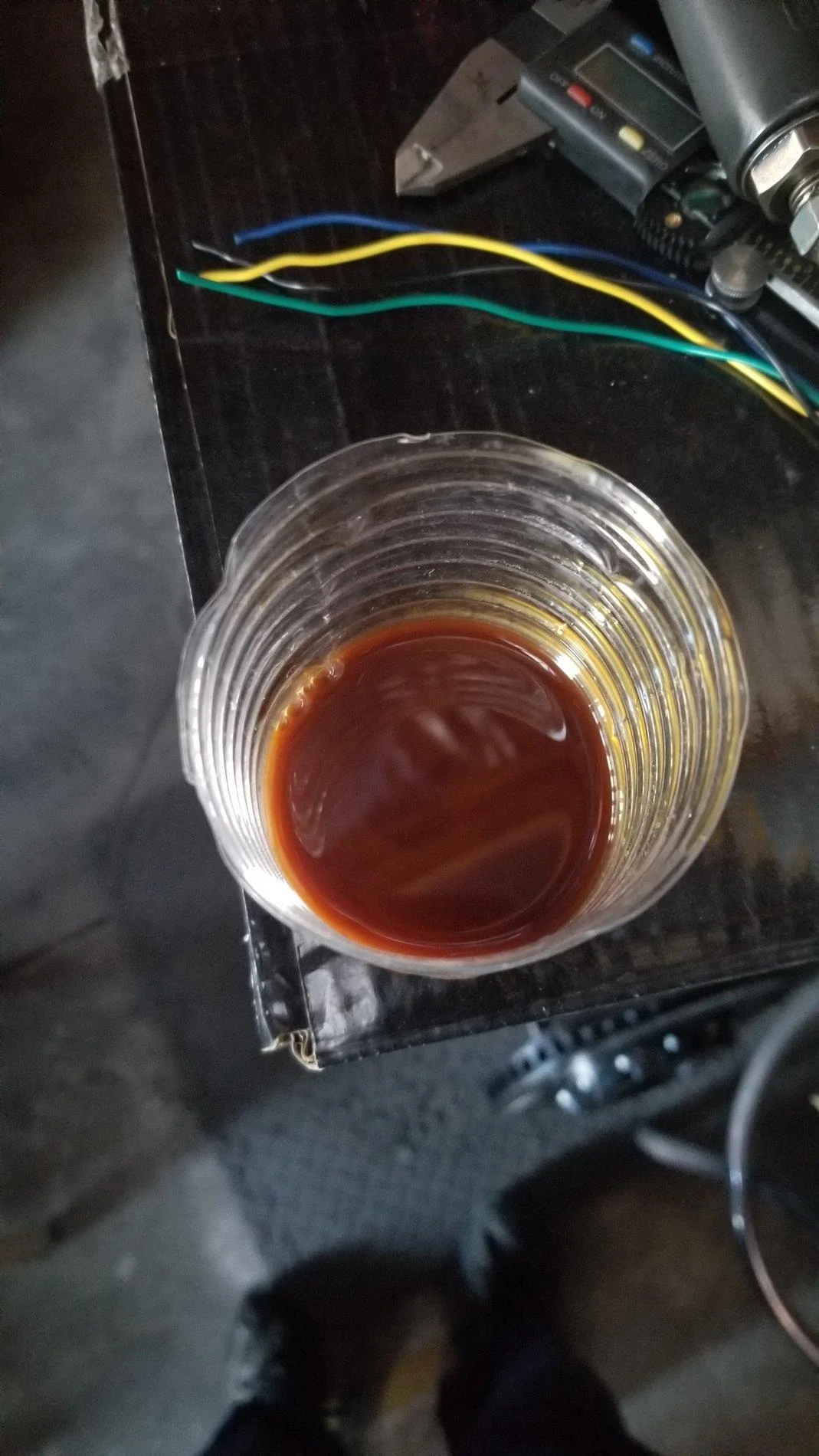

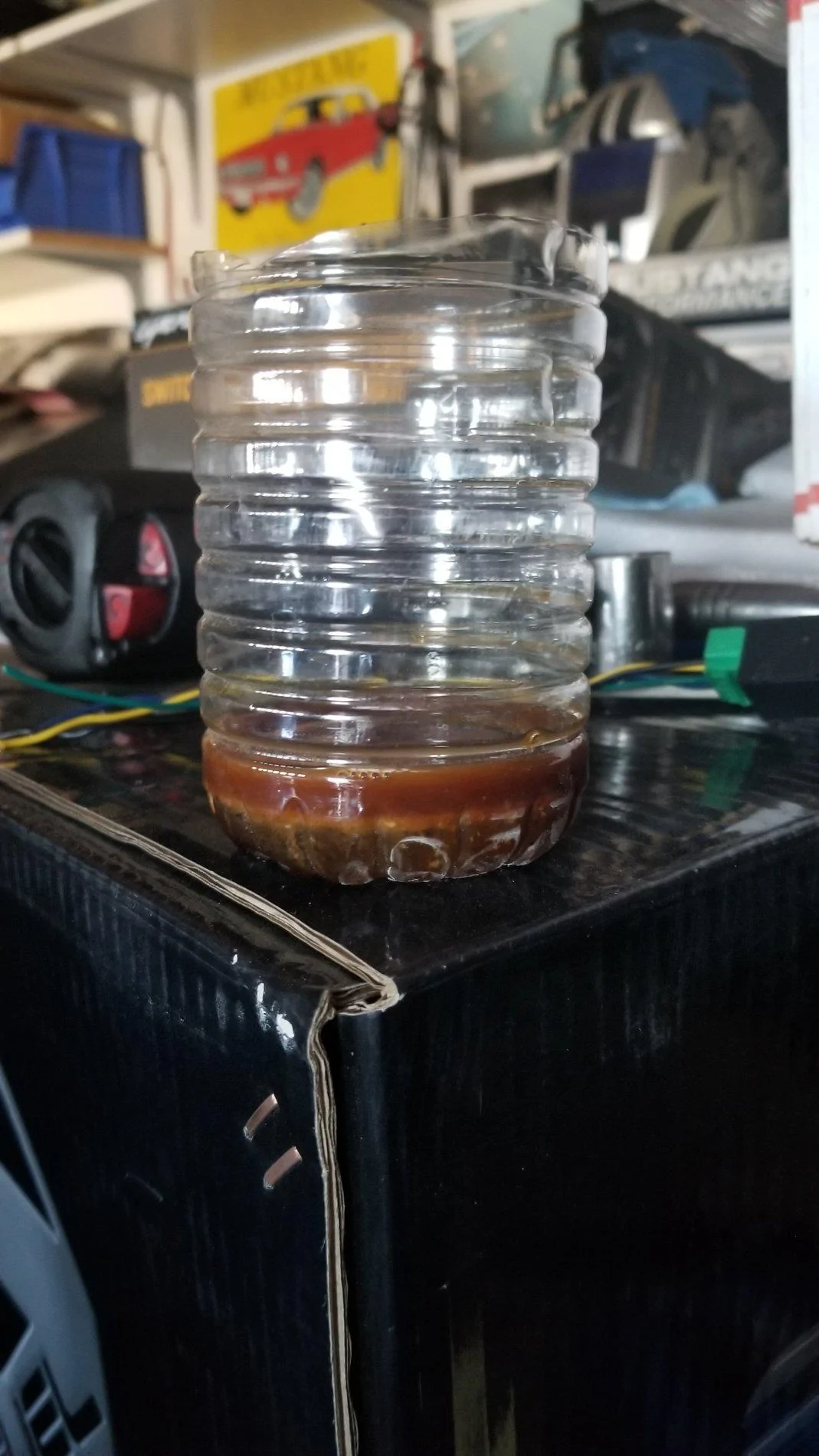

The amount of junk caught in the catch can in 5600 miles. This is cumulative. I'm saving the oil and adding future drains into this so over time you can see how much in total is collected at what mileage.
Nice! I just checked my UPR can and it had about 2 tablespoons worth in the 2 weeks it was on, driven maybe 200 miles tops. This being my first ever catch can, what was your consistency like?
RCMUSTANG
RCMUSTANG
Ray
Jan 22, 2019
1,790
1,937
Los Angeles
2017 Fusion 1995 Ranger
A mixture of oil with water. Some of it pretty chunky. I'm glad I tied in the breather side. That's when I started collecting the moisture/water vapors. When it was PCV only it collected only oil.
