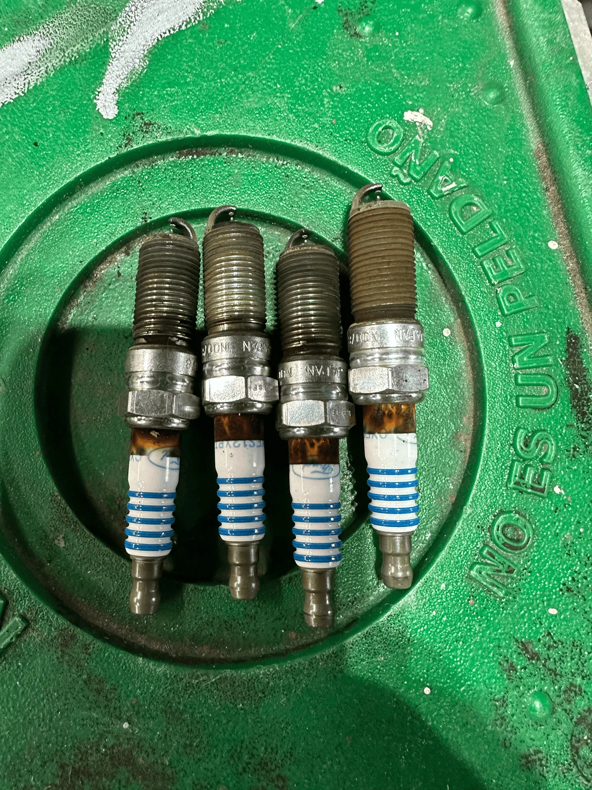

Just did my plugs and it went very well. The 4th plug came out a little rough and the threads were not as clean as the previous 3. (see pic) Put everything back one by one and fired it up seemed fine, but got int the car to take a quick test drive and it had the flashing engine. restarted it and the flashing enf=gine was gone, but definitely a miss. I did not feel like spark plug 4 coil was sitting properly. Reseated and still not doing great, Please let me know your thoughts.

Was that rusty/crusty plug #4?

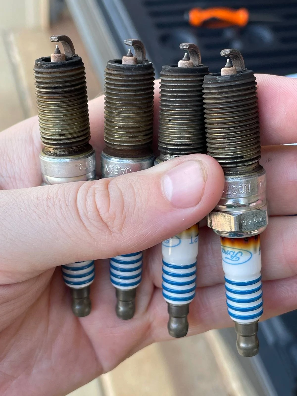

I just did mine yesterday at 60K miles. I'm having a hard time seeing how you could bolt down the coil with the plug boot askew. Did you torque the plugs to 106 in/lbs I hope?

Yes, with this COP design, it's a pay attention (by feel only) install, the most important is that small little (snap -click) of the terminal end snapping onto the plug, plus with the corroded threads it is most likely that the inside of the boot also had some residual rust deposits, Ford actually recommends replacing the boot as well with visible moisture evidence.

***It could be nothing but maybe something to look into on Cylinder 4 with the threads. All four of mine appeared to not have super dirty threads @ 60,000 miles.
