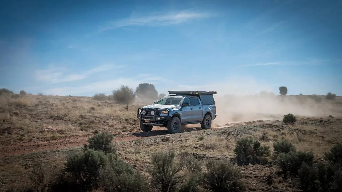

Here's a photo of my truck, this is on Toyo ATs. Headed to Baja for three months on Thursday and should manage to get a photo or two of it while there, too.

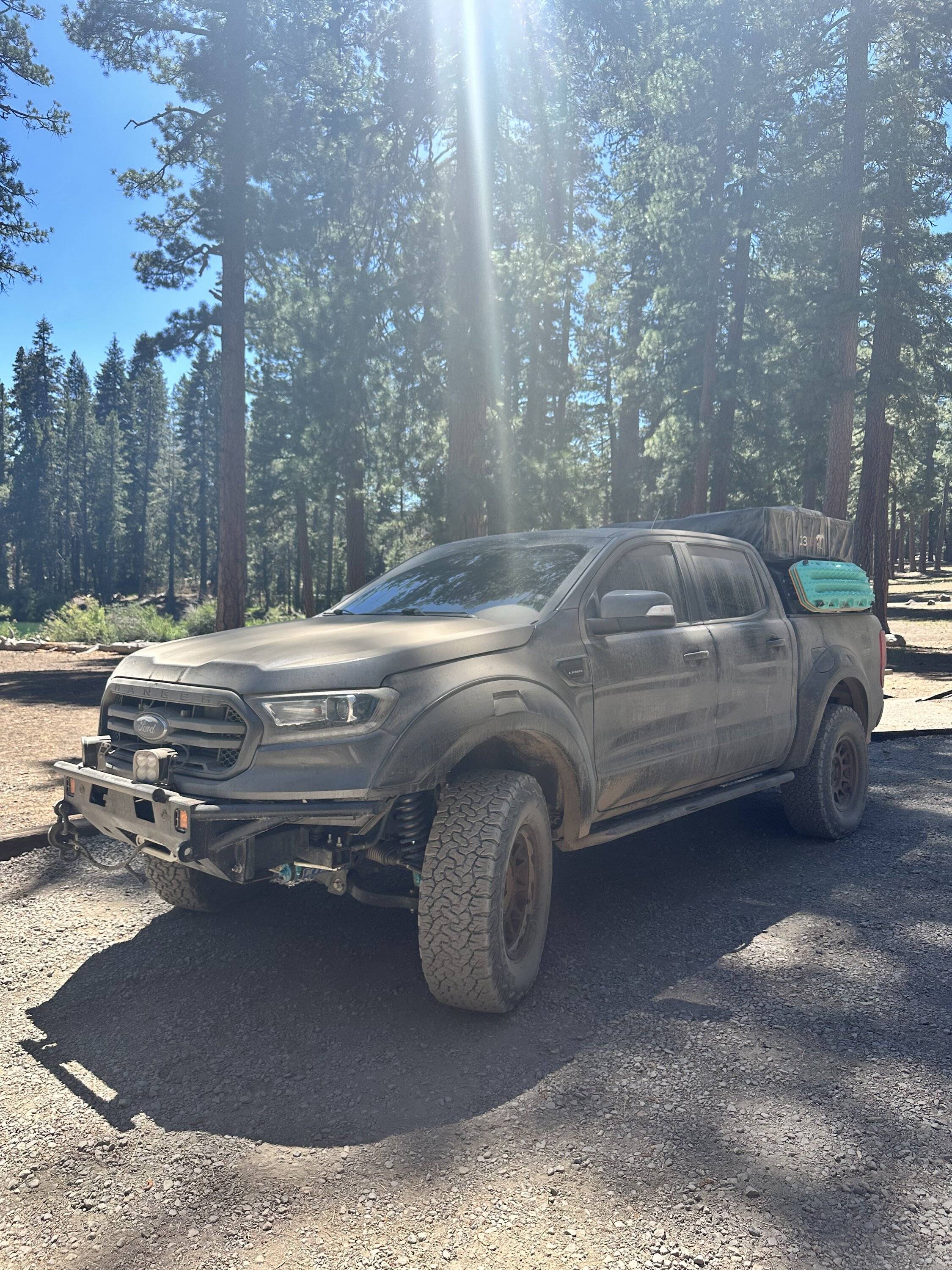

do you have a pict of the coastal front bumper? How do you like it, does the adaptive cruise etc work with it?
This is @AndyMedic's truck.
Thanks for the advice, your truck looks great. What front suspension are you running with the arb front bumper? Or was your advice for OME medium all the way around?
Here's everything: https://wessiler.substack.com/p/your-guide-to-building-the-ultimate
Just kept my life simple and am running a full OME BP-51 system for everything. Not only is this much higher performance than other options, but it's way higher quality too, in the sense of giving us consumers stuff we want like long maintenance intervals, no squeaks, weather resistance, etc.

I love the coastal I got it for a winch and it works great. high clearance and easy access to the clutch and controller. I use a Rough country relocation bracket because they’re all the same (pretty much). It works great also i know some people have trouble when you get into stupid amounts of lift 3+ inches but not a problem for me I do lots of long drives and never think about it

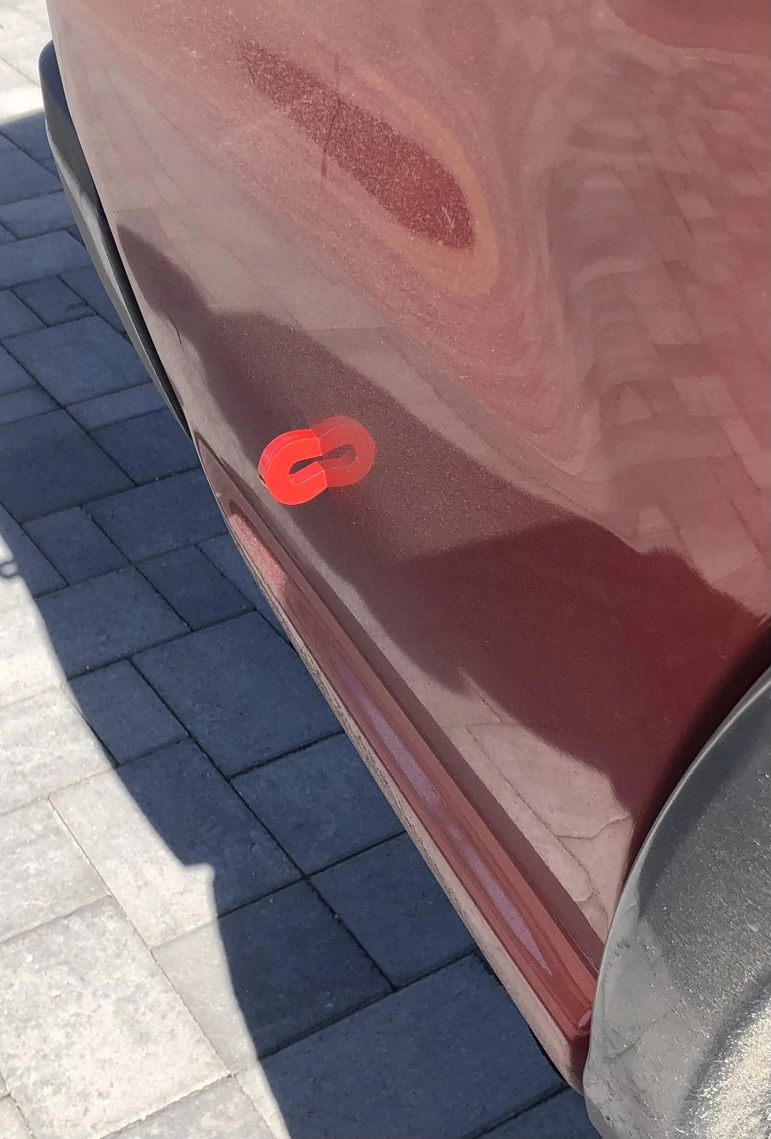

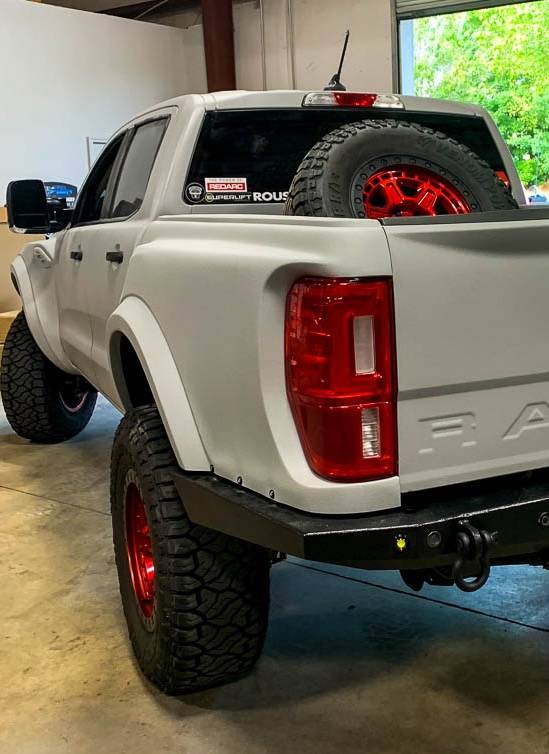

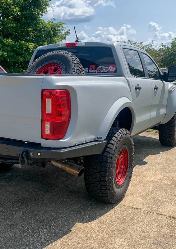

You have to trim a whole lot more than the bottom of the bed. Here are pics from the Coastal site showing where they have trimmed the fender (not aluminum) and put in rivets through the steel. I've also included a photo of a magnet on the rear fender of my Ranger showing it is steel.
