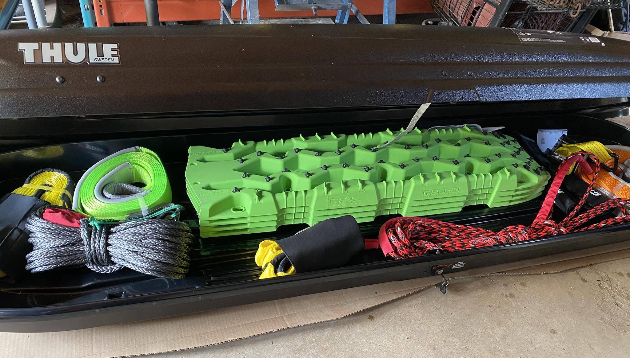

I do allot of solo tripping and recovery is just on me. I have a front winch, but I also carry a Bailey's Synthetic Line Puller every time. It's the best manual come-along I have ever used, and invaluable as a 2nd direction puller if you have lateral sliding.
https://www.baileysonline.com/wyeth-scott-ratchet-puller-3-ton-with-35-amsteel-rope.html
I carry excessive and redundant gear - 3 hard pulleys, 1 soft pulley, 2-5 bow shackles, 3 soft shackles, 8, 16, 20, 30 foot straps, 30 foot kinetic, 50' and 100' synthetic extensions, long handle shovel, chainsaw, and 4 TReD PRO recovery boards.
This is not a cheap package to put together, and I don't know the trail you guys are running, skill levels, if there are other groups on it daily, cell service, emergency access, etc. but with limited cell service, or unlikely to see others groups, at minimum I recommend at least 1 winch or manual puller 3 shackles, 16' & 30' straps, and a 30' kinetic.
A kinetic rope is handy, but also limited use on rocks, and tight trails.
Some of my gear:

looks like a well put together kit! better to have and not need than need and not have. great minds think a like. glad to hear you have the full size shovel. every time i see someone in a fancy rig and then the tiny shovel hanging on the bed rack i shake my head. ive never had to use most of my kit but, the shovel has been used a lot.
