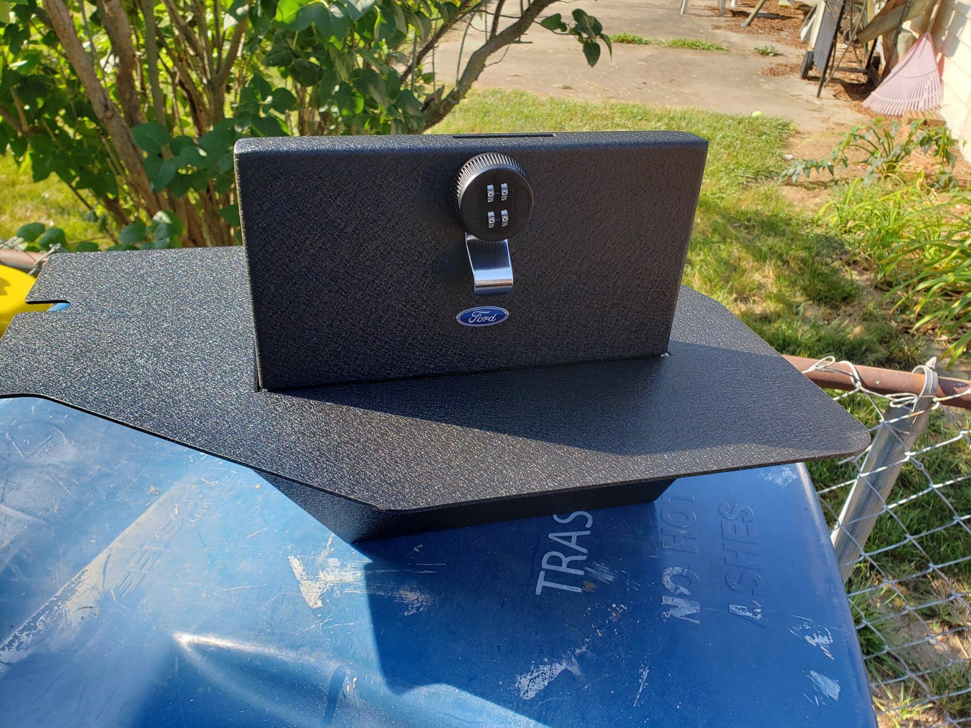

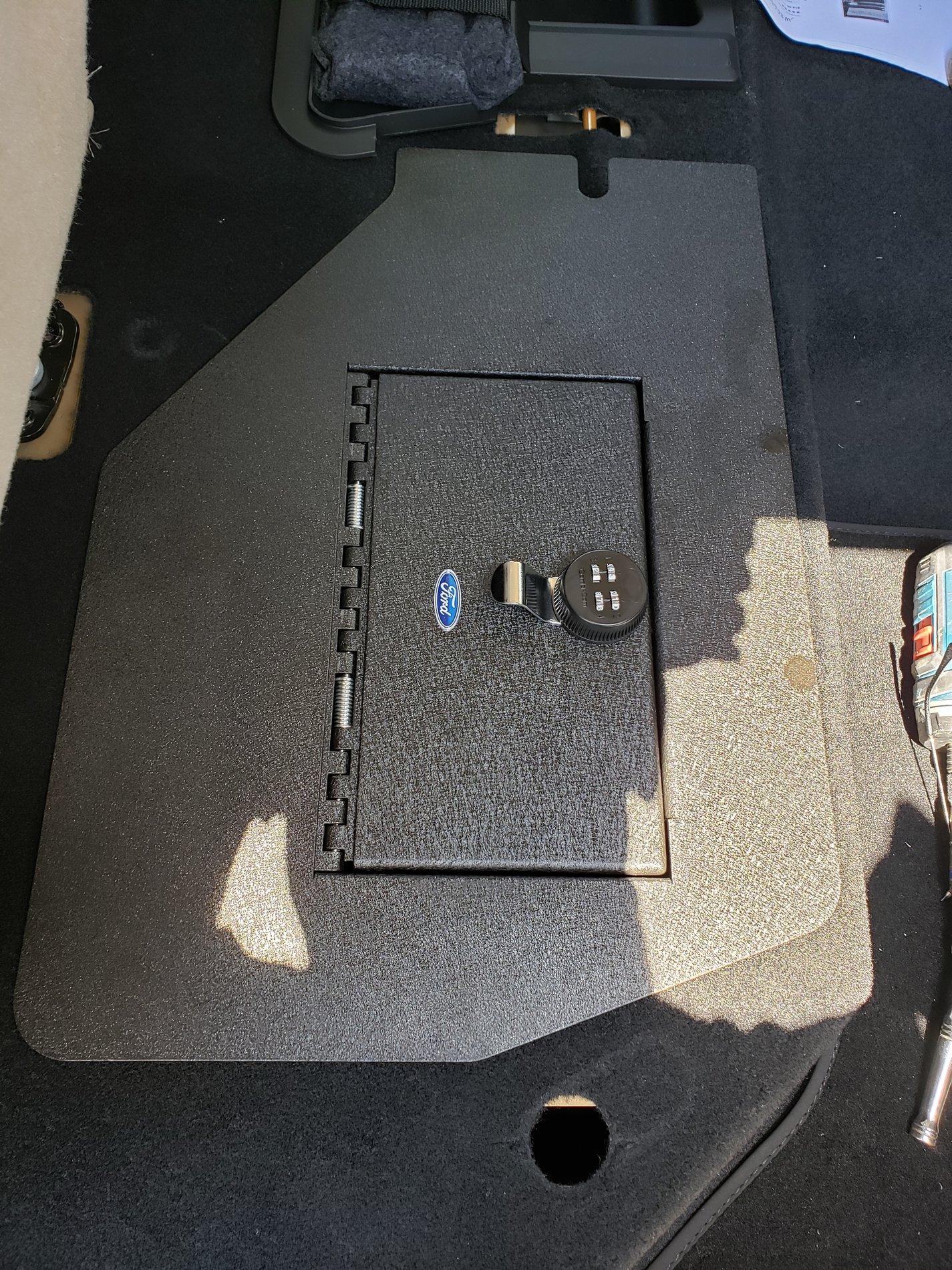

I installed the floor safe that drops in below the passenger side back seat. Although I will post the instruction sheet it's simple enough to install.

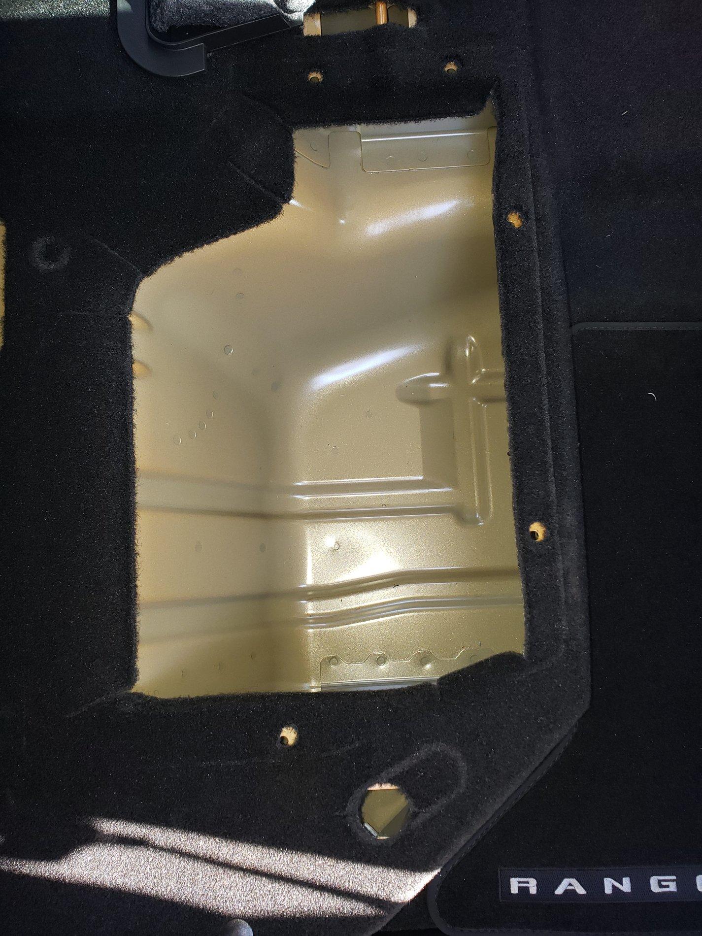

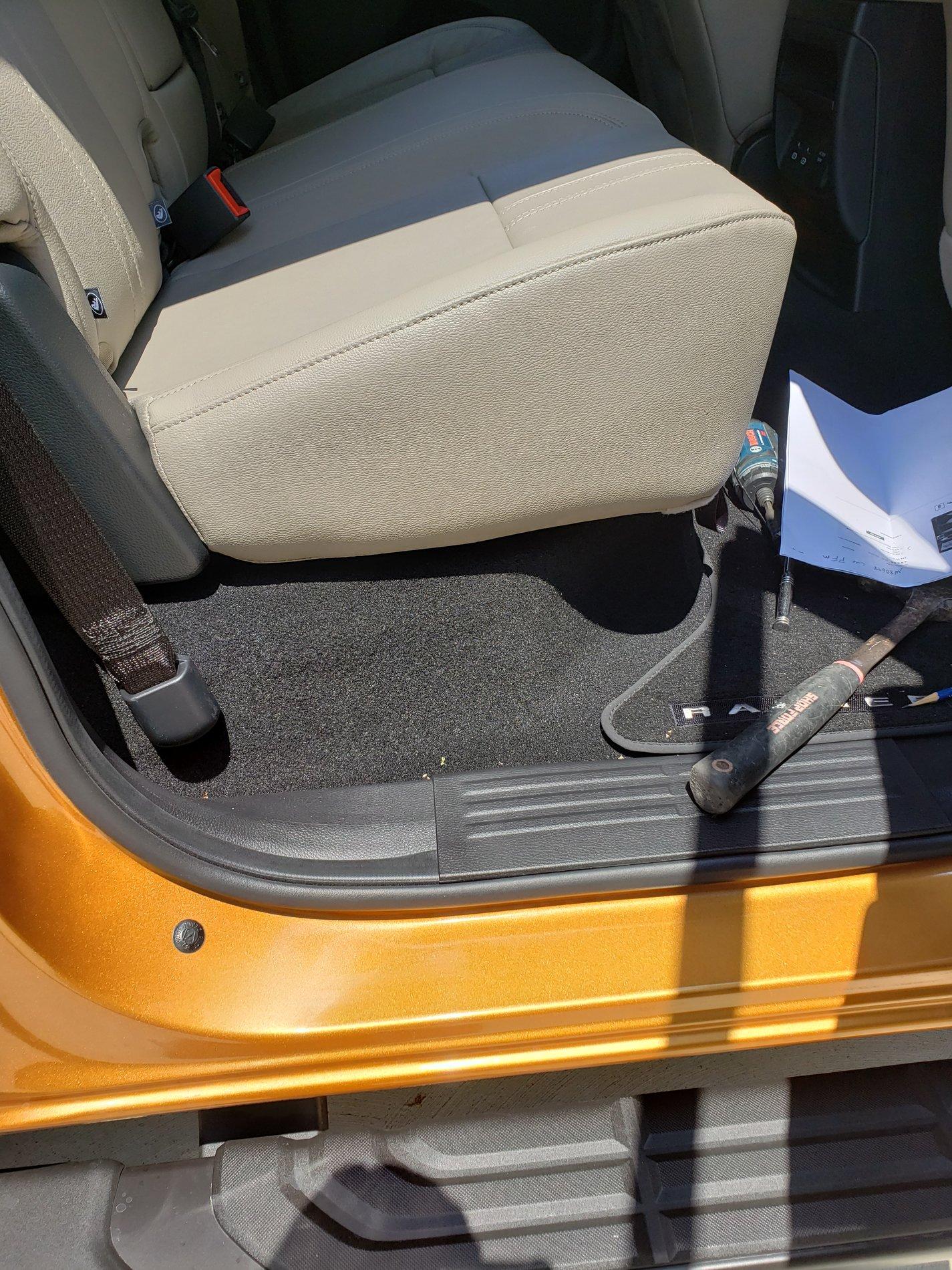

Remove the plastic molded tray that came with your truck, you don't need a trim removal tool just a short flat prybar, slip it under the plastic lip of the tray NOT the nylon push in fastener, this avoids damaging the tray. Lift the rear out first and tilt it towards the front seat and lift out.
After reading your instructions be sure to set your new combination before you install it, it's alot easier to see and do.

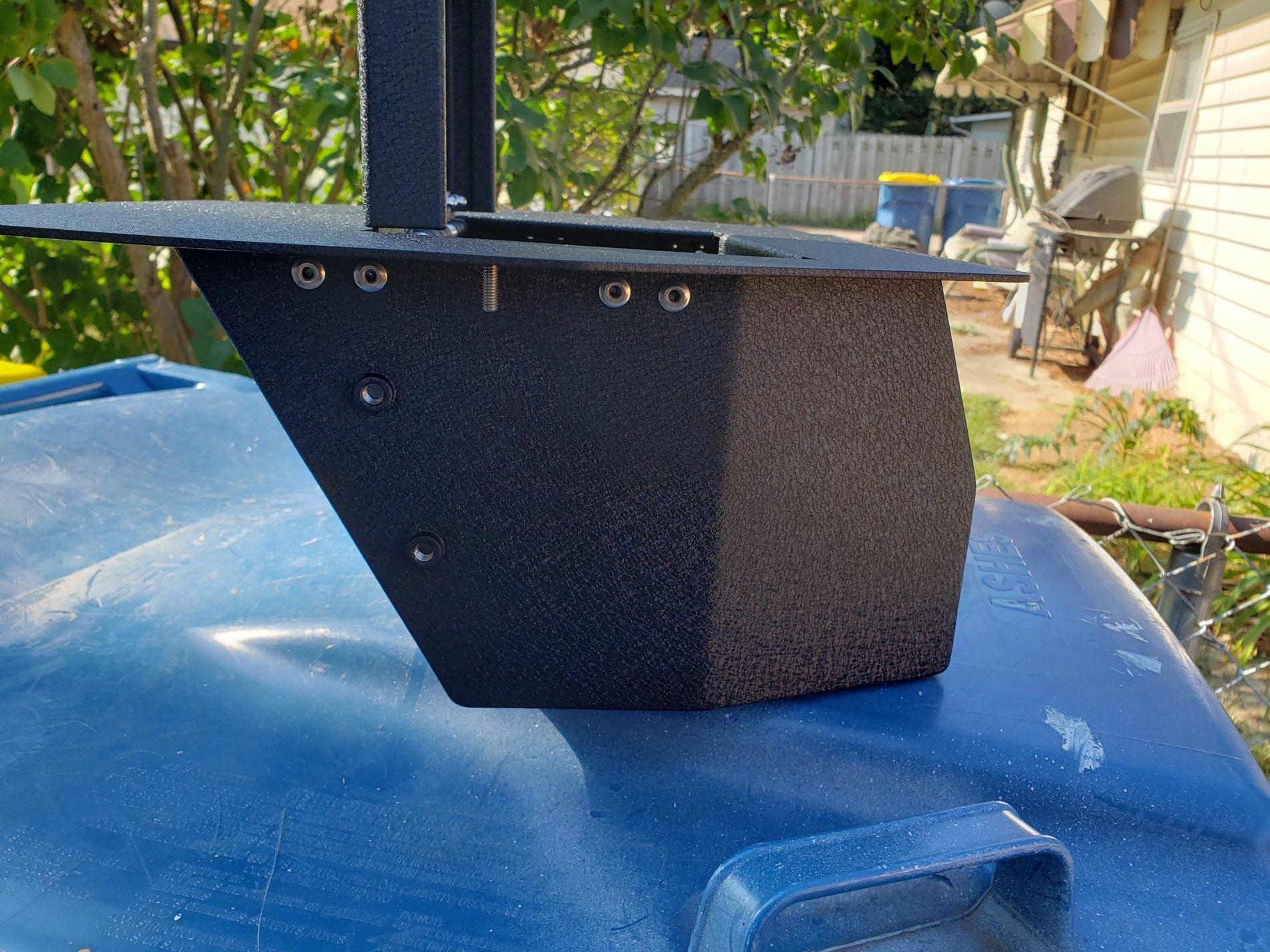

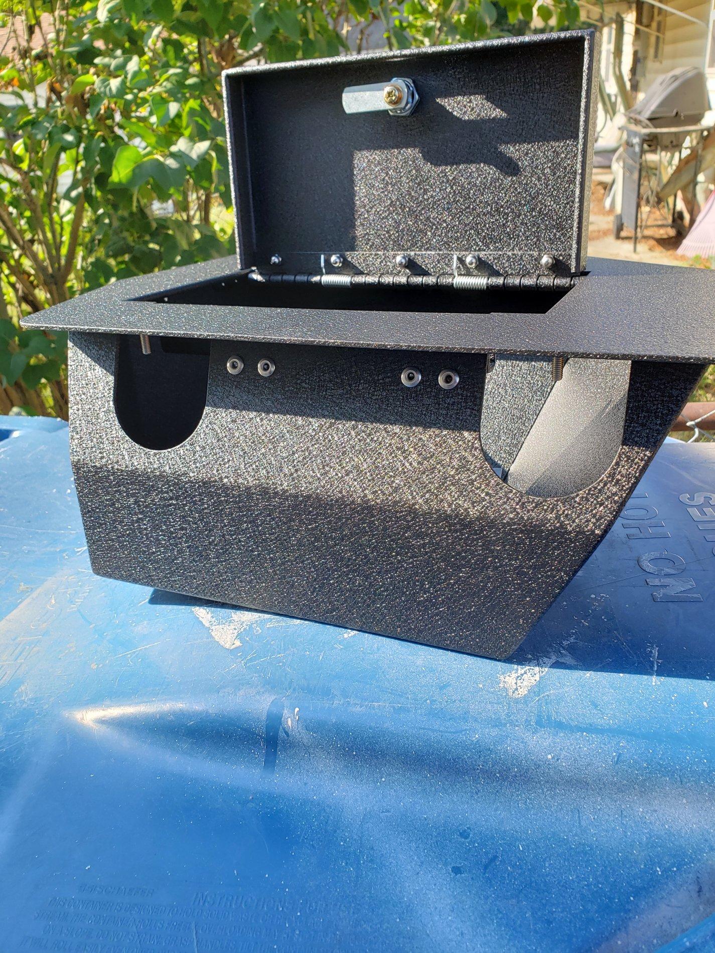

There are 4 attachment points. 2 threaded bolts on the bottom of the top each welded on and on the outer side towards the truck door you have 2 holes. Here was my only issue. Whoever assembled my safe messed up and welded threaded steel inserts over each hole on the outside. The bolts that came with the safe are large diameter self tapping bolts that are too big to install in these holes. You'd break the bolt off in the thread trying to force them through, I called the manufacturer but they aren't open on a weekend. I left a detailed message. My simple work around was this- put the safe in the compartment front first then the rear, find a marking instrument like a narrow punch or even a framing nail and insert it through the holes and mark the thin sheet metal behind the safe wall.
Lift the safe back out
Take a 7/64" drill bit predrill 2 holes I marked, put the safe back in front first then lower the rear. Use 2 smaller diameter self tapping screws I had on hand that are just a little shorter and smaller diameter than the ones provided with the safe.
Install and hand tighten the 2 nuts placing them on the 2 welded on bolts under the lid. Then used my cordless driver and installed the 2 self. Taping screws into the side then used a 1/4 inch drive deep well socket and snugged the 2 nuts down on the top. Don't overtighten any of the 4 attachment points or you will snap a bolt.

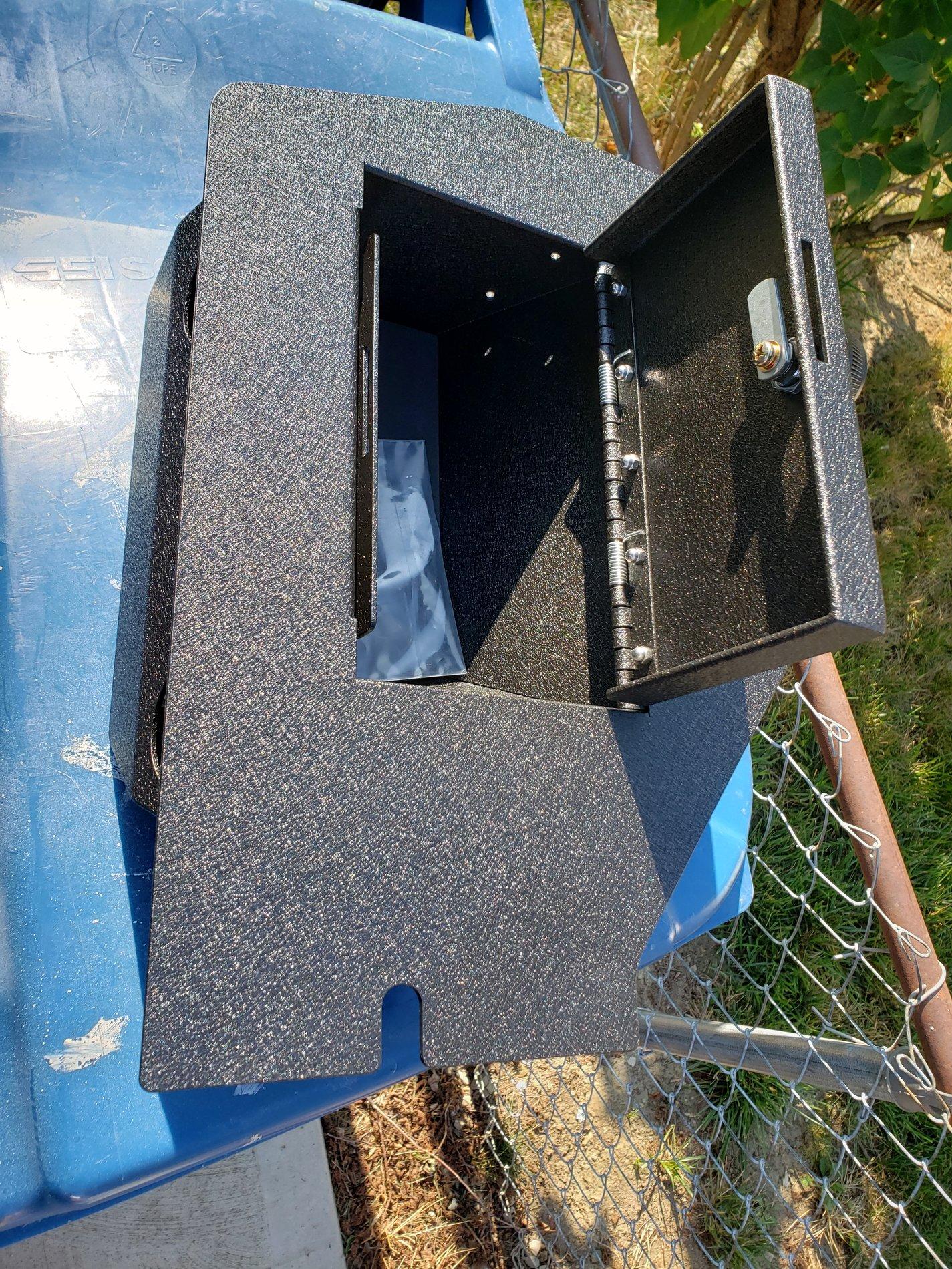

This safe is heavy and sturdy. Seams are welded and the entire safe is black powder coated. The metal on the safe carcass looks to be about 3/16 of an inch thick, there's a heavy spring that opens the door easily and holds it open, the lid is sturdy but may be one thickness thinner its hard to tell since the coating on it looks thinner than the walls.

Nice write-up. The picture may be deceptive, but it looks like the space under the seat is significantly larger than the stock plastic tray allows for.

Correct on the space, but with it being weird angles, my guess is that the designer settled on a square inch of space that was cost effective for Ford and a hope that owners would be happy. It serves its purpose but it sure would be nice to either have a flat floor like the F150 or have a bigger compartment on the driver side, the hole in front of the jack wrench is now filled up with rolled up ratchet straps
