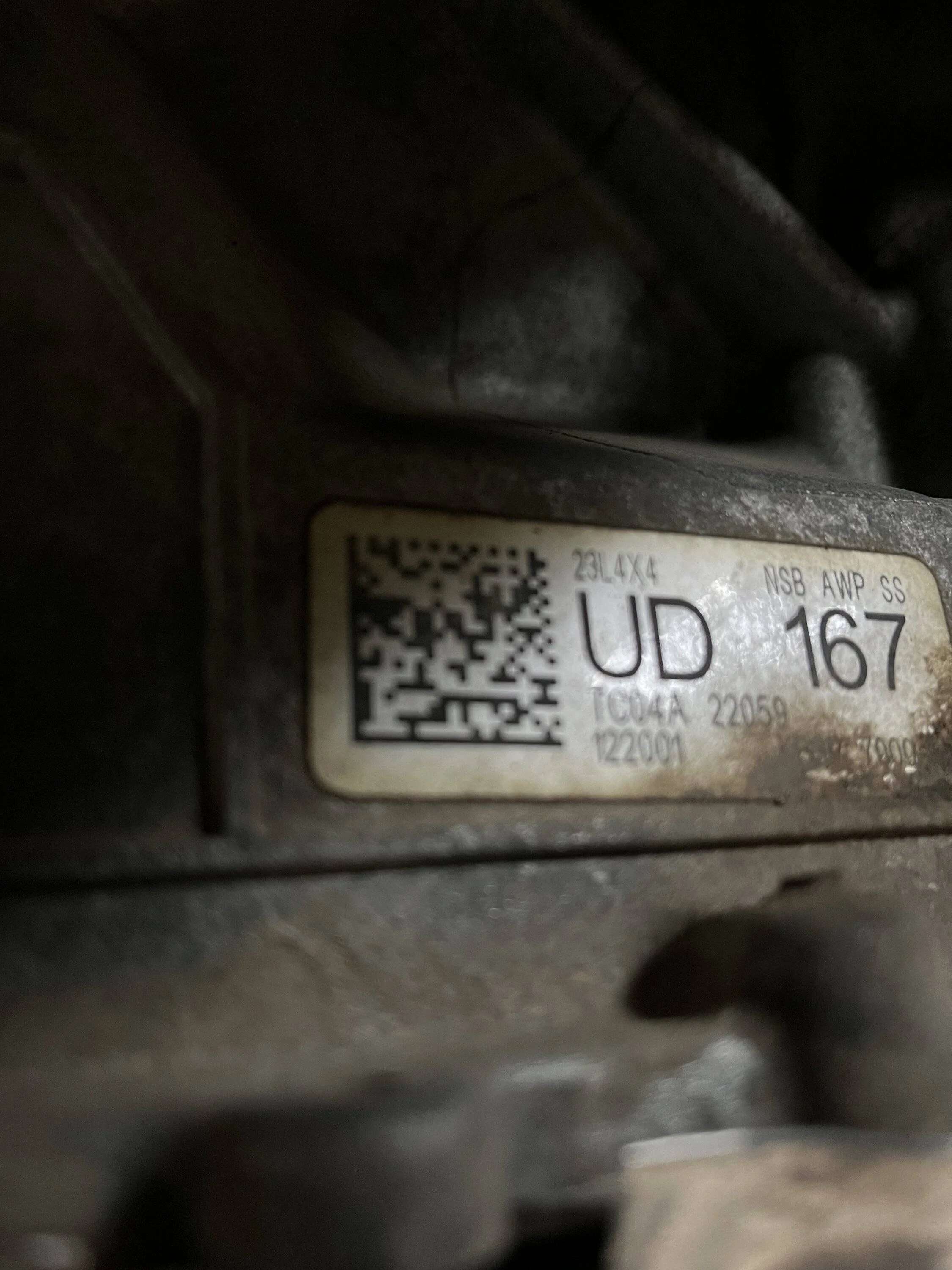

FWIW my 03/22 build XLT Tremor has the KB3Z-7000-B transmission. Number is on the lower left portion of the tag on the passenger side of the transmission. It’s dirty but if you zoom in you can pick out the KB3Z. I have to imagine that the replacement transmission’s that are being installed are Ford remans ( with updates ) and are carrying the KB3Z part number still. Would be interesting to see if yours is tagged with the NB3Z number

My tag actually shows a different number. NB3P-7000-FA
I cannot find any info on that number, so I called the Parts Dept and they dug deeper into that number and found that is an engineering number, and it crosses over to the NB3Z-7000-B.
The only info they could find is that it is only installed on the MY22 year. No informational notes stating production times or VIN#'s it was installed on.
I cannot find any info on that number, so I called the Parts Dept and they dug deeper into that number and found that that is an engineering number, and it crosses over to the NB3Z-7000-B.
I would take that as a good sign
