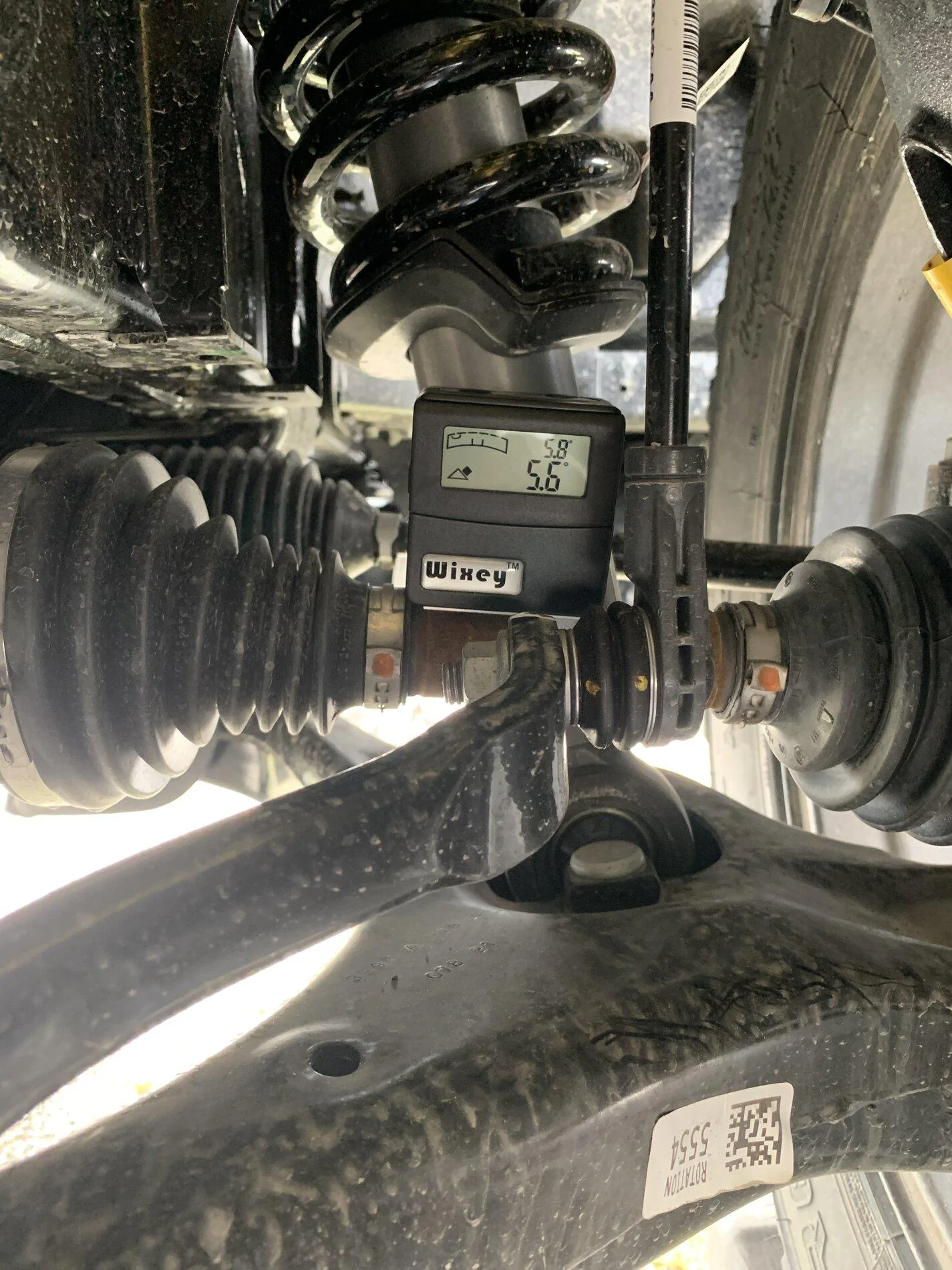

No sure how accurate this method is but here’s a pic..
Looks to be a lower angle than my CV acles with the OME lift. Chances are Ford simply put a leveling kit on a stock ranger and called it the Tremor Package to make things easy.

Thank you for the picture. Looks I was not far off by assuming 5deg :).
Indeed, Ford admits a little CV angle can do no harm, yet they played it safe, the boots are not rubbing. With a higher lift the boots are rubbing which will reduce their life for sure.
If Ford used the standard UCAs they have also limited the droop on the Tremor. In any case it's not much.

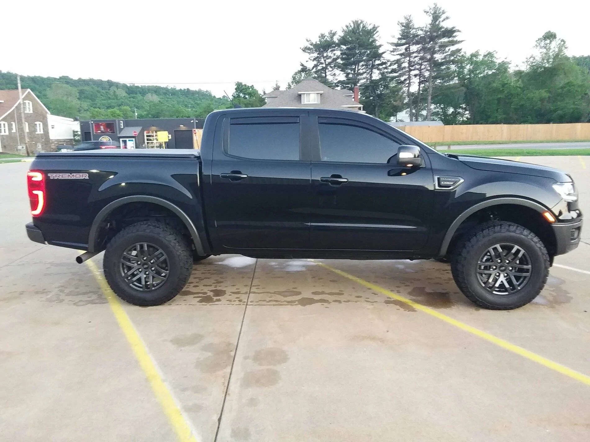

Oh were you the R&D truck? I knew I wanted to be in the 1" range but seeing it just made the decision much easier. I have a black Tremor too. Was going to go Traxda but I really like the craftmanship in the FRL version.
Any noticeable ride or driving changes since the lift? Been on any trails with it yet?
I live where roads can be pretty bad as well as some of the railroad track crossings. It used to feel like the front end always hit to hard , now it rides so much smoother its crazy. Love it so far .
