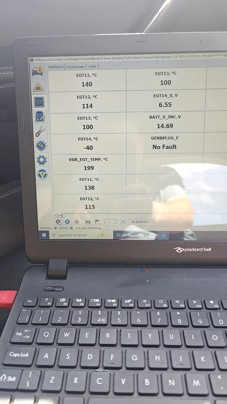

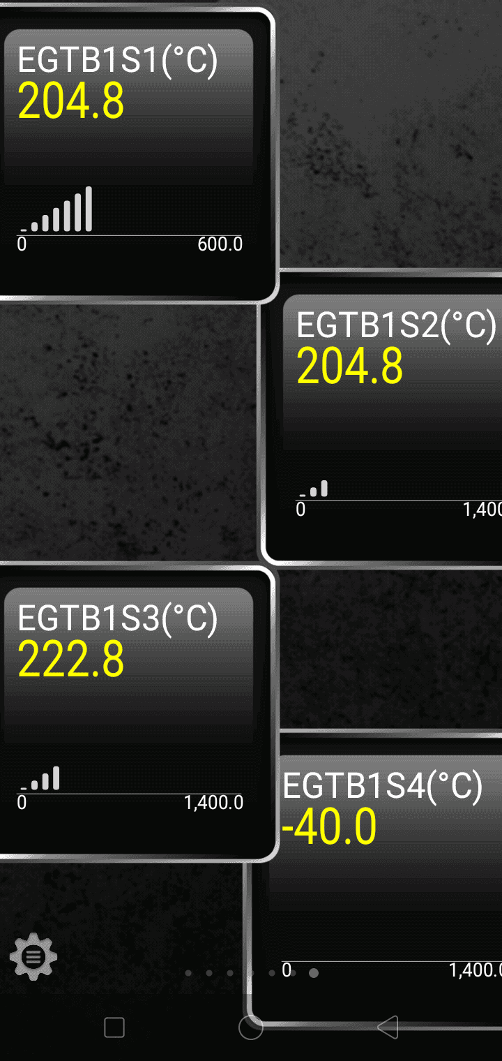

Hey all
I've got an issue on a 2017 DPF XLS ranger aus spec where my (bank 1 sensor 4) reads -40 degrees permanently I have changed the exhaust manifold sensor which I believe is sensor 4 with no difference. I have check the 5v supply to the sensor which is all good. When I unplug each of the other exhaust senors they drop off with OBD2 reader. Any help any advice you could give me would be awesome cheers in advance
