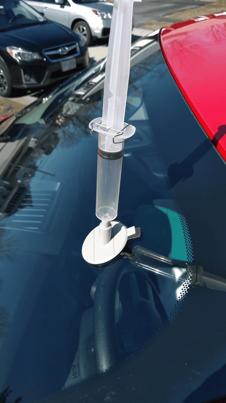

Safelite did my wife’s windshield for a chip and did an awful job. They didn’t pull a vacuum before adding resin so it didn’t fill fully and looks terrible (also probably not reliably fixed). Ended up contesting, then charging back. Worst part is that the crack is sealed so the air in the center cannot be fixed.
I did my own truck and unless my car and windshield is spotless (rare) it is impossible to detect. Even after a wash you have to look quite hard for it.

I had not fixed a chip myself before doing it on the truck but after the shit job they did on my wife’s car I figured I couldn’t do worse. Shop that filled her chip was a first party operation. As far as I know the geniuses that did my windshield a decade ago are out of business.

You could likely use the permetax kit. I’d expect you wouldn’t pull a vacuum (could try, but area likely larger than repair area), but do the second step of the process which is filling the top of the crack with resin, then using a razor to scrape excess to a flat surface.

I’d expect you could do the second part still. You put some on the surface, little patch to hold in place. Let it cure, peel patch, use a razor to trim/smooth.
