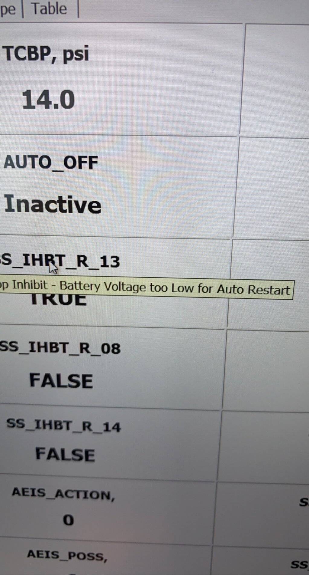

While I really dislike this feature in many ways. I also dislike when things that should function, don’t function.
Truck has been parked for a while. Drove it 200 miles the other day, and then 60 miles the next day. Auto start didn’t do anything both drives.
on the dash, it says ‘Engine On Normal Opr.’ But all I see is the grey A with the circle around it.
plugged in Forscan and this is what I have.
is it as simple as a battery replacement? Relatively annoying.

The battery is low and needs to be recharged. When charging, connect the negative wire to a chassis ground, not the negative battery terminal. Otherwise the BMS will not detect the charge and the BCM will continue to prevent the auto start stop feature from operating. See video:
https://youtube.com/shorts/cJkTtvjzunI?feature=share
So I could try charging it with a charger. Interesting. You’d think that the alt would charge it just fine on my trips.

The Ranger has a variable alternator and just because the engine is running doesn’t mean that the battery is charging. The BCM and PCM control when the alternator sends charging voltage to the battery. The battery is rarely kept at a 100% charge.

I guess what I’m saying is, is that the smart charging feature is incapable of bringing my battery back to where it should be at for S/S to function. And that it might be possible to rejuvenate it enough with a battery charger for it to function?
basically. The smart charging system knows the battery needs charged - shouldn’t it charge it to the required level?
It should, but it seems it gets out of sync every now and then. I travel on planes a lot. After a couple of months of 4-5 days parked at the airport each week, I need to charge it.
