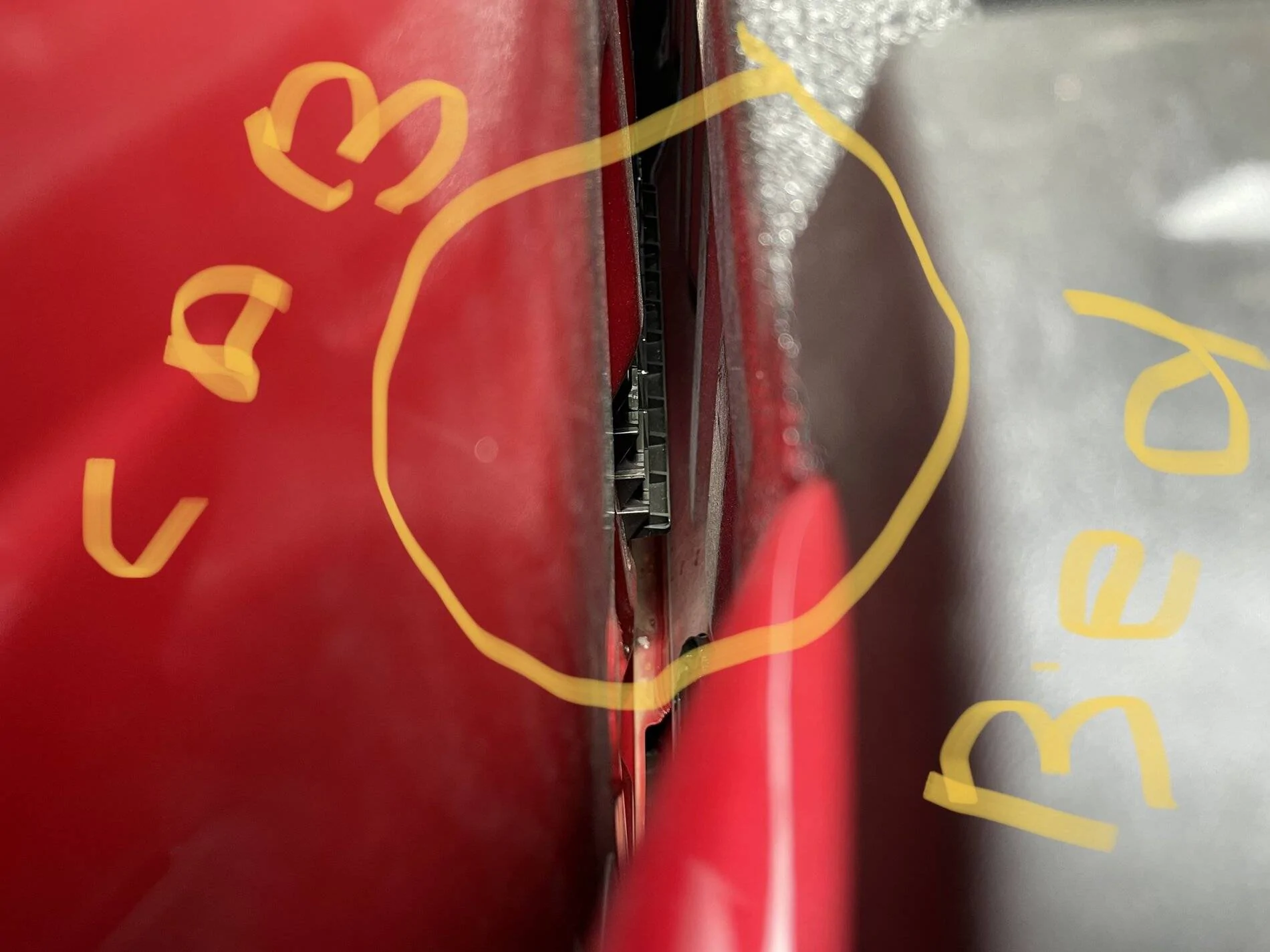

My 2021 Ranger leaking water into cab. According to dealer nothing found. They are bringing in a “special” tech to look at it next week. I looked much more closely as it is supposed to rain heavily this afternoon into tomorrow where I live. I discovered the passenger side rear cab bent is installed backwards and is missing a piece of foam that is supposed to cover it also. It had active water on the vent flaps. Just FYI for anyone having this issue. It’s not an AC issue in my case.

If you look down between the bed and cab you will see a tiny shelf near the vent location, IF you see the shelf, then it appears the vent is in backwards. The shelf acts as a catch and moves water through the vent to the interior. The passenger side is flush and you can’t really see the vent at all.
