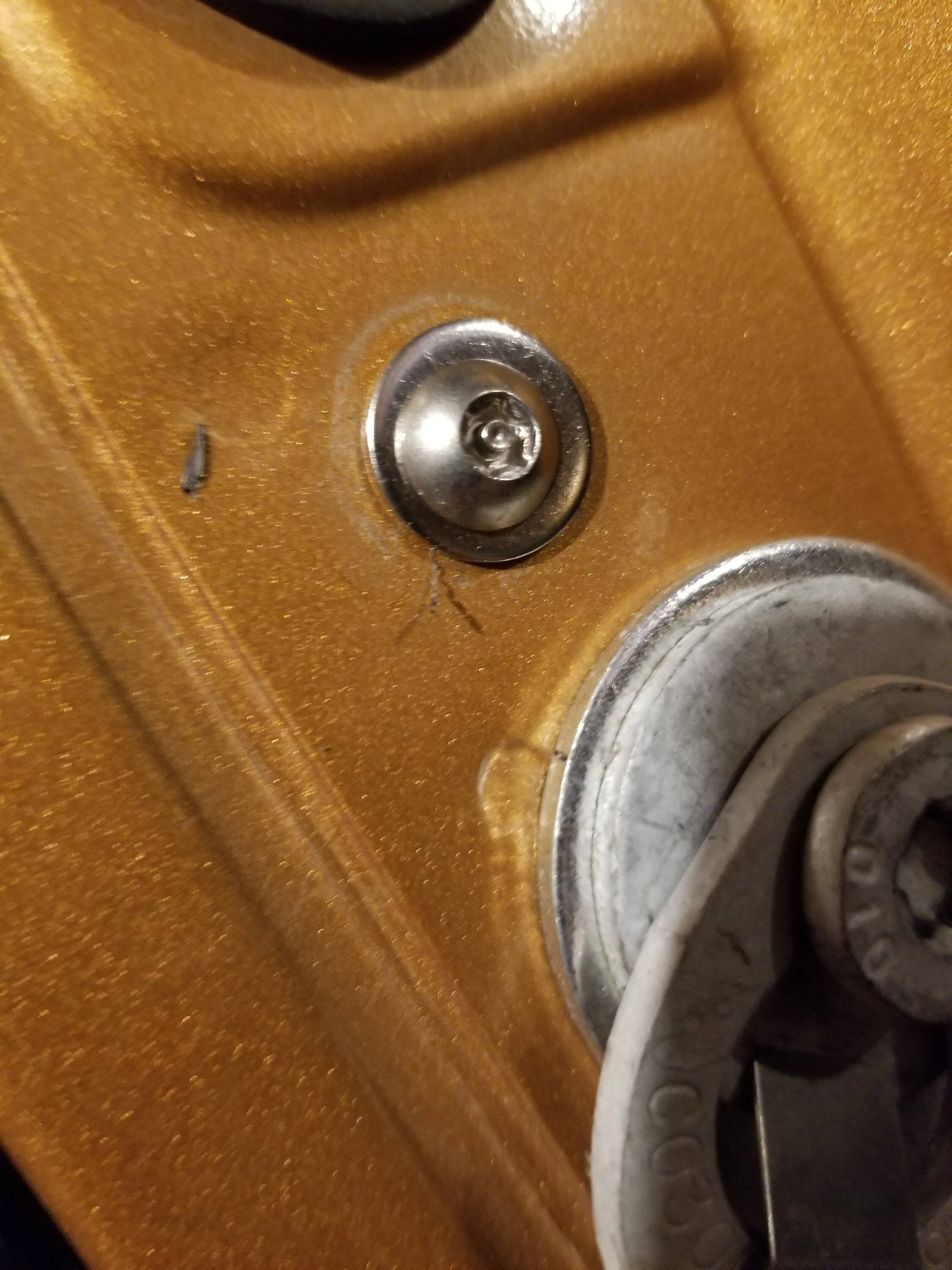

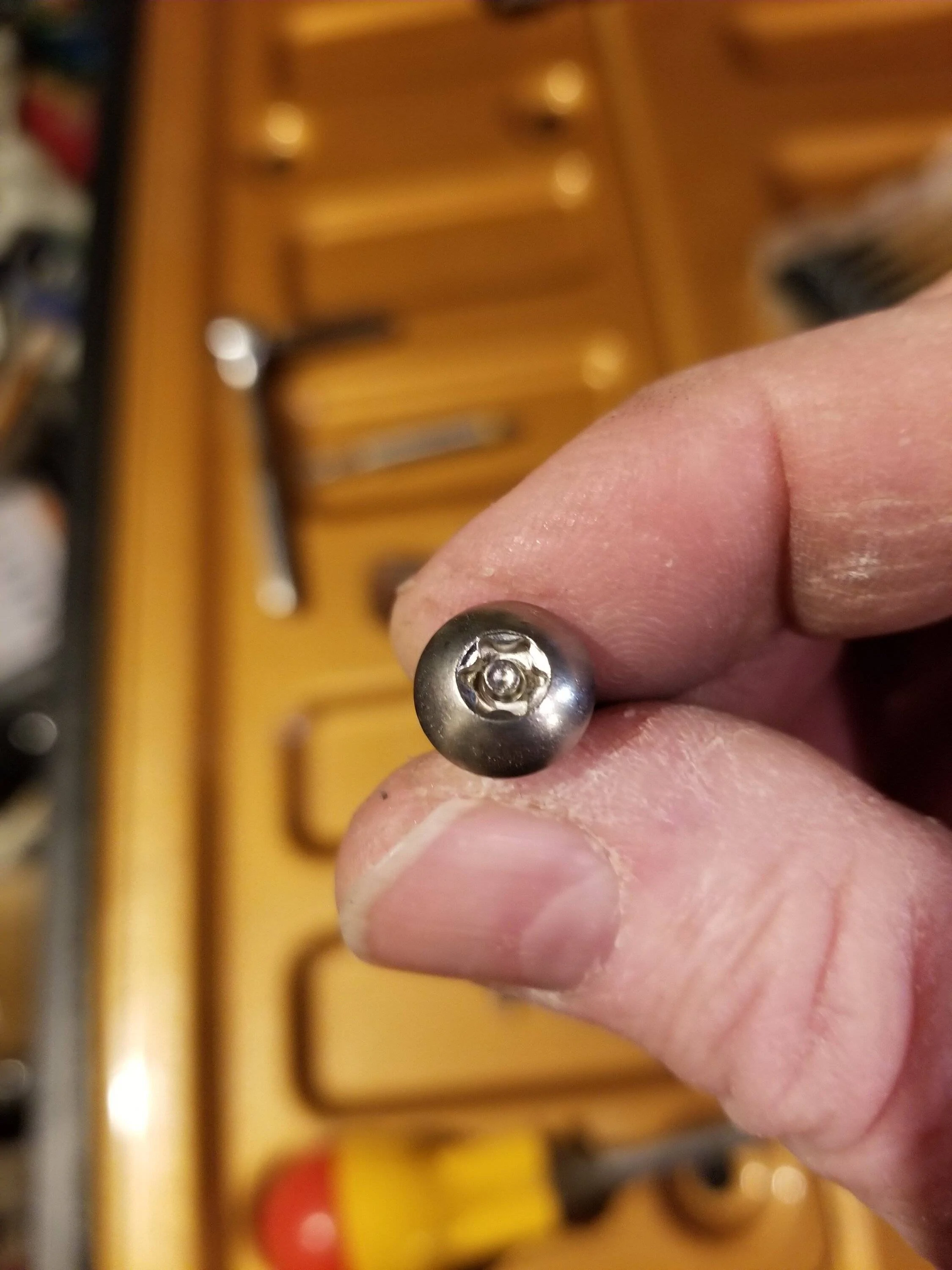

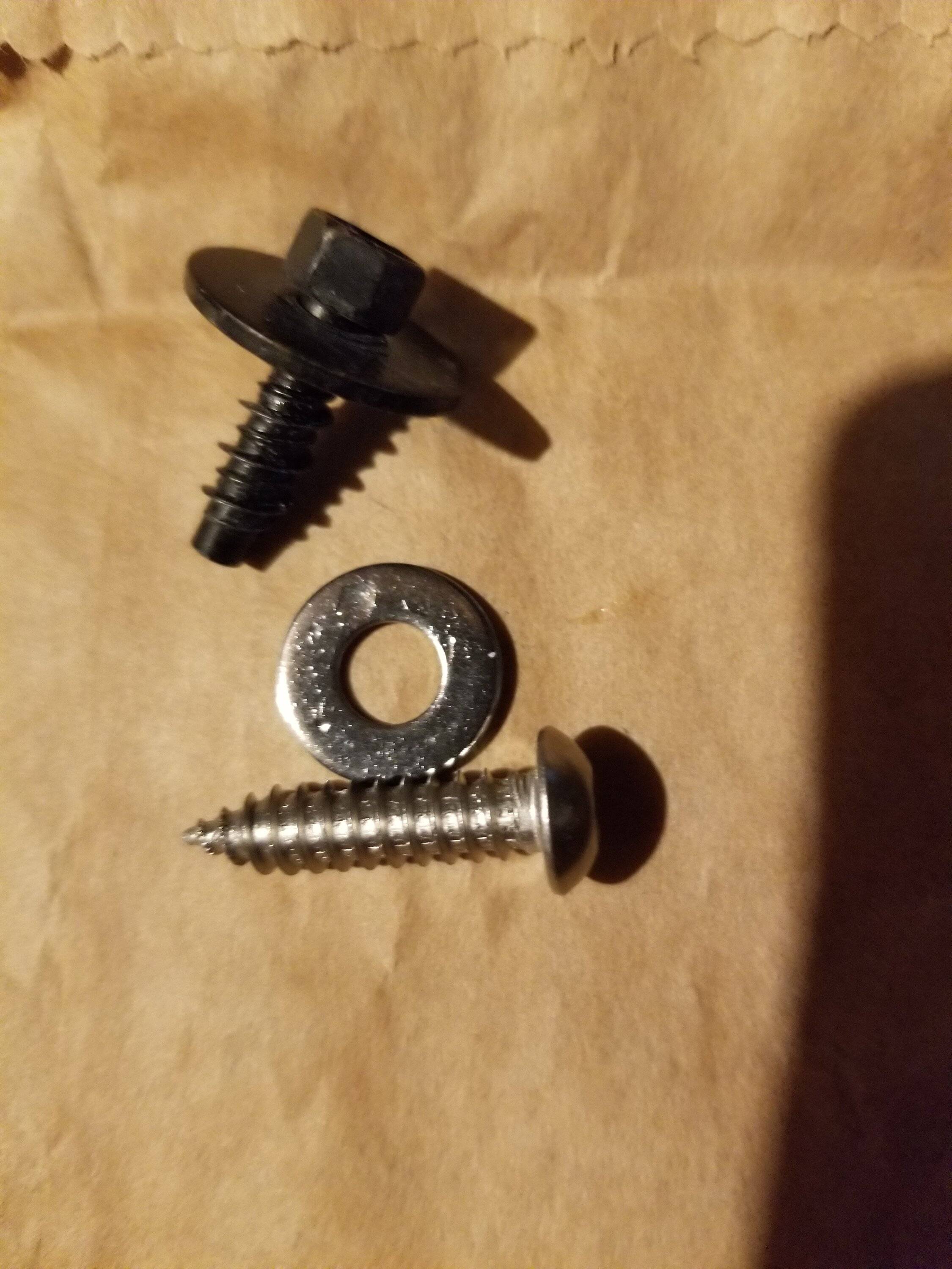

Similar to others, I found 3/4 by 14 stainless steel screws with security torx heads. Fit very tight so I opened the holes slightly with a 13/64 bit. Will likely fill the heads with epoxy or similar. Next I am working to connect the alarm sensor from the hood to also monitor the tailgate. More to come on that.
Since mine is garaged I am more concerned about quick theft when parked publicly, so may secure the tailgate from removal and deactivate the lock once alarm is connected to gate. Would prefer to have alarm surprise them than have the gate damaged.

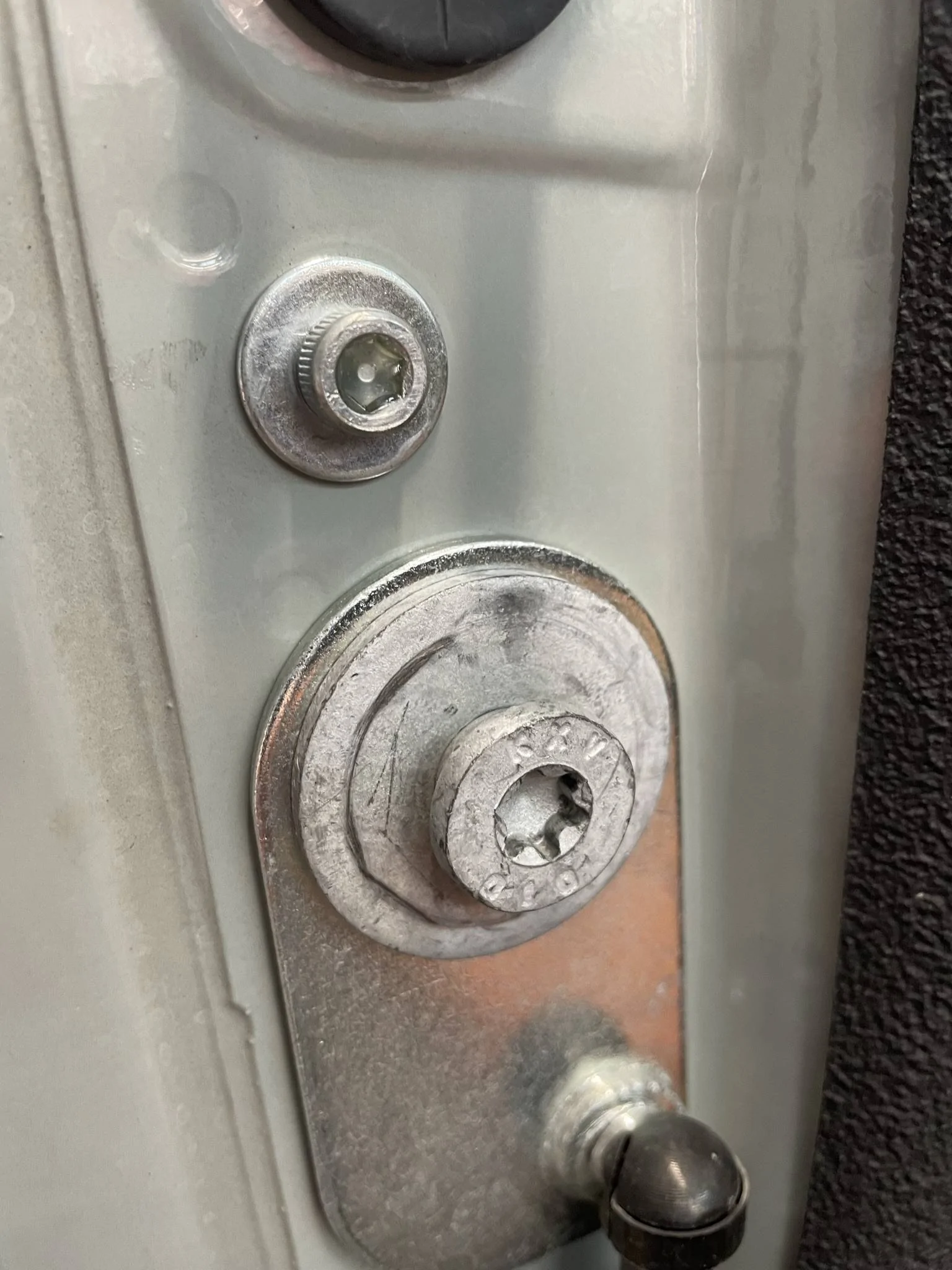

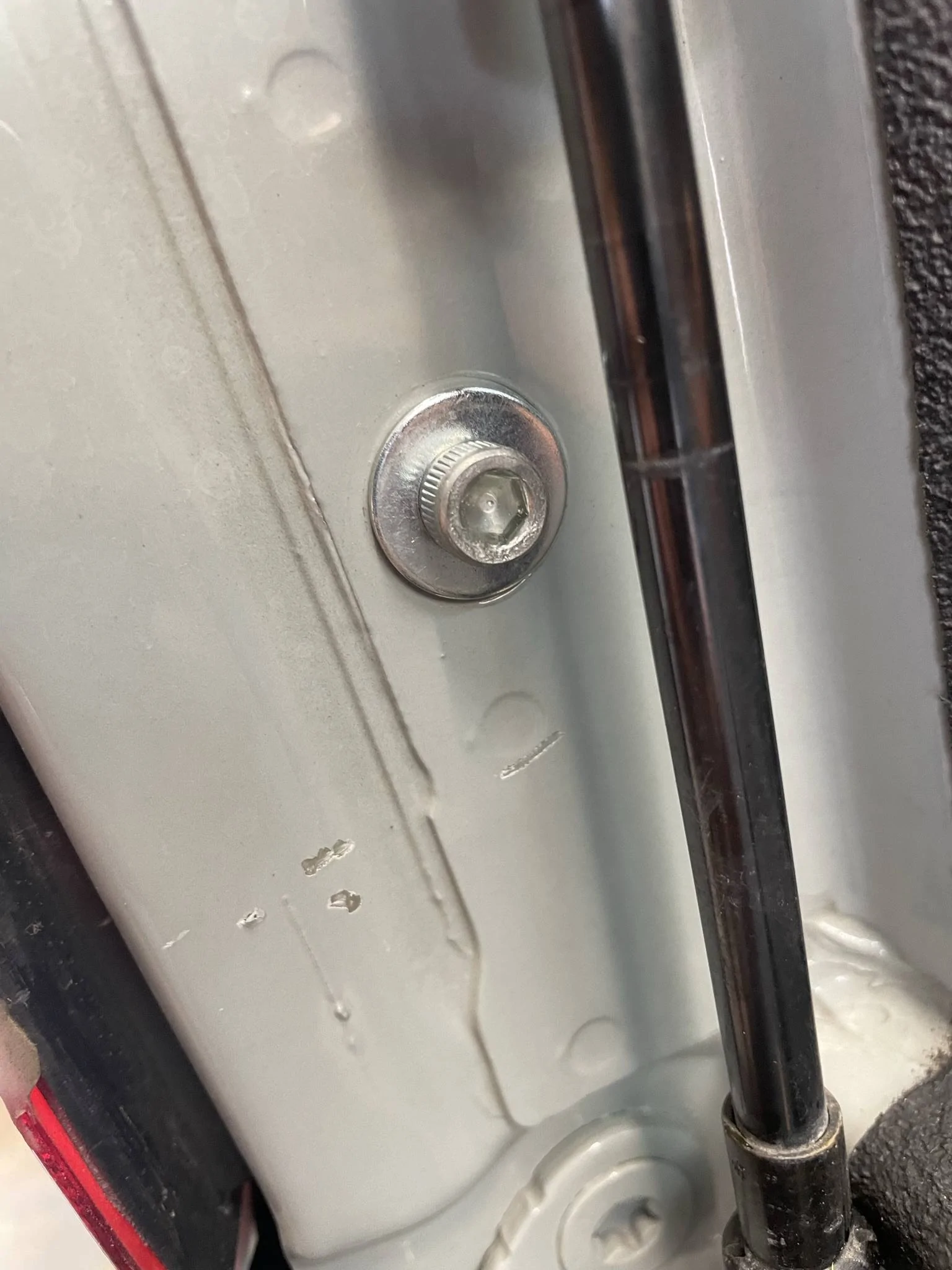

I swapped the screws with Allen head bolts, then filled them with a clear glue that's damn near impossible to remove, but I still worry they will just smash them if they cant get them.
