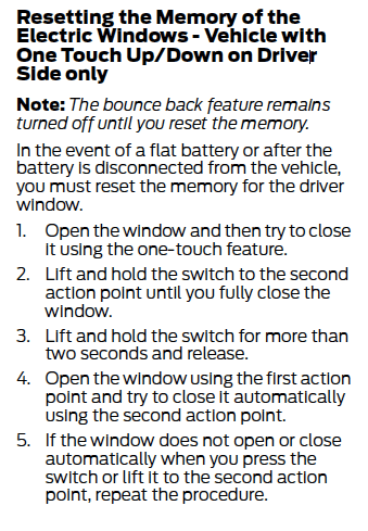

3. One touch auto down switch for the window failed. Only manual mode where I have to hold it

Funny you mention the auto window switch failing. My truck has done that twice but only right after I was welding on it. I had the batteries disconnected during welding. Then after a few days driving the auto roll up would just start working no problem. Might have something to do with disconnecting the battery

The battery was disconnected Thursday night, so it’s been a few days and I’ve driven it daily since then, so hopefully they either fix it, or it just starts working again while I am waiting for parts to come in.

The auto up down needs to be relearned when you disconnect the battery. I remember seeing the process in the manual.

Thanks guys. The dealer fixed the switch, my tail lights were inspected and are ok. The modem for FordPass, was bad and they ordered a replacement. The did have to re-index the steering whee. they will look at the door and window seals again when I bring it back for the modem replacement, they did say it does have excessive wind noise. So they did a great job for me and I’m happy. They said the steering wheels was off almost 12 degrees. Thanks again for the help on the window switch.
