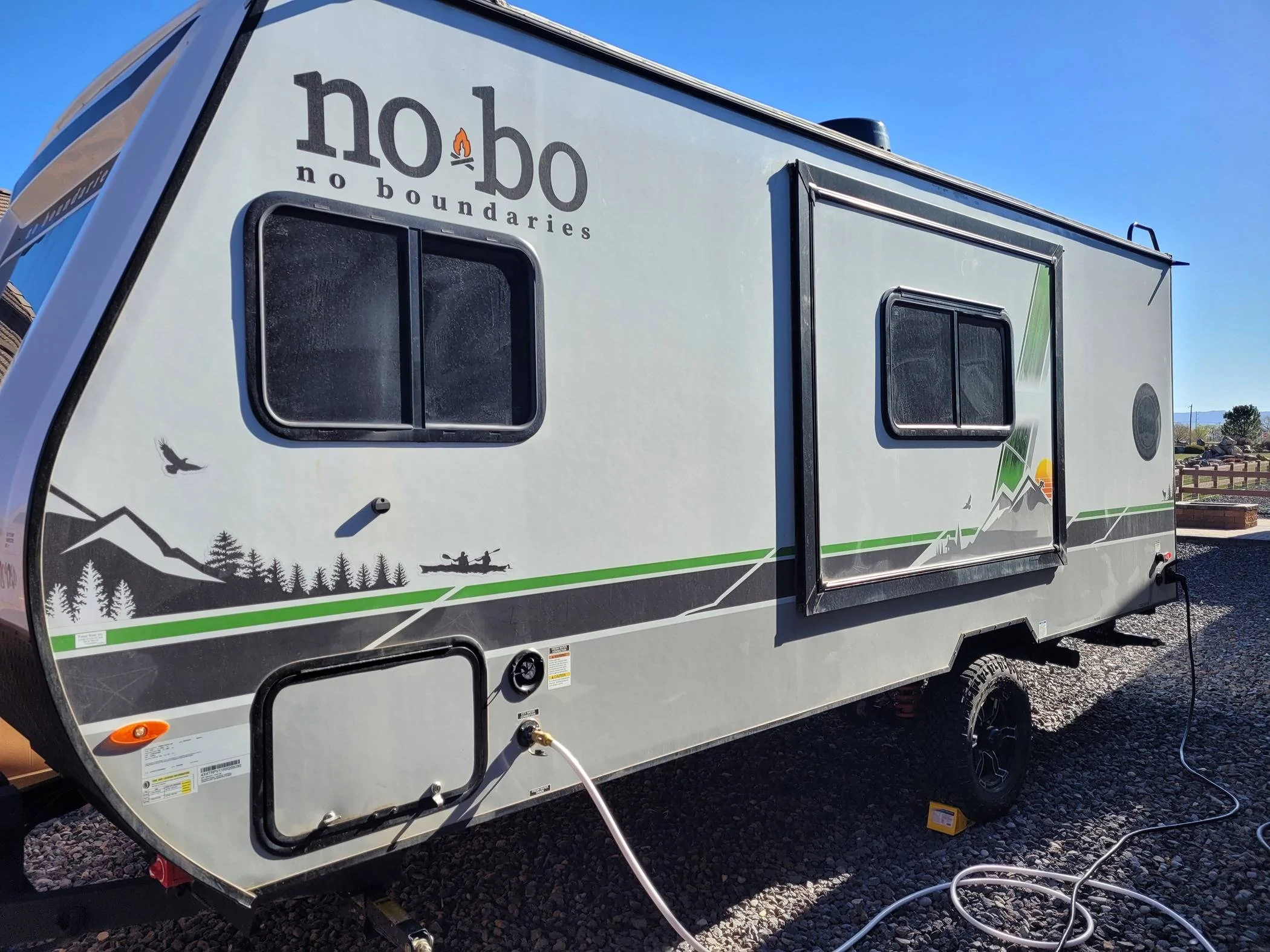

Grumpaw - pic of my trailer, UVW is 4162 , I think tongue weight is 450 , after 4 trips towing with the Ranger I'm not thrilled with how it tows and eats gas, but I've never towed anything over 2,500 lbs in the past. One thing that happens is the up and down motion transmitted to the Ranger when going over undulating pavement - IIRC you mention installing some air suspension components on the Ranger - what are they are what was the cost, I assume these would help with the up and down rocking.
the other thing I'm looking into is what a neighbor of mine did recently, he tows a 6k travel trailer and recently picked up a yukon denali with the 6.2l V8 and says it tows great and gets 13 to 14 mpg, he replaced an older F150 .
Probably look at a used yukon if I go that route as wife needs a new car, I'd keep the Ranger as I,m happy with it with the exception of towing performance. I do have an E2 wdh but have towed with and without it and it doesn't make a big difference.
In a way a big change for me as prior to buying the NOBO I was even considering an EV to replace the wife's aging Hyundai Sante Fe, now contemplating buying a big gas guzzling V8, might also take a look at a Ford Expedition, I think they still make them.
On the NOBO users site there are a good number of users that say the NOBO tows nicely compared to other trailers they've owned.
what would be nice if I could retrofit the Ranger with Ford's backup trailer SW, I have to park the NOBO in a narrow spot and I'm not great at doing that and the wife is pretty lame when it comes to helping out.
