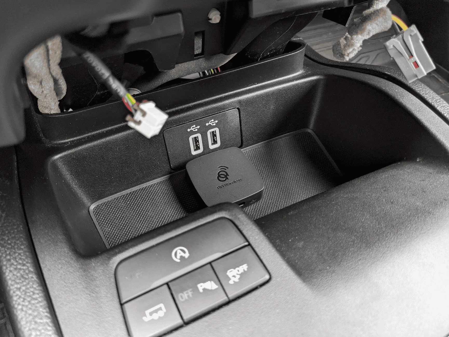

I hadn't even thought about that...just assumed if the carplay module fits then this one should too. I'm betting @DirkM would be so kind as to revise the design for AAWireless folks if necessary (which hopefully won't be needed).
I haven't measured but AA Wireless should fit under Dirk's tray no problem. Eyeballing it from this photo of mine I took a while ago, I think AA Wireless would only be about as high as the half way point of the built-in USB ports.

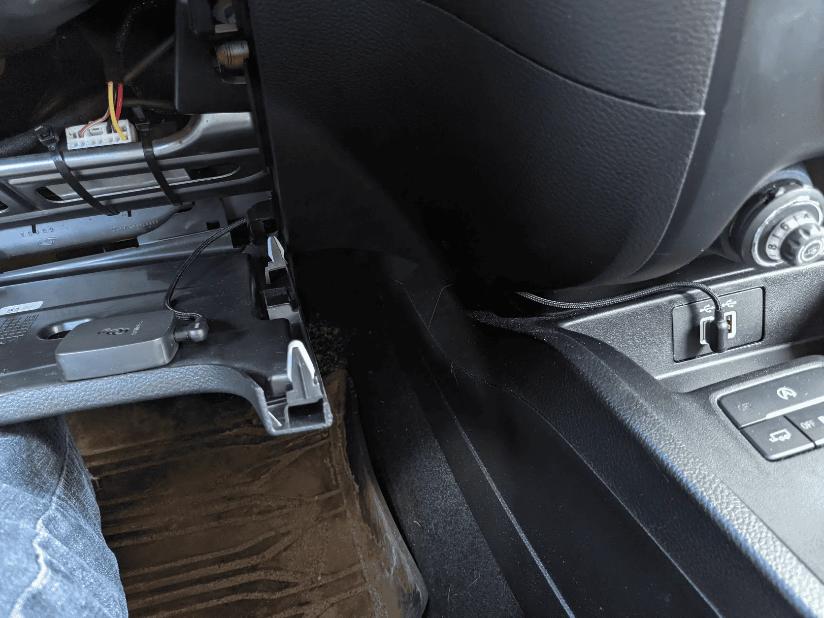

I had the trim apart in my truck yesterday while I was doing something else, and I decided to take a photo of AA Wireless sitting near the USB ports, so that anyone could get a better idea about its size and whether or not it'll fit under Dirk's 3D printer part. It's small:
It should fit without any problem.

That's good picture too (of the right 12V power socket plug) for those who want to hardwire a 12V to USB-A adapter for the wireless charging pad. Not sure if there is a difference between left and right but I hardwired mine into the left 12V socket and it turns on when the car is unlocked and off about 20 minutes or so after locking the car.

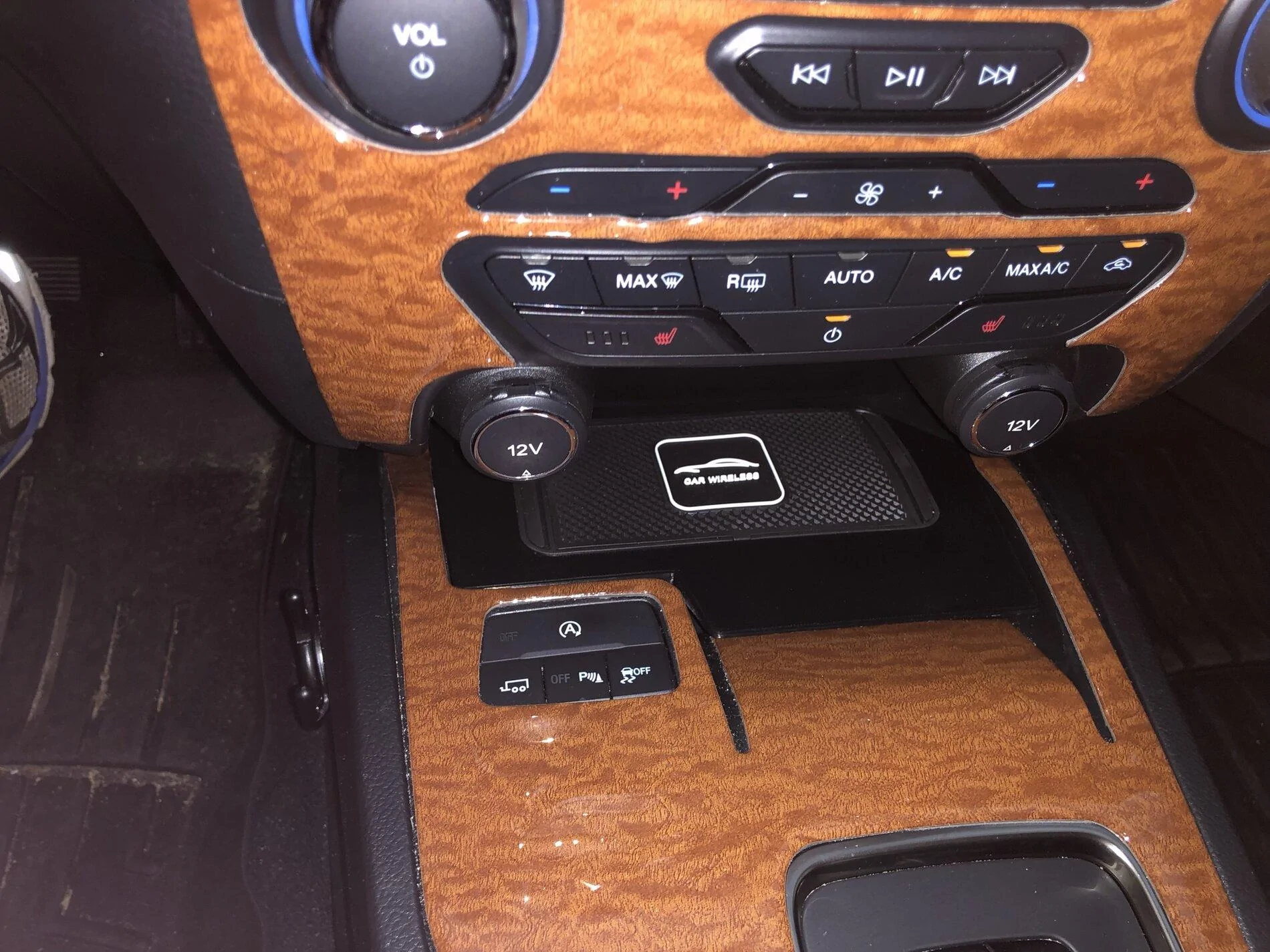

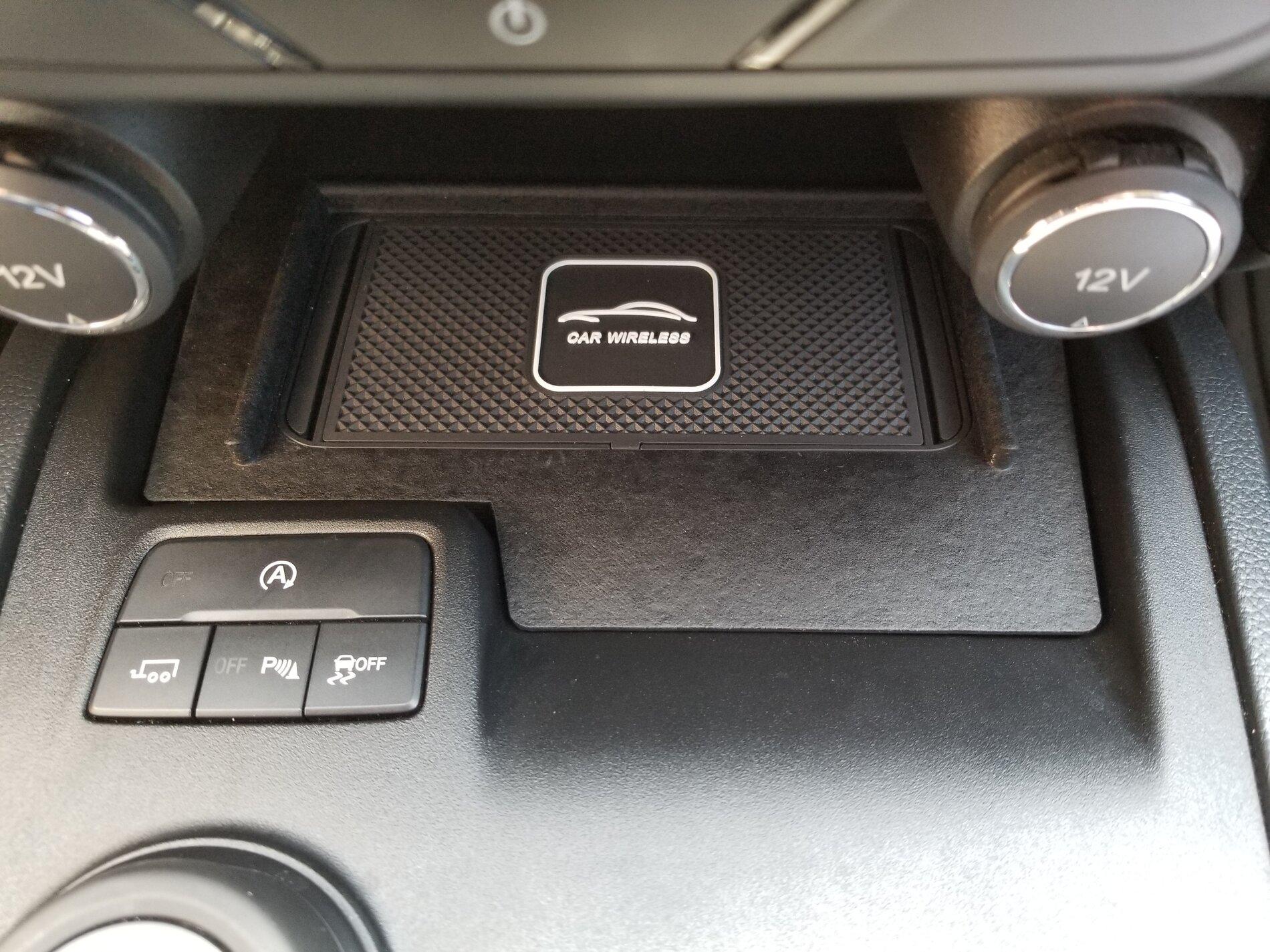

Got my rack and charger in today from @DirkM. Less than5 min install. Perfection!!!

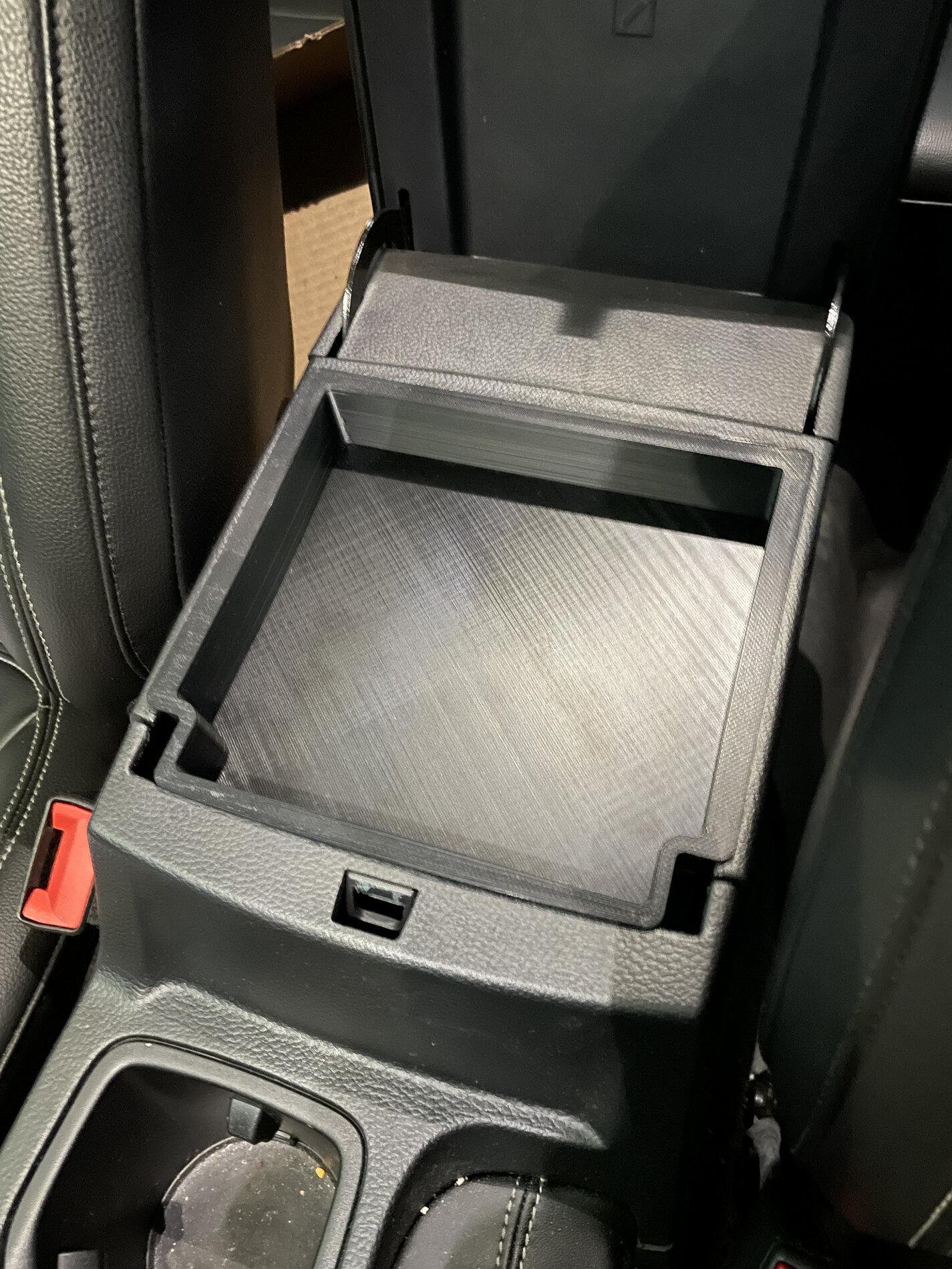

Another option to put your stuff somewhere would be tray below the center console, something like this, or maybe one that only covers half of it.
