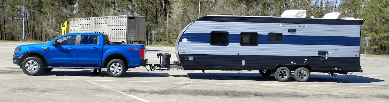

I wouldn't go any longer than what I already tow, although very slightly heavier wouldn't be a problem. @Grumpaw is about the same length as me, but heavier.
My opinion is that we are both at the max length for the truck.
26DJSE - 26' box 29' tip to tail
Nice setup! And you had the good taste to color coordinate!
