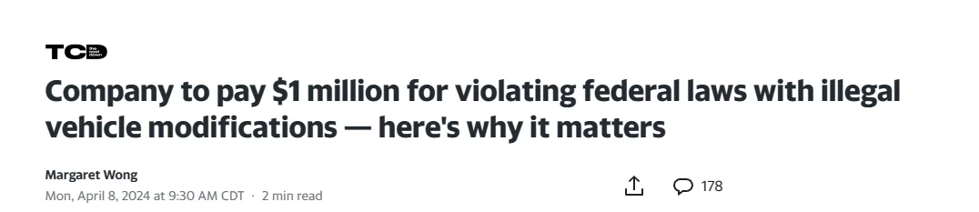

Yeah, then you see this in the news today:
Company to pay $1 million for violating federal laws with illegal vehicle modifications — here's why it matters (yahoo.com)

Not sure what that has to do with this tuning discussion, other than Lots of those shops not only sold hard parts for emissions defeat but also tuning that was smokey to go along with it. It was only a matter of time before they got smacked down.
Yeah they did that to slight the Gov and tried to hide as Offroad only but marketed with intent to public road use. The Gov should leave us alone. 70+ of emission pollution is Commercial and one a fraction of personal car owners mod. I rather just pay a tax to make them feel ok with stealing my money.
Ripping all the emissions off and tune could give better Mpg than you save with the components. But they can't get paid off that way.

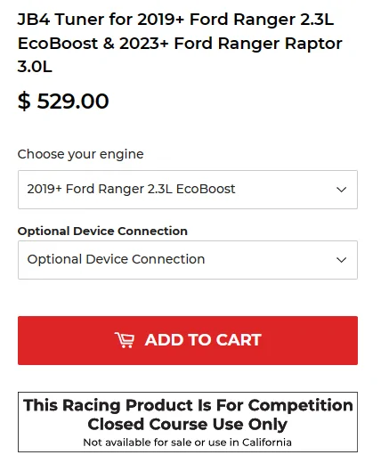

Yeah they did that to slight the Gov and tried to hide as Offroad only but marketed with intent to public road use. The Gov should leave us alone. 70+ of emission pollution is Commercial and one a fraction of person care owners mod. I rather just pay a tax to make them feel ok with stealing my money.
Ripping all the emission off and tune could give better Mpg than you save with the components. But they can get paid off that way.
Kind of like JB4 has their disclaimer, but you know some people will use it for everyday driving.
Just some?🤣
