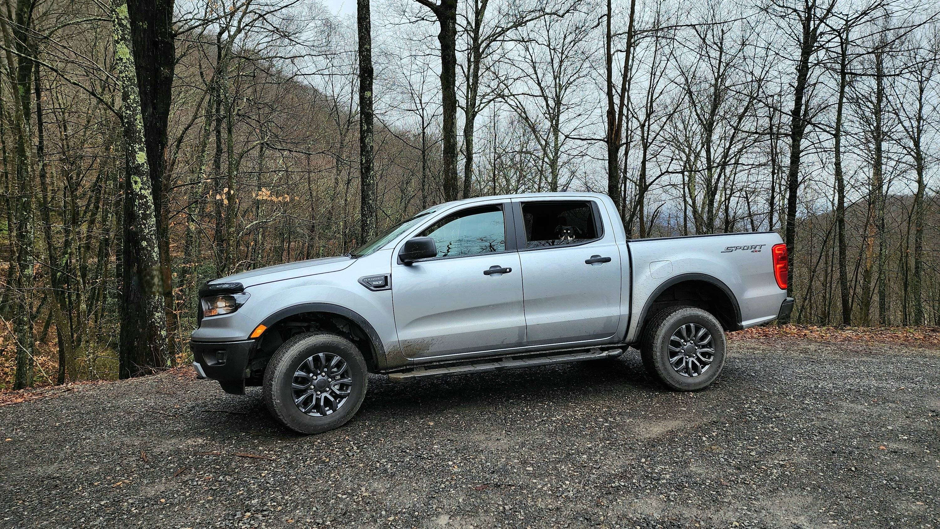

It 100% lifted the rear a bit. Here's a pic from about 2 wks ago. Only the rears have the Bilstein 5100's.

I contacted Fox about rear shocks. They wii work with up to a 1 1/2 in lift but without springs they will not lift the rear.
Exactly, shocks will dampen the rebound and compression but without springs they cannot raise a truck. If there is any minor lift due to more gas pressure that will slowly be mitigated and the vehicle will return to stock height.
