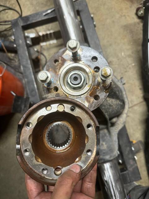

Decided I would try and keep an oem style look for wheels through the old ranger oem centers and popped out the bronco horse. Will paint black

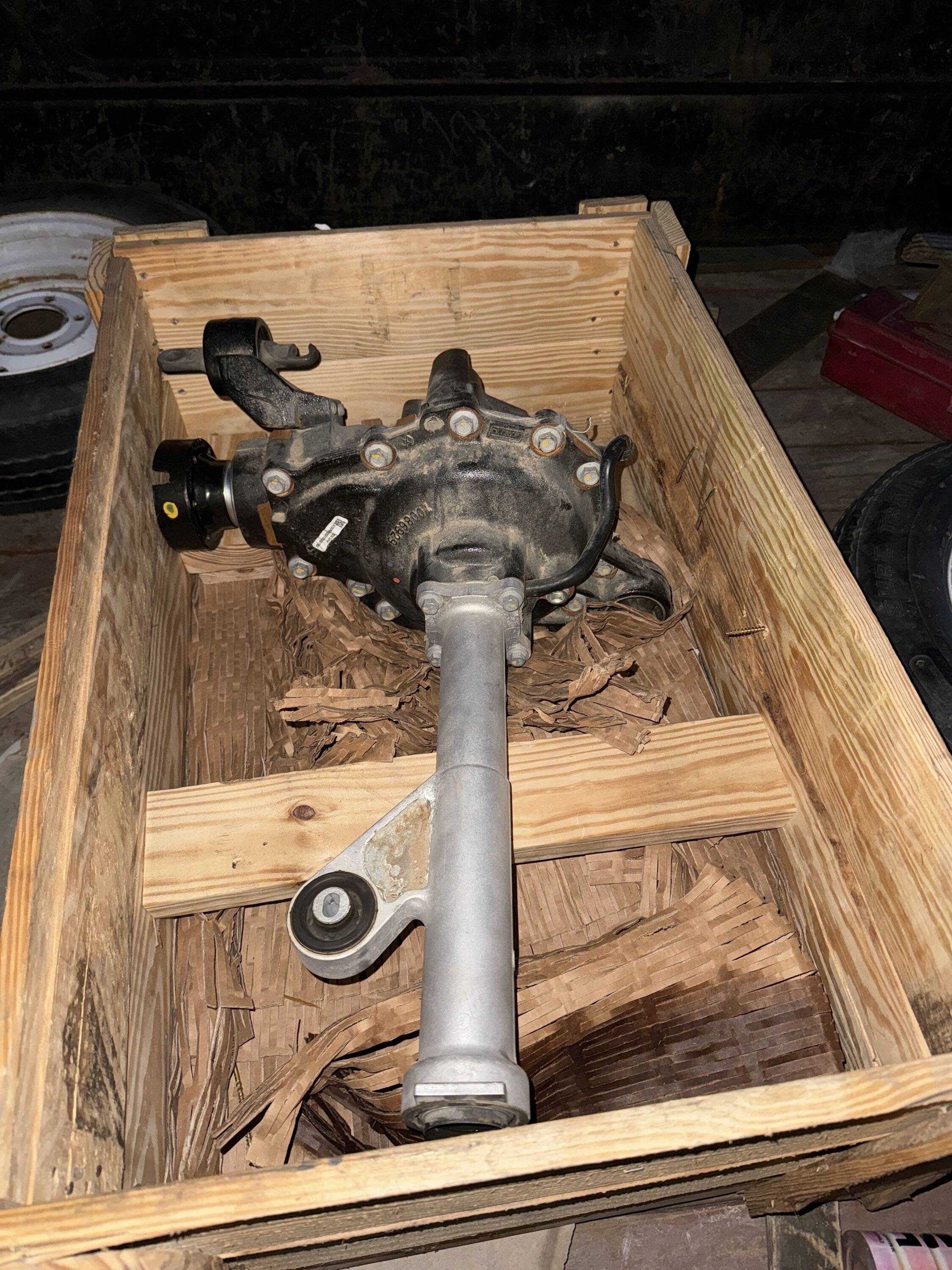

I got my bronco m220 and m210 today

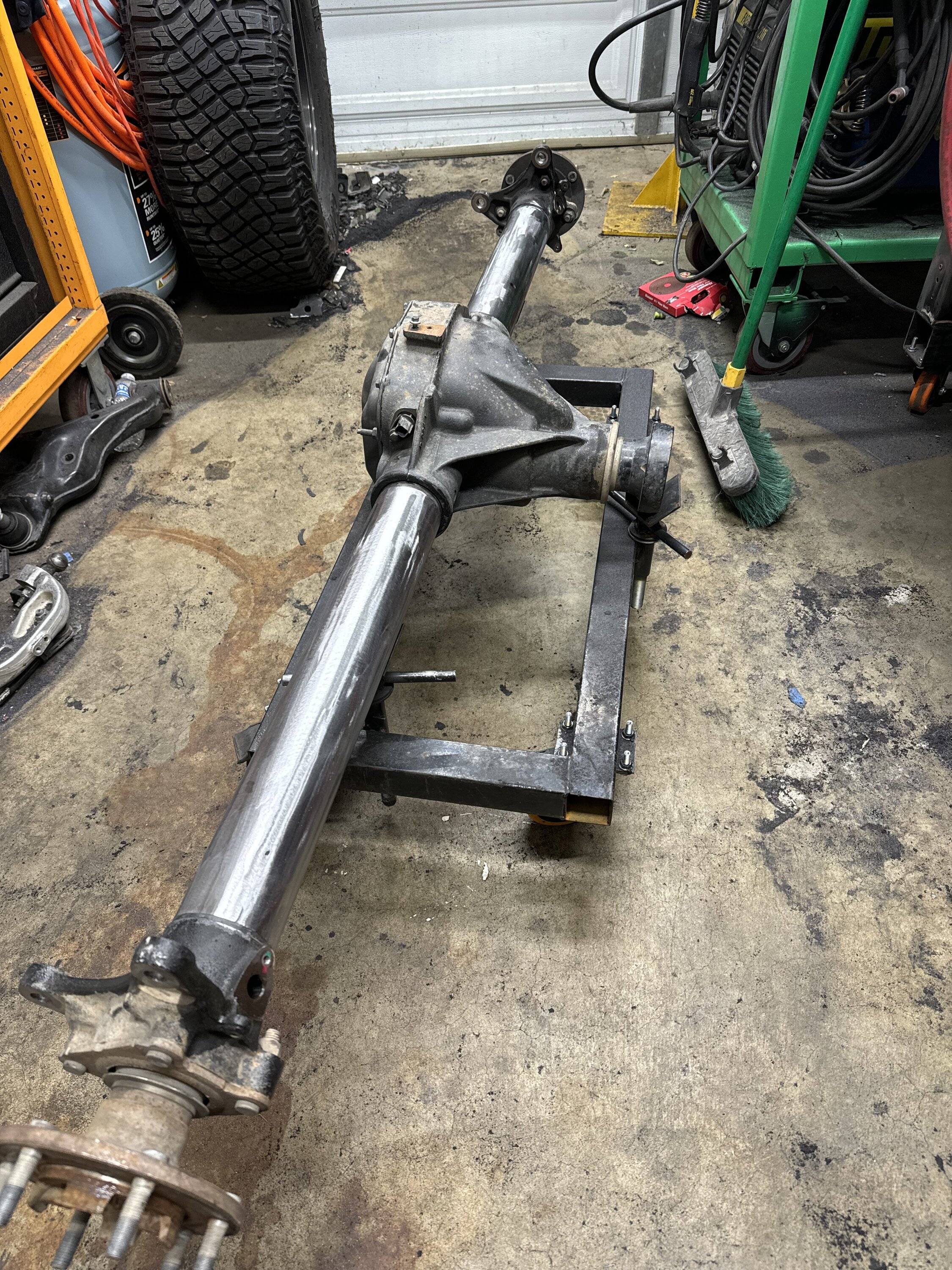

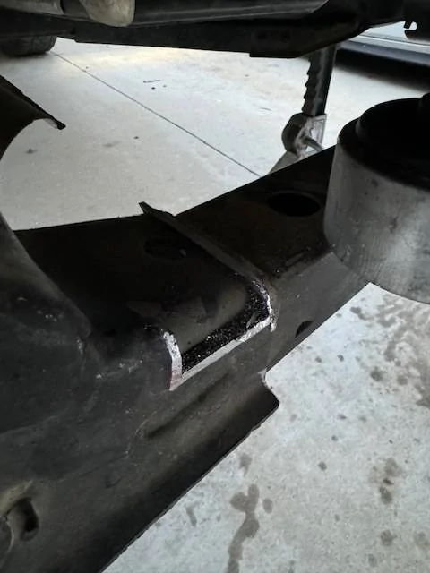

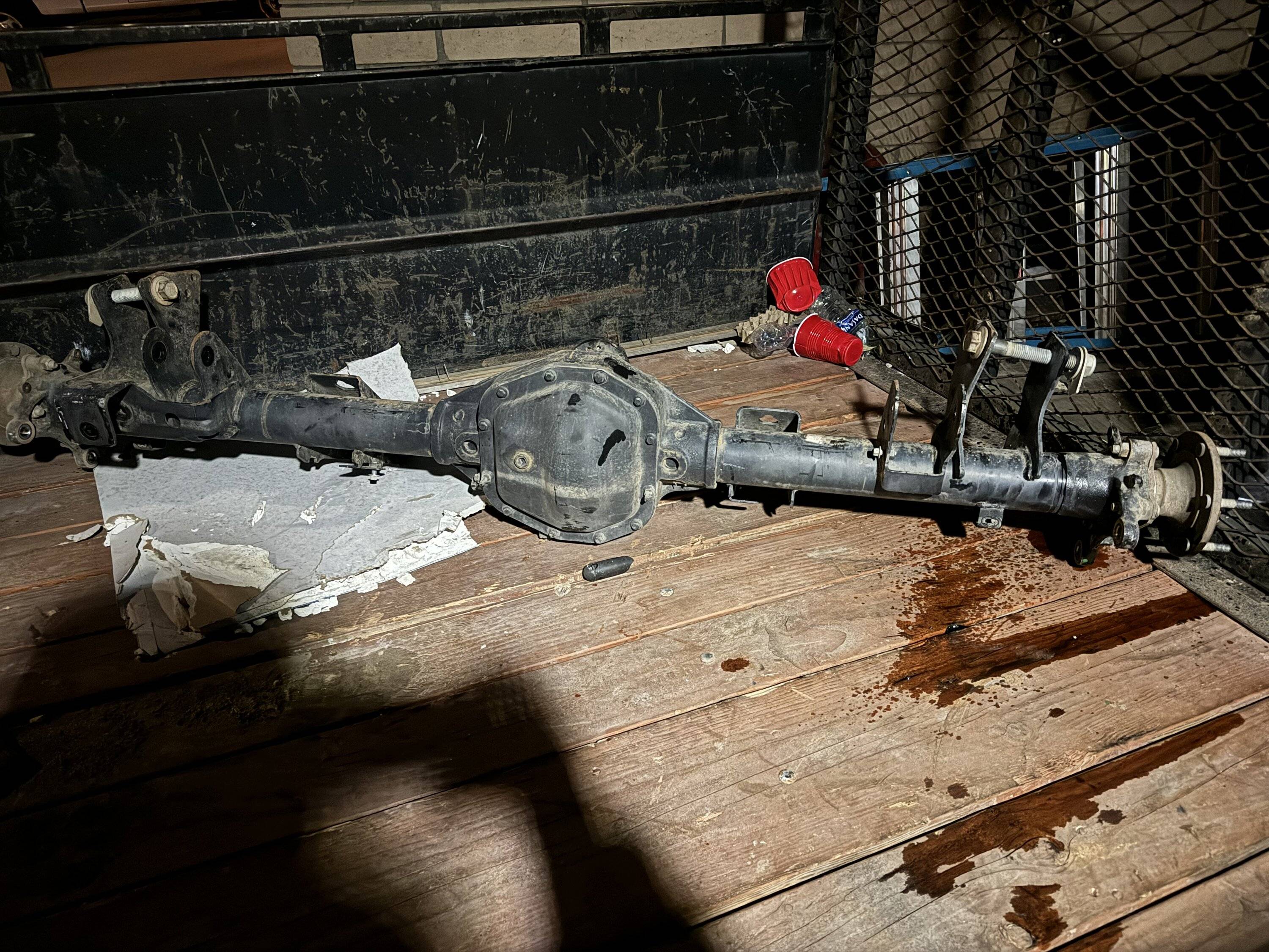

Got all the bronco brackets stripped from the axle. She’s ready for welding.

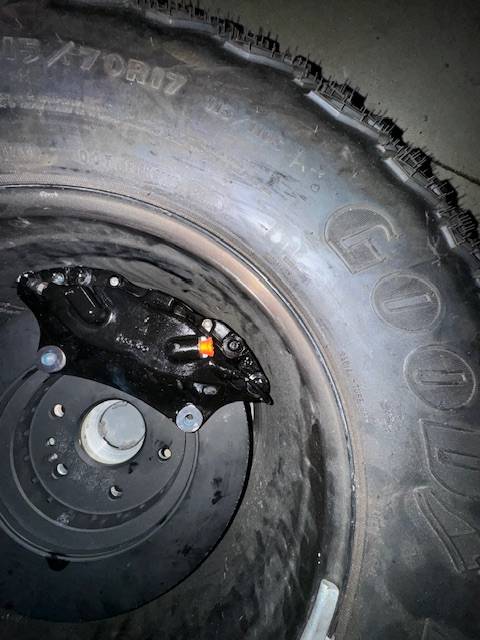

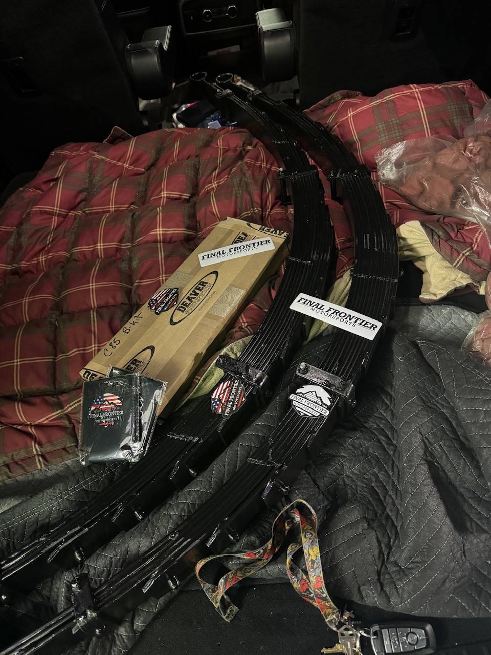

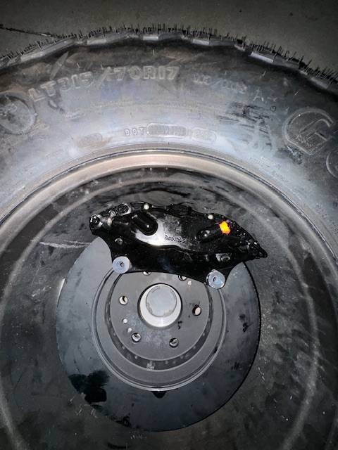

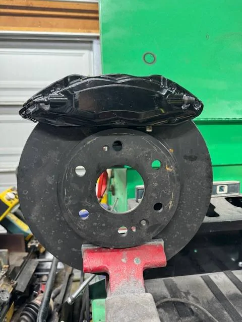

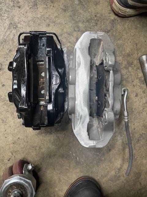

I’m super stocked all my cross referencing worked. Got my brembos delivered today. Bolt mounting holes are identical they’re 4 piston but in a way smaller footprint and a whole lot lighter. Another fun fact on why I’m choosing a factory optioned brake is. If and for whatever reason I need pads and high quality I can obtain them anywhere. These use a Brembo universal pad so say you ask for a Camaro with these you’d be able to just ask a clerk for those or say any other car with these. I think a genesis has them, the ones I got from a 07 gt500, there’s Camaro, Porsche I mean the list is long. Anyway here’s side by side with s550 got 4 piston vs gt500 4 piston in black. This will keep it compact and light with a huge list for pads. O mind you a shaved a ton of dead weight from the gts and theyre still heavier and larger. Got m210 mocked. One mount need to be cut, but it’s one that get relocated anyways with diff drop. Driveshaft from m190 mates up to it but is slightly short by like 2-4mm spacer shim included with diff drop might work. Will see once arrives. Have on order also have spring under perch brackets on order. Also got my Chevy 63s c85 Deaver spring under axles thanks to my friend Walker of FINAL FRONTIER MOTORSPORTS.

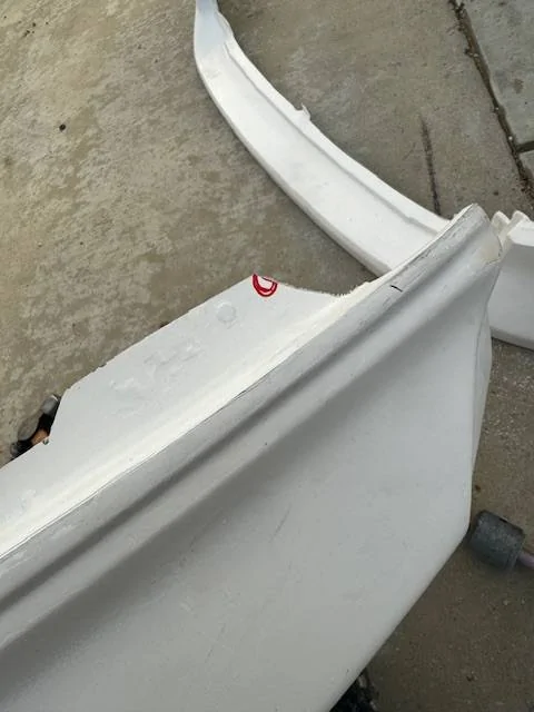

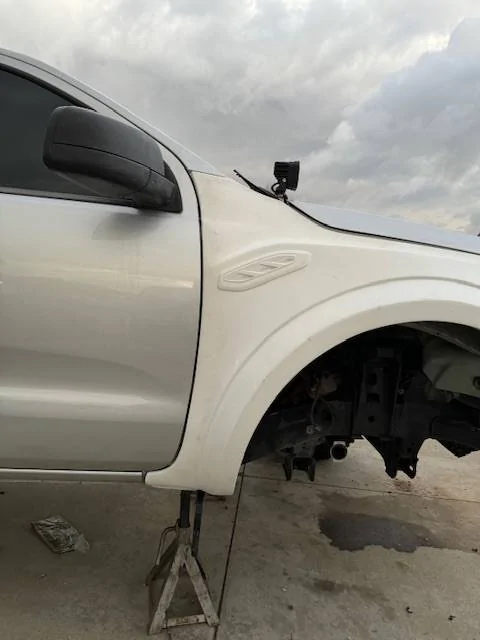

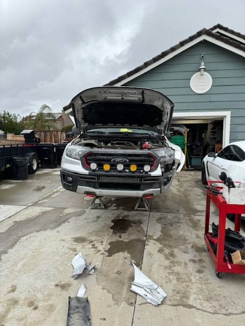

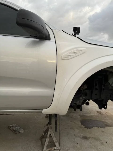

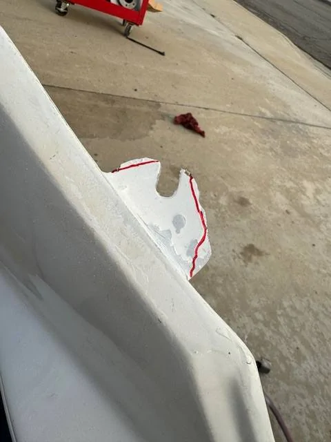

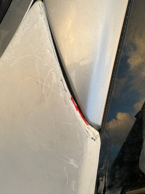

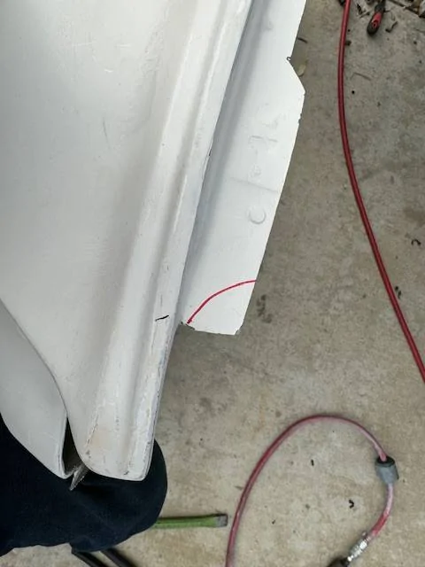

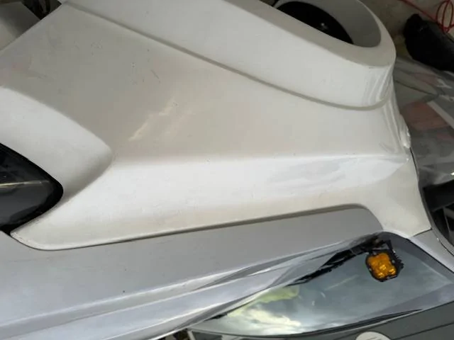

Started the fitting of new fenders and valance. They need a good amount of massaging to get it to look right.

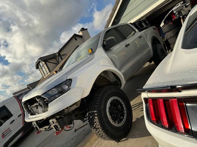

Build is looking great so far. Amazing work! Keep it up

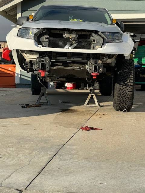

Thanks or the support. Yea I’ll do some more messaging tomorrow. I’m currently debating on cutting from firewall forward and creating a removable tube front end since I think it will be what I need to do to clear 16” coilovers.
