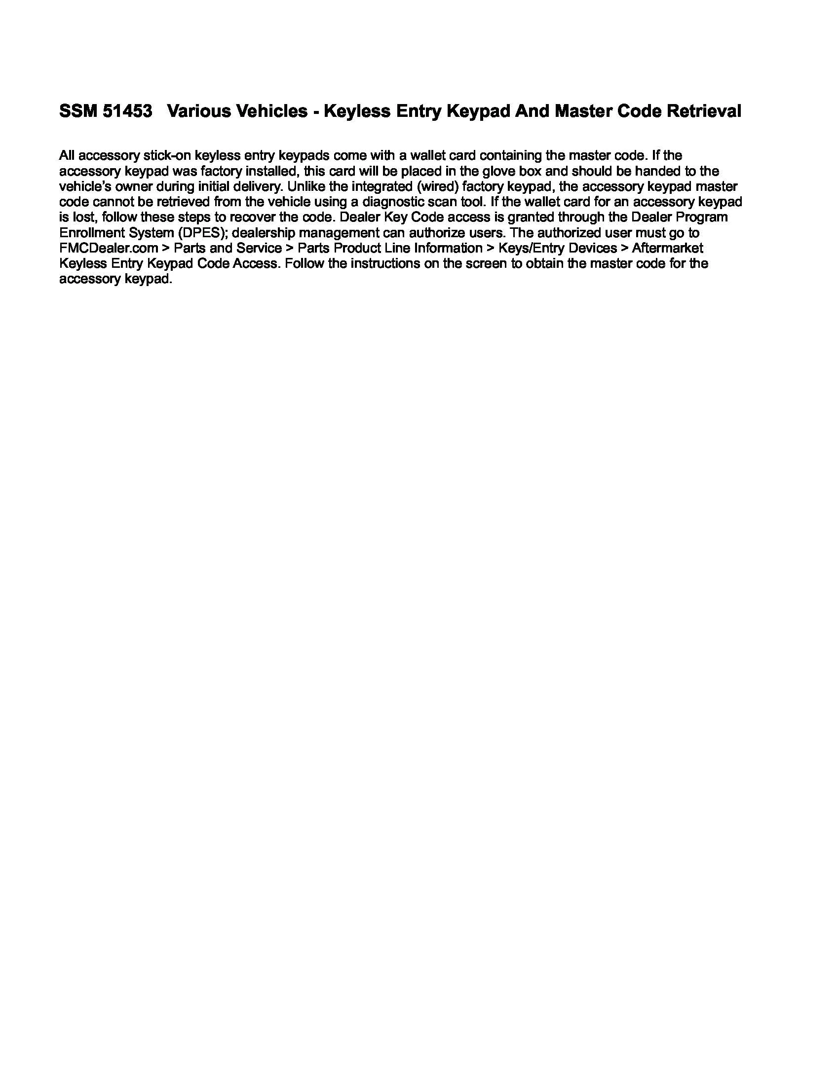

Note: I do not have a keypad, so I can only provide information relayed from other owners who have experienced this issue.
For most I believe the keypad is just there and not being used, then when the owner decides to try it out, they cannot get it to work and either the card was never installed, or the owner threw it out or lost it (NOT KNOWING) the value of keeping it in a safe place.
or
The Truck is traded in and resold, that card (if it was installed in the Glove Box is tossed in the trash) when the original owner cleans it out.
If you have a wallet card in the Glove Box (With the Owner's Manual and Other Paperwork)
then it's an easy process.
If not (Replace the Keypad)
Reason, Dealers are either UNABLE or UNWILLING to dig deep into the retrieval process to obtain the Factory or Aftermarket (Which is a Dealer Install) keypad.
If that code was not inputted into that Dealer Access system, which it appears that it is NOT a normal procedure to do, you will ONLY have the card in the Glove Box and that is dependent on IF the technician who installed the Keypad was attentive enough to place it there or tossed it into the trash can with the packaging it came in.
Note: The Keypad code IS NOT stored in any modules on the truck so a scan tool cannot read it.
The only codes that can be retrieved are for the FOB's not the Keypad.
Note: This SSM is not Ranger Specific, it covers various models and to my knowledge the Ranger does not have a wired variation of the Keypad only wireless.
or

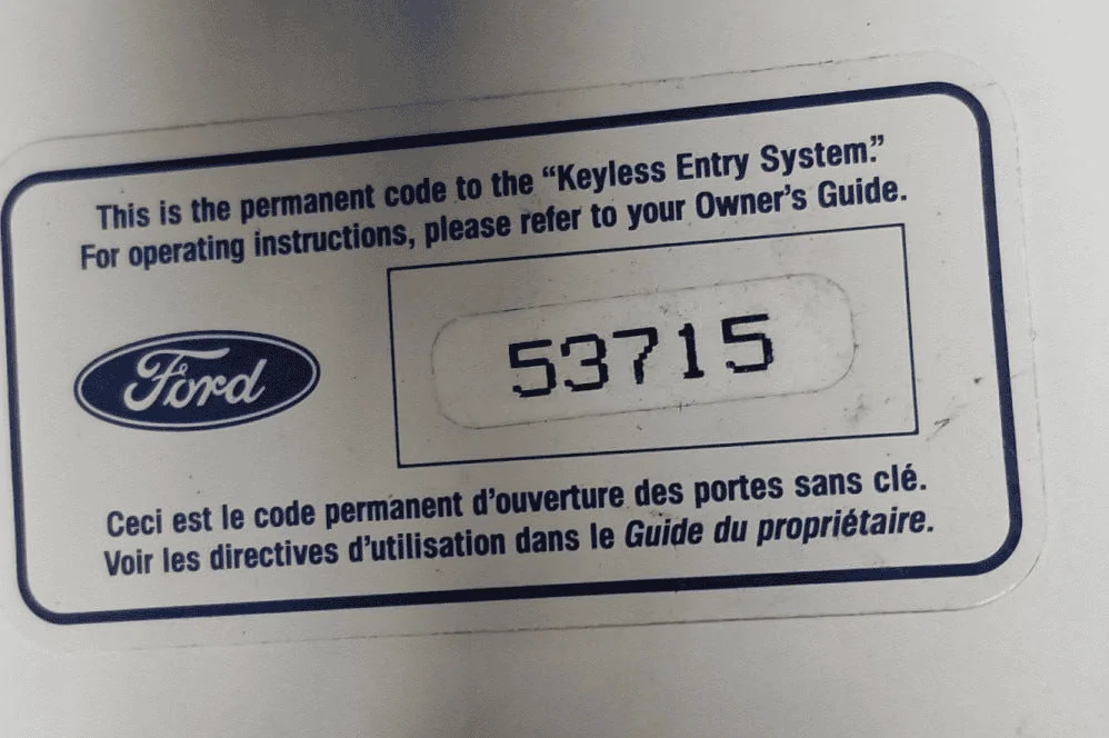

I'm assuming this is the elusive remote keypad card I would need to use in case I "remove" my keypad from my 2019 5g and try to re-install it on my new 2024 6g, should it ever get delivered! And assume it would have to be set up by the dealer once I 3M it back on my new truck....yes it is the size of a credit card and was in my glove box...
