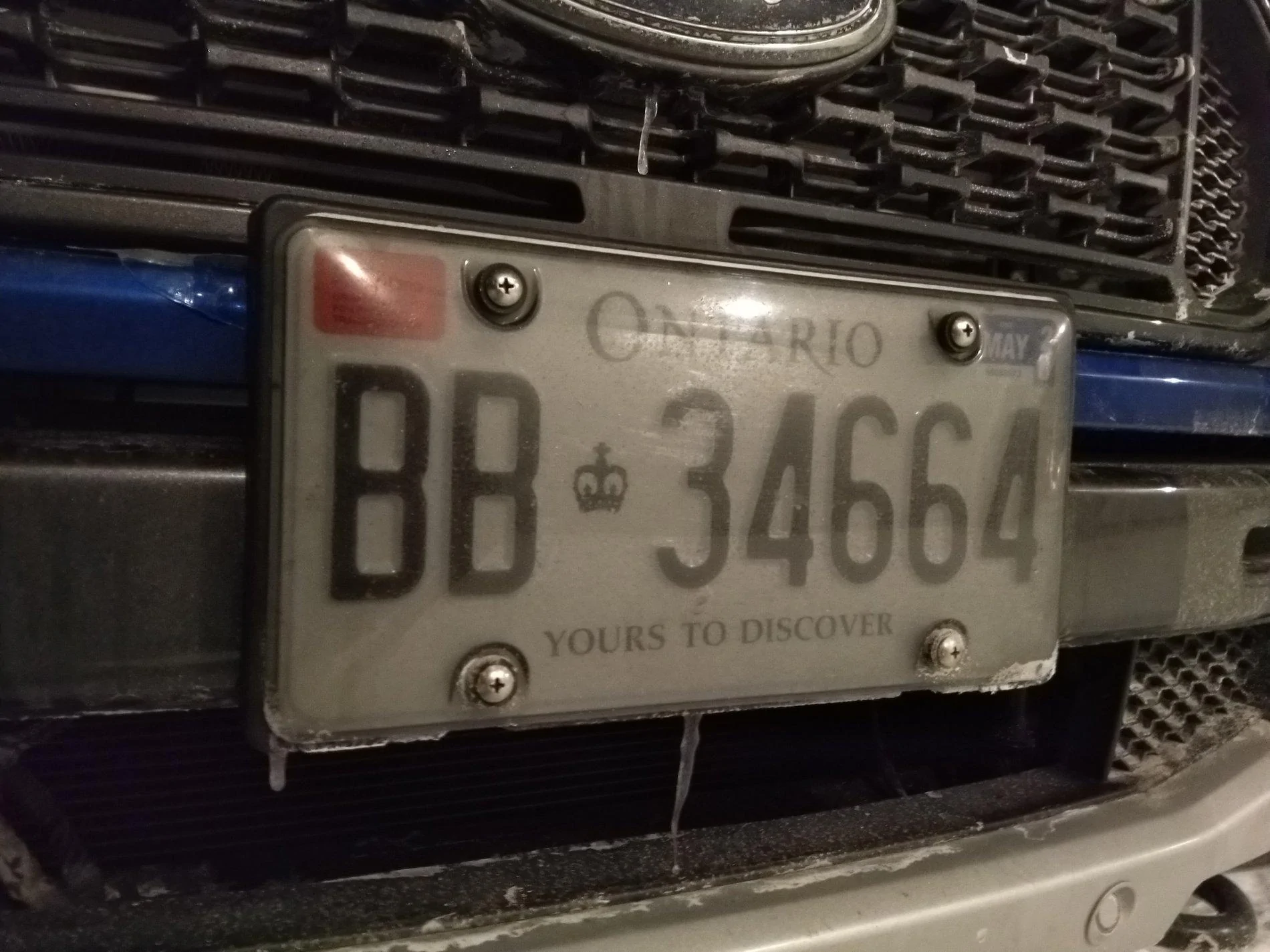

Yup. Got mine at Canadian Tire iirc. I'll go take a pic in a min... I seem to recall I trimmed the bottom of the license plate bracket to get it to fit, but it works.

It's too damn cold out, otherwise I'd remove the cover and plate to show you. I trimmed that little piece that holds the bottom edge of the plate on. I then drilled two new holes in the bracket for screws. Careful of the screw length or you'll touch the bumper itself. I used black plastic washers to take up the space so the screw wasn't cutting into the bumper.

Thanks, that looks different than the one I had that wouldn’t work. I’ll pick one up next time I’m out!

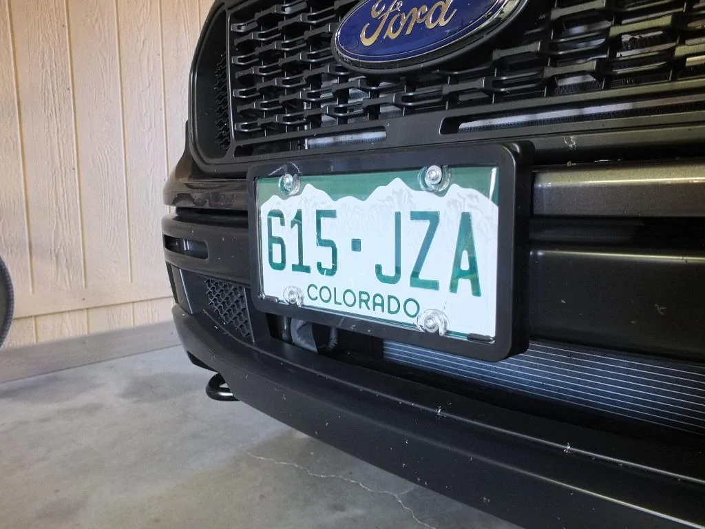

FWIW... link to the cover I used on my Ranger front plate: HenryMac's Build Thread: 2019 Ranger XL STX FX4 Magnetic Super Cab
Looks good if you have a Magnetic or Black painted front bumper. :like:

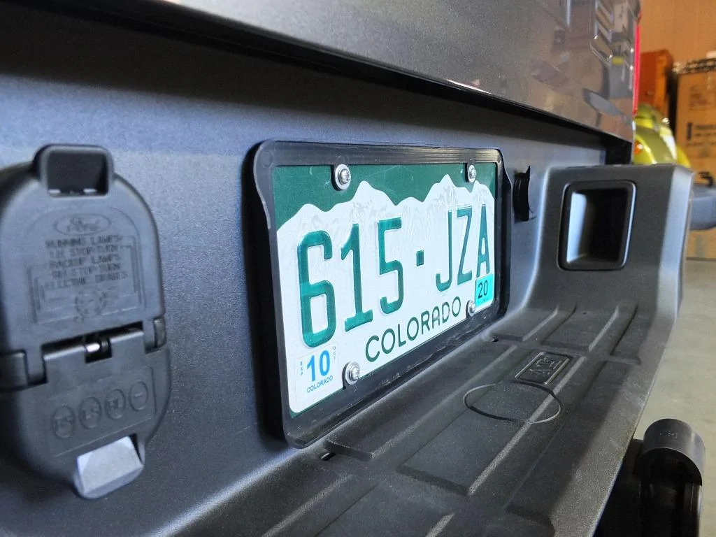

Rear plate proximity to the tailgate is another dopey Ford miscue. I ended up modifying a black frame by mounting it backwards and grinding down the plastic.
The big thick frame the dealer installed would have worn the paint off the tailgate! :facepalm:
