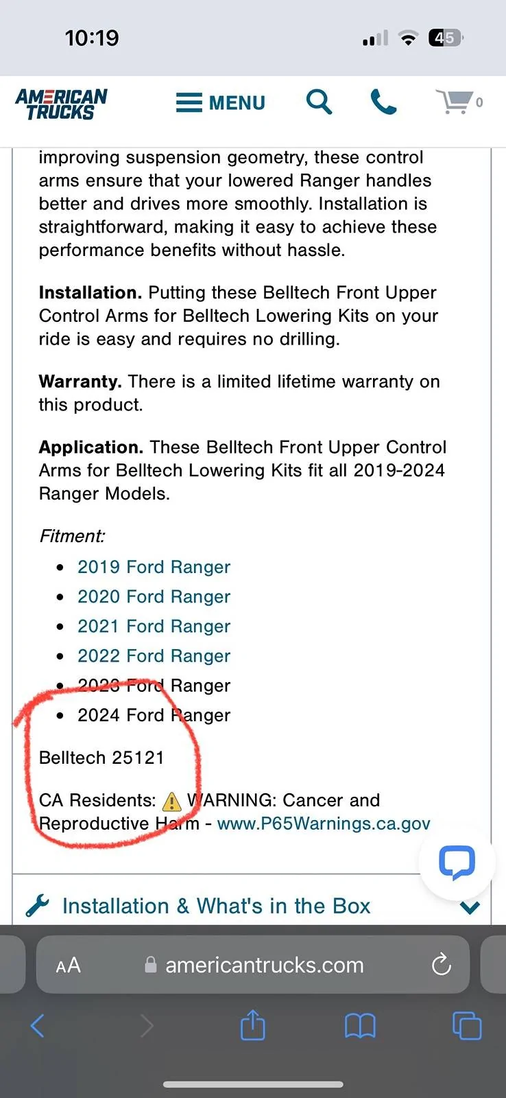

Sounds like a solid plan.
a few things to consider.
Belltech does not make adjustable control arms that I’m aware of. Their control arms they make for lowered Rangers do not fit steel knuckles (21-23) they are too small and the pin is loose in the taper. Their rear shocks suck and also will hit the frame on the right side if you aren’t careful. The Roush intake is ok but ultimately it is restricted by the 2x2 hole in the factory air box that gets reused. It’s a very expensive lid, filter and hose. If you plan on better performance down the road I would strongly suggest a different intake.

Ah. That's something I'd have to look further in to. I know they sell control arms, and they list it as for lowered Rangers, and is sold in their kits. I was under the impression that it does bolt up to stock components, and was adjustable. It's in their kit FR8293. Their control arm by itself is FR19166.
But it appears I was wrong. You're right. It is not adjustable. Still, I'd need something for when I lower it, to maintain somewhat of an alignment.
As soon as I'm ready to lower it, I'll report my findings.
Unless there's another alternative you all know of? I'm all ears. Can't do Freakrides. Too expensive and don't want/Can't fab up mounts.

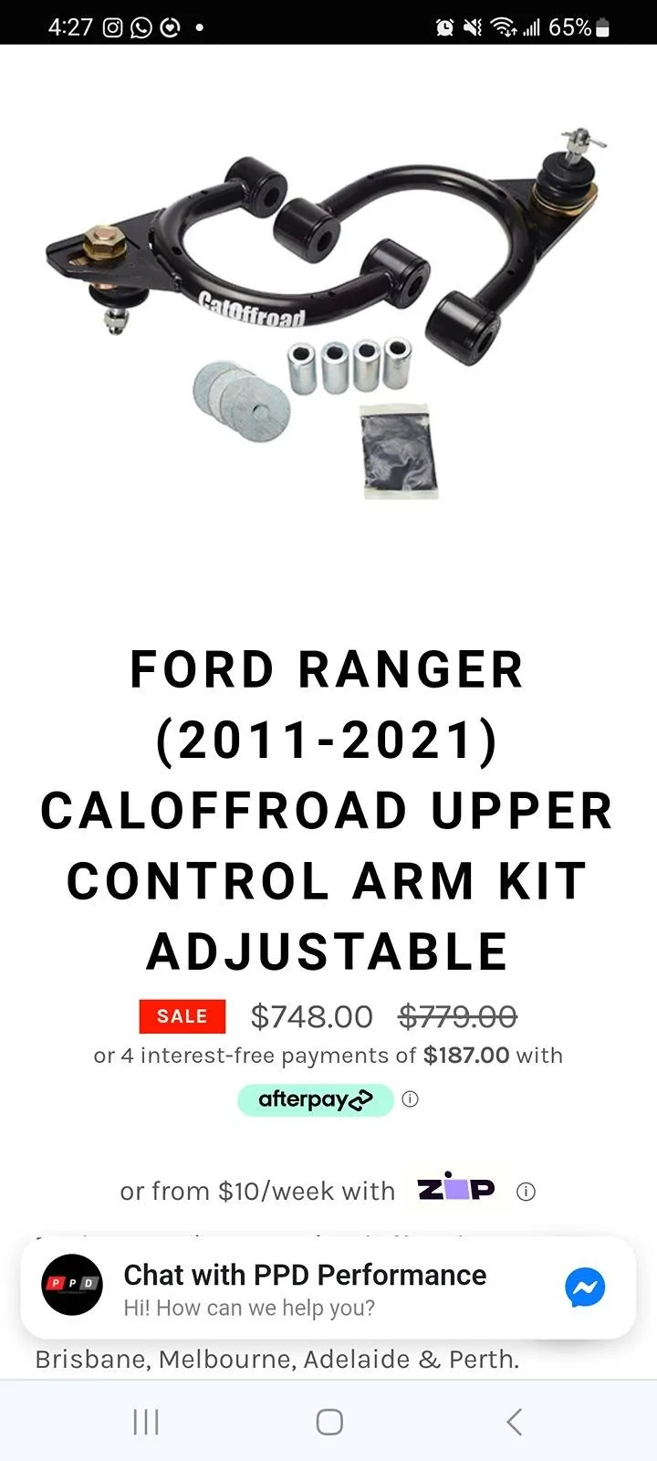

OK. So stupid question, but does anyone know if the Australian Ranger shares the same control arms that we do?
I found a company that offers true adjustable control arms.

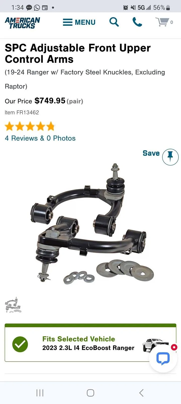

So I have some good news. Got a hold of the Australian company that provides the adjustable control arms.
They're basically rebranded SPC control arms.
SPC is an American company, and their parts are sold on American Trucks. I've attached a photo of it with their part number. The control arms are designed with stock dimensions on mind, so it will work for either lowered/stock trucks. They're not marketed as Adjustable CA, though they may still work.
So for those who lowered, including myself, this will work. Seeing as I have steel knuckles it's perfect. @Loweredon33s, you might want to look into this, if you still need and want this.. especially if the Belltech arms are NOT adjustable and fitment is questionable.

I have but they are expensive and not made for lowered suspension so the ball join angle is still shitty.
