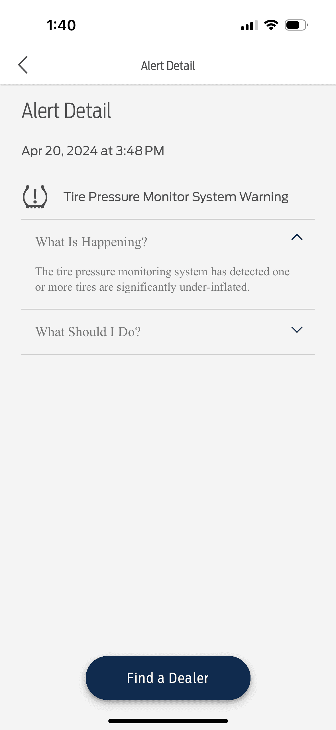

Swapped out my wheels/tires on Thursday. The winter set are on steel wheels off a Bronco and have working TPMS. The summer set is the factory Tremor set. This has gone smoothly every time before - twice a year.

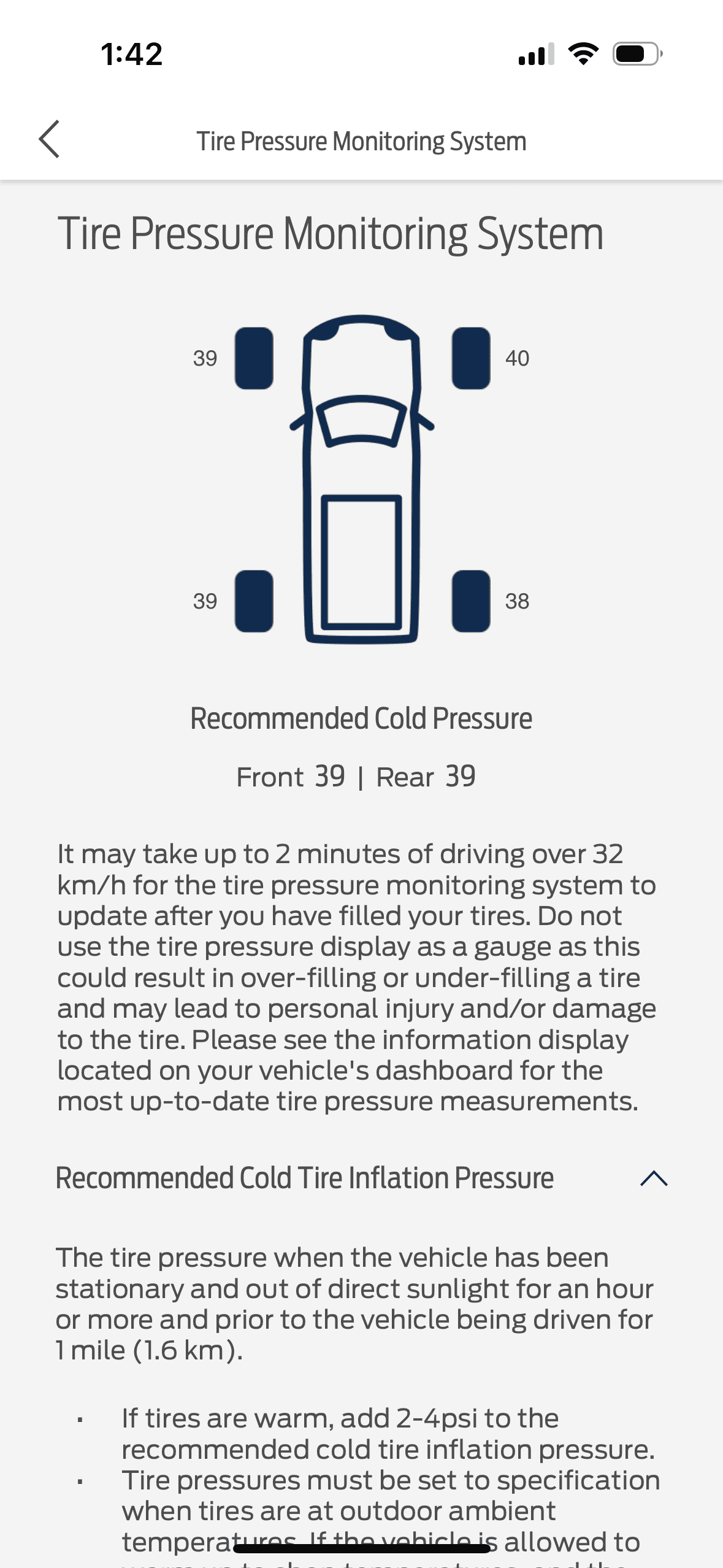

The summer tires are not connecting to the TPMS it seems. And the truck thinks one or more tires are significantly under inflated. I did make sure the pressure is set to the recantation on the sticker in the door jamb - 39PSI. I have driven the truck on a road trip for hundreds of kilometres. It’s been several days, a combination of short and long trips. Still nothing
I found the relearning instructions on here. The truck does go into learning mode, but it does not acknowledge the tire pressure change and allow me to proceed. I dropped the driver/front tire to nearly 20PSI a couple times and no response from the truck.
I find it hard to believe there is an issue with every sensor. Not sure what to do next. Swapping a tire with the driver front to see if I can get the truck to recognize something is a PITA.
Should I try the battery disconnect option?
Do I order a TPMS reset tool ($30.00CAD)?
Take it to the stealership?
Thoughts and tips are appreciated.

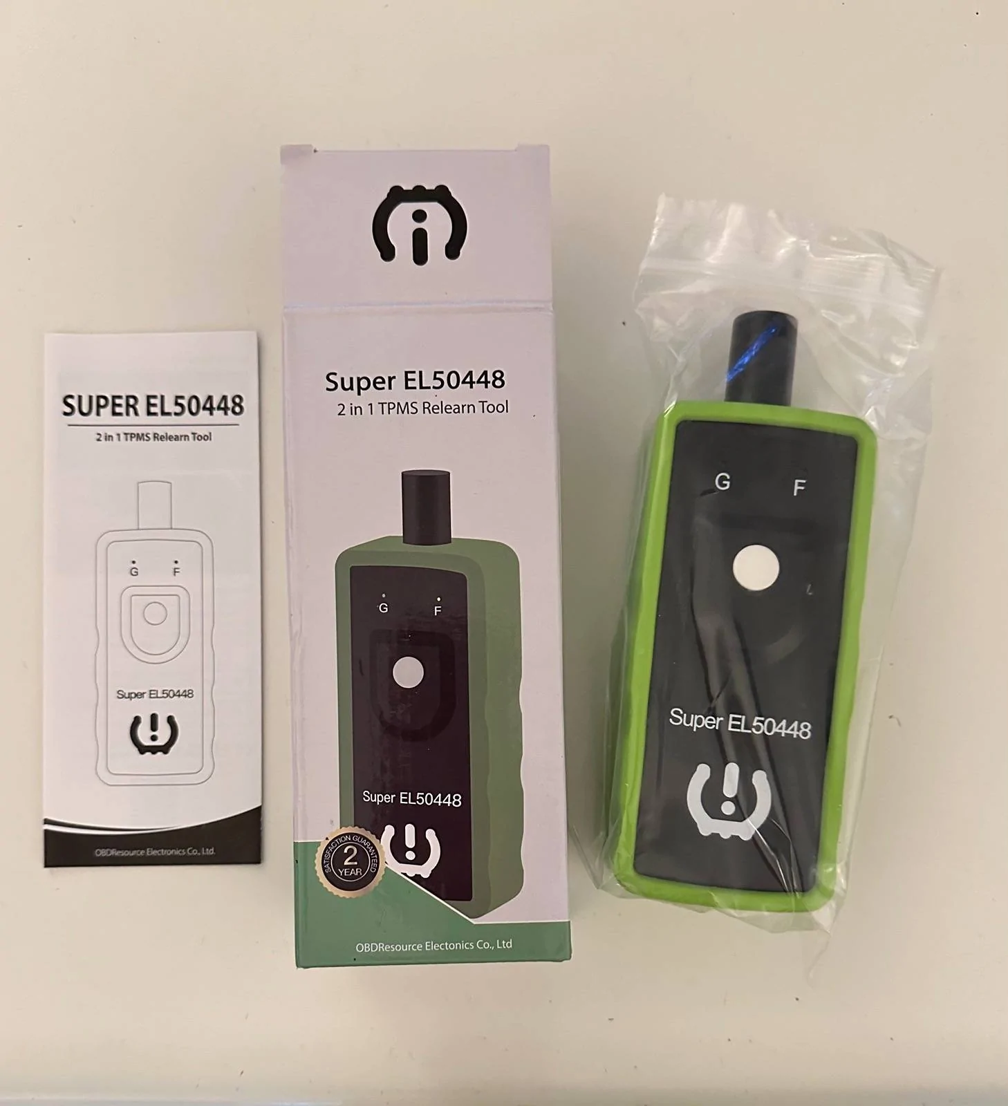

I believe the lowering pressure method only works with some sensor types. I have always used the tool to do the relearn. I think I bought it for around $10 CDN from China.

Ordered this tool from Amazon. Seems fairly simple. I’ll try this one tomorrow.

Ok,
With the tool, enter learning mode as you have done previously.
Start at LF - If still no response from the sensor:
Try the same procedure with Driver's Door Open
If still no response, jack and rotate (spin) the LF Tire and try again.
If still no response, move to RF etc. to see if any of the other sensors will activate.
This will throw off location but at least will show which sensor is not transmitting.
