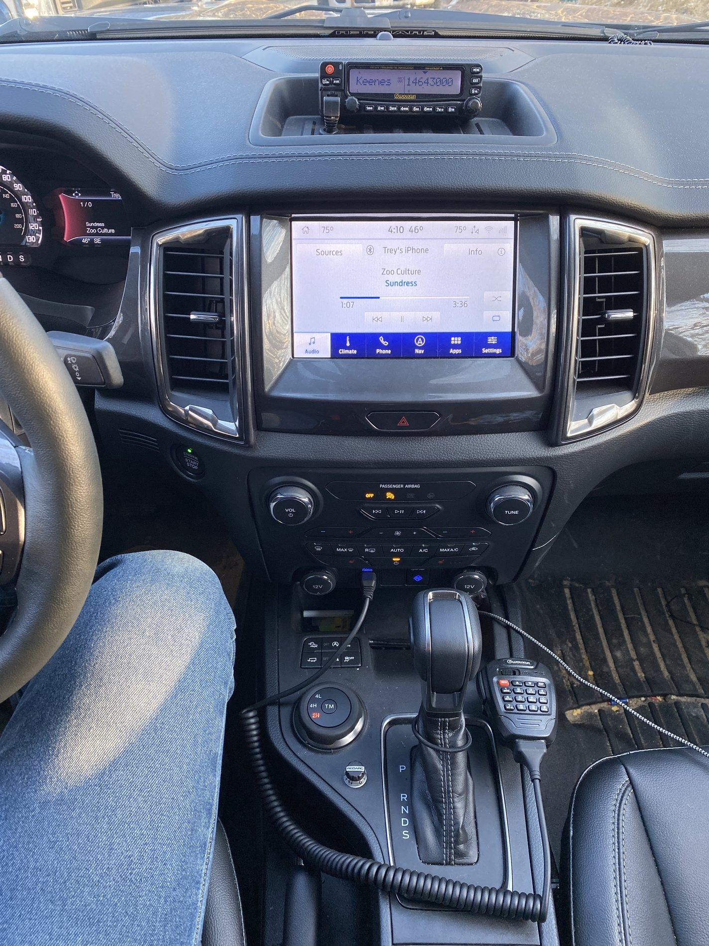

I've been towing a lot of trailers lately, and, while most of them are light, they're getting heavier. Time to install the Redarc Tow-Pro Elite that's been in my back seat for two months.
Installing the Redarc was simple enough, but dang, the factory harness wires are SHORT! They had me bent at all kinds of weird angles under the dash crimping them together. I zip-tied the Tow Pro box to the metal support under the fuse panel under the steering wheel, and mounted the control knob under the drive mode selector. There's a honeycomb structural pattern under that panel, I took a pair of pliers and sort of sheared it off until the back of the rotary knob cleared. There's a TON of room under there to work. To get under that panel, I started at the cupholder seam with a plastic trim tool and gently pried up the clips all the way to the front. I left the front clips in place and just hinged the rear of the panel upward enough to work.
While I was under the dash playing with electricity, I finished running power to my Wouxun KG-UV920P-A 2-meter/70-centimeter radio. I had already mounted the faceplate in the dash tray, the speaker mic on the console through the Lightforce fascia, and the antenna through the roof, so it was time to mount the radio chassis. I don't have a photo, but I mounted it on the C-pillar right where the rear seat hinges, so I can reach it for programming without moving the seat.
Here's an updated view of my console, also featuring Sync 3.4

Nice work, looks clean! I was thinking of mounting my ScanGuage there but I wasn’t sure if the heat in the summer would hurt it.
280
21,289
101,276
Arizona
CEO of DeeZee
That would be a puddle of plastic by the end of April here.
280
21,289
101,276
Arizona
CEO of DeeZee
I've had good luck with the radio on my Fiesta being up there, but I don't regularly see temps over 100 like you do!

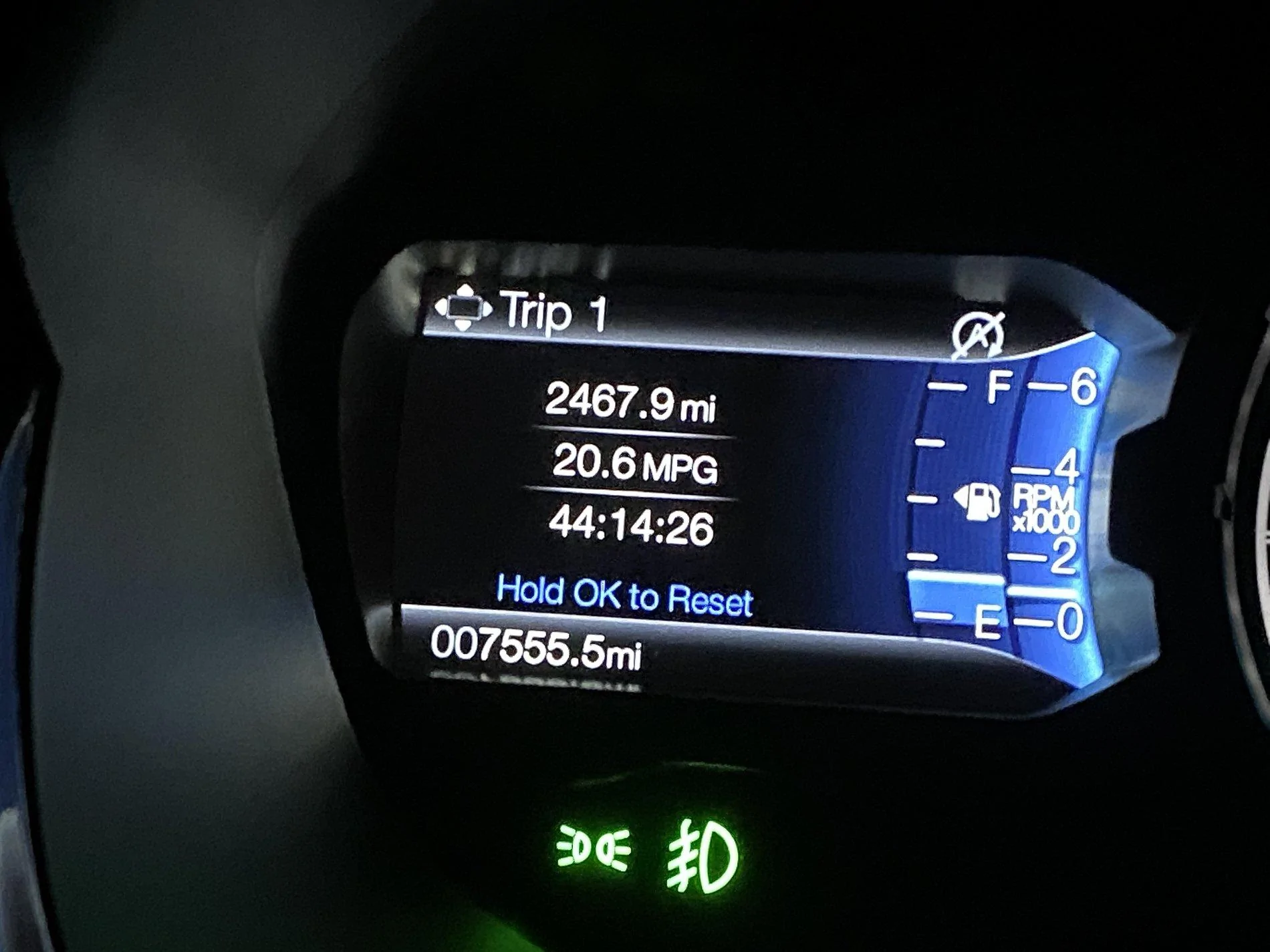

First off, a trip to Atlanta and Charlotte for my girlfriend's birthday weekend. I took her to her two favorite places, the Georgia Aquarium and ST Octane Academy! 2,467.9 miles. The trip fuel economy worked out pretty close to the hand-calculated 20.4 MPG.

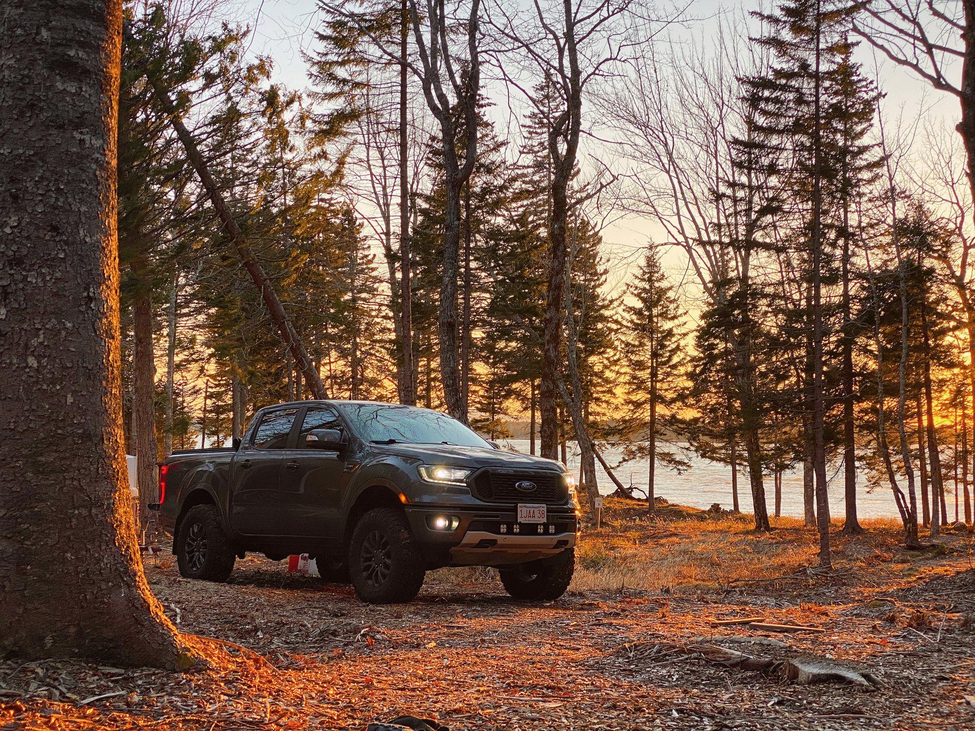

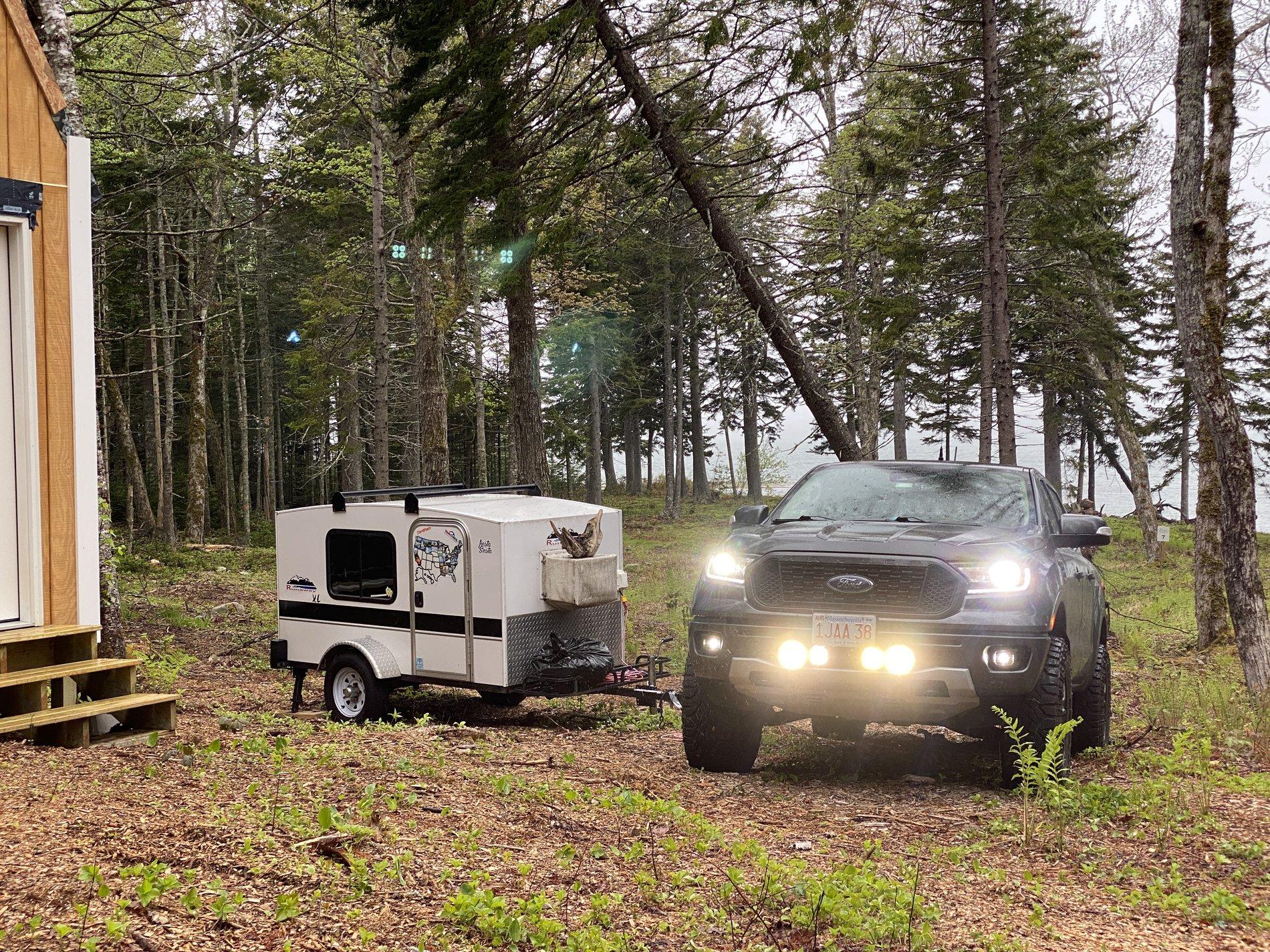

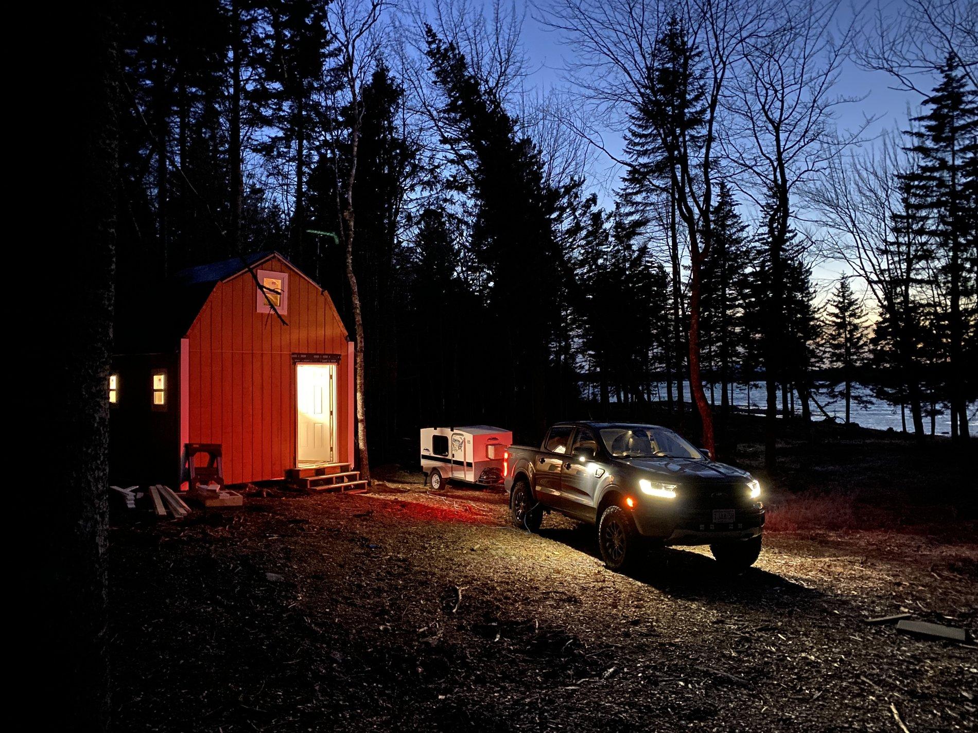

Next up was a trip to Maine to help my parents finish a shack we built last fall on their property

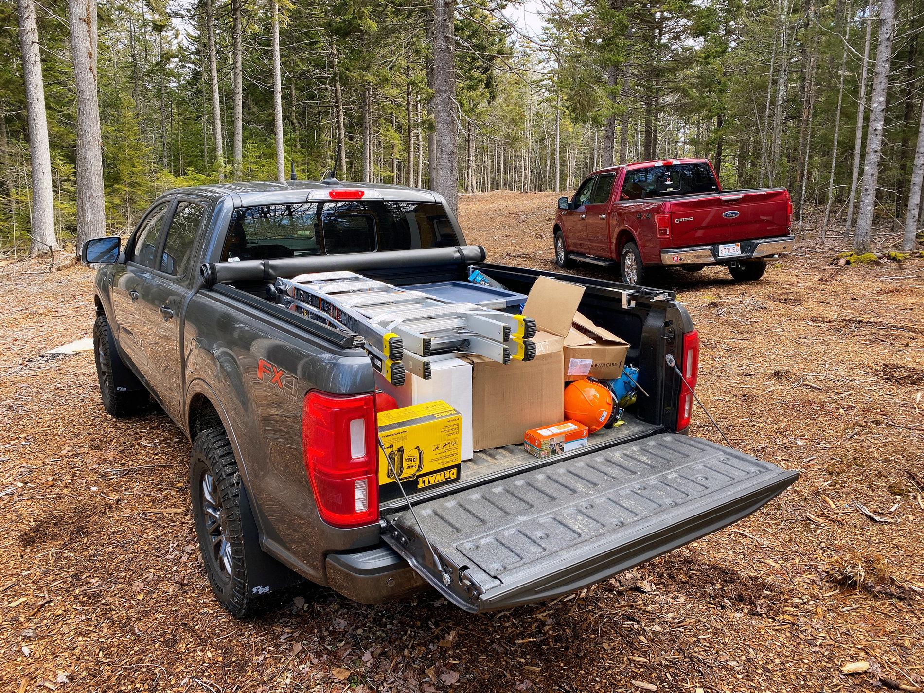

The Truxedo tonneau cover was a huge factor in the success of this trip, as it was pouring rain the entire drive from southeast Massachusetts to eastern Maine. I took ALL of the equipment, since it all had to stay dry and my mom's F-150 doesn't have anything to cover the bed. Bonus, you couldn't tell at all that there was anything underneath it.

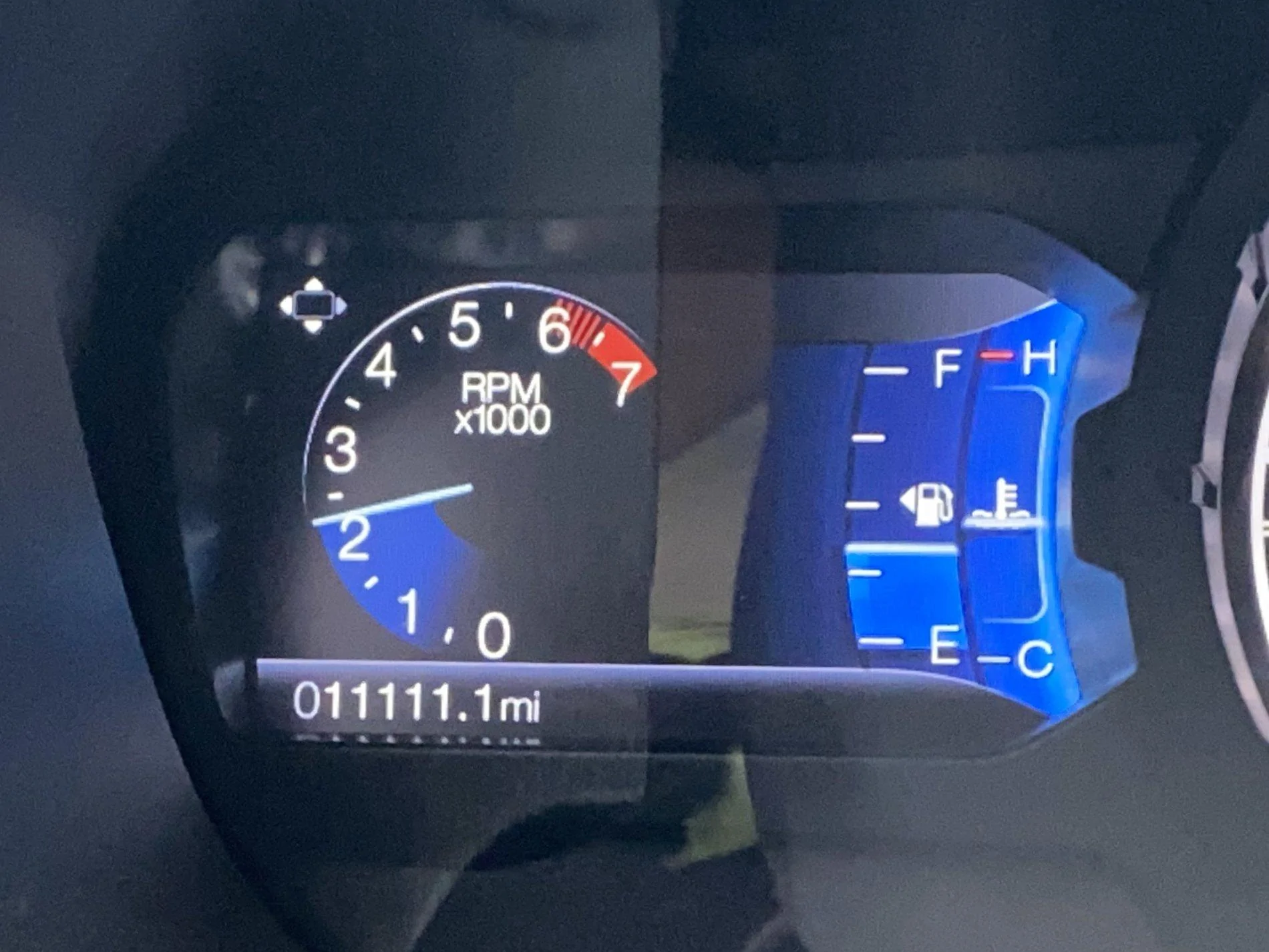

11,111.1 mile update.
The only new "mod" is I got drunk one night and tinted my tail lights, and it came out great if you don't get closer than 20 feet from them. I'll re-do them eventually, but I've been so busy with work that I've only done routine maintenance.
A few observations now that I'm in the 5-figure odometer club:
-Fuel economy is 2-3mpg better in tow/haul mode
-10th gear is only useful over 70mph, otherwise the engine lugs and fuel economy suffers
-Tire pressure has a HUGE effect on the ride and handling, I can feel the difference between 30 and 32psi

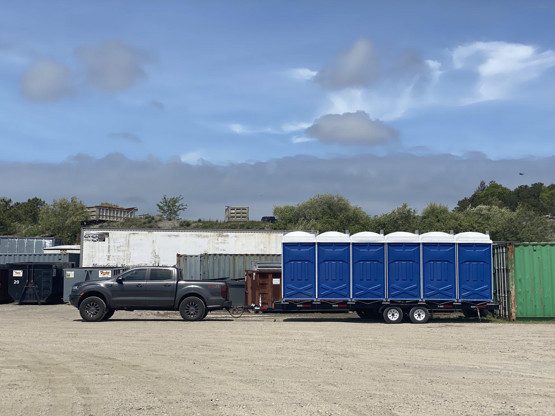

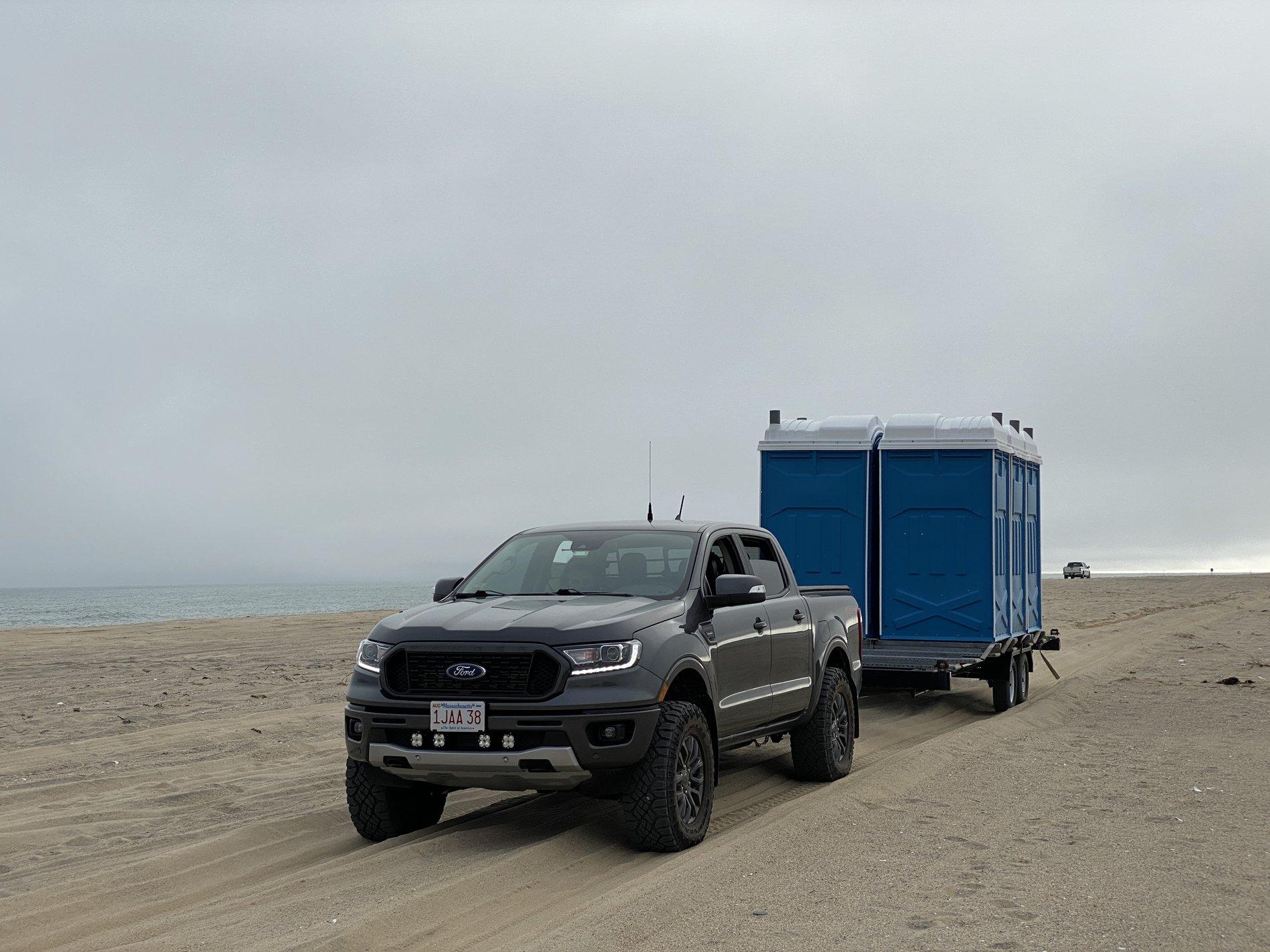

We're towing bigger, heavier trailers. This one is about 4,500lbs as pictured, but it's weighed over 6,000 with heavier units on it. This is also a good shot of the tinted tail lights; the light shines through very well and I couldn't tell a difference in output side by side with a stock Ranger.

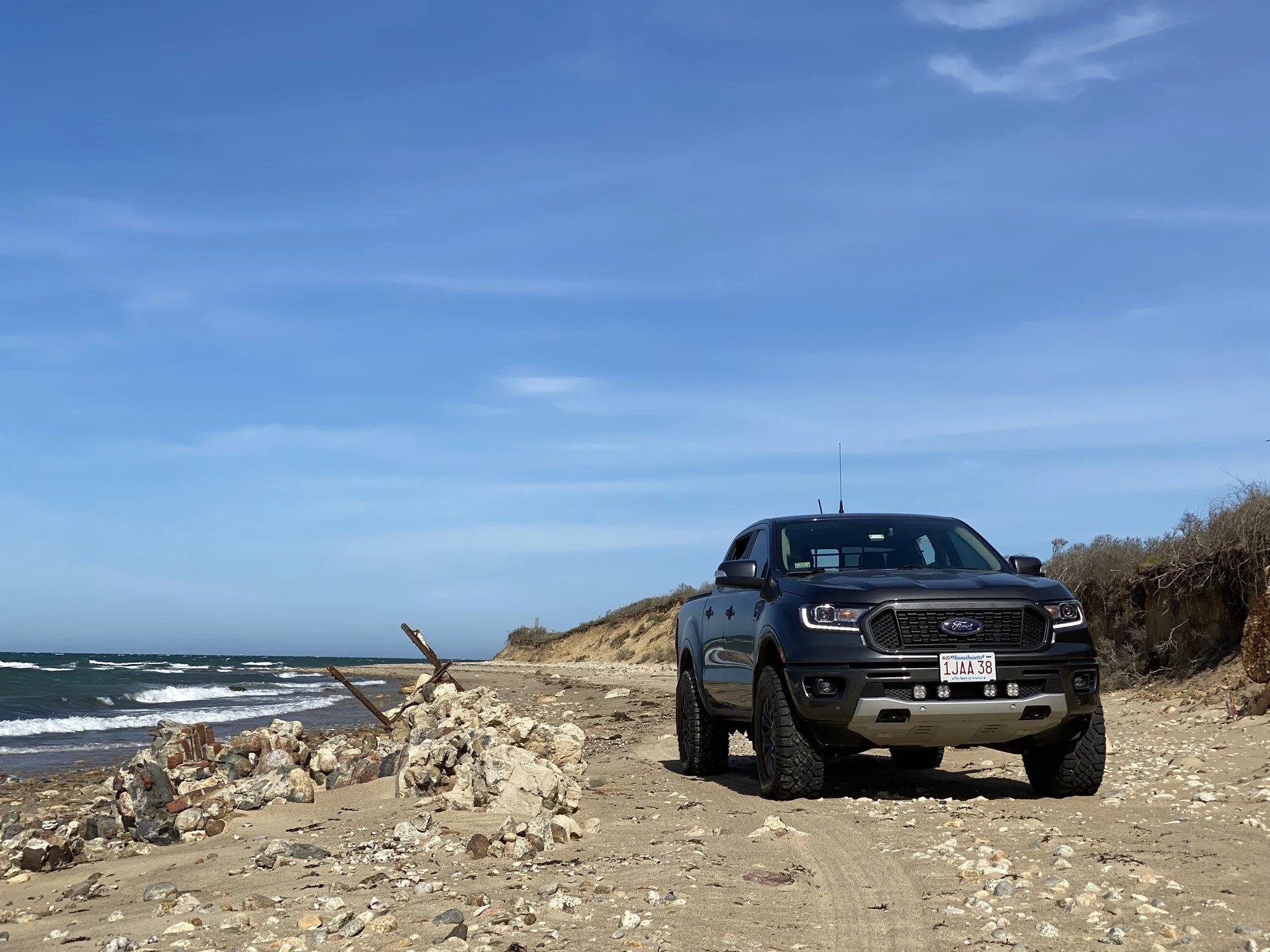

I even towed a trailer 15 miles round trip down the beach! Aired all 8 tires down to 15psi and it didn't complain a bit, besides the three gallons of fuel I burned in 15 miles.
Every so often, I even get a sunny day off, which means more driving on the beach.

Truck looks awesome! On the tire pressure. Are you running 32psi on street/highway or offroad ?
Keep sharing the mods!
Thanks! I'm running 30psi on the street/highway and 15psi on the beach. 32psi seems to be the point where it gets extra jittery on corrugated roads, and it's downright awful at 38psi (thanks Valvoline for the "tire pressure check") lol
