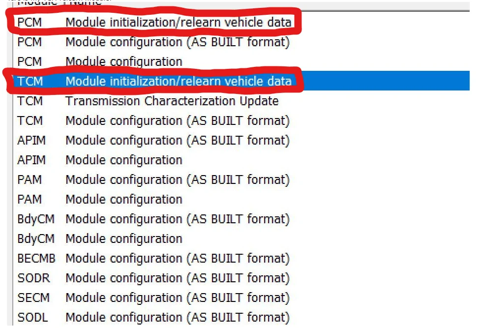

I haven't had time to install the newest Beta Forscan nor adjust my tire size, but from what I've read at least on the F150s, you have to do a PCM Relearn and maybe a TCM relearn (if the ranger has a TCM module) after updating your tire size. Would you mind reconnecting to your truck with Forscan and checking if it has these two options?
petulantskeptic
May 26, 2019
48
42
Washington
2019 Ranger Super Crew Lariat
There is no TCM module on Rangers.
I tried the PCM relearn multiple times at various different 726-12-01 values. It never cleared the error. On F150s changing 726-12-01 causes a different error code than on Rangers. On F150s it throws a P160A, whereas I consistently get U0422.
RedlandRanger
RedlandRanger
Nov 14, 2018
36
4,623
8,948
That sounds exactly like what happened with my brothers truck. U0422 sounds familiar. And I did do the PCM relearn multiple times but it didn't make any difference. I cleared the code and as soon as you restarted the truck it came back immediately.
