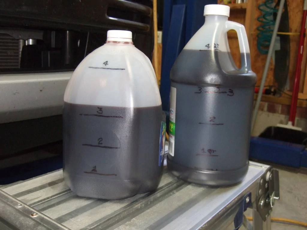

After suffereing from analysis paralysis for the last year I finally decided on a course of action with my transmission strategy. I think that it is sound and will protect my extended warranty coverage.
I've been sitting on my PPE deep pan for 18 months, worried that Ford would use it as a reason not to honor their warranty if I install it and my transmission problems continue to worsen.
I have 20,200 miles in my Ranger and the transmission has been erratic since about 5K miles. It seems fine for awhile then has bouts of hard shifting. No pattern that I can discern.
I plan to change the fluid without removing the pan immediately, and add Lubeguard Platinum ATF Protectant (1oz / quart of ULV ATF - Thanks ctechbob), then do the same at 5K-10K intervals to see if the problems clear up. If they clear up I will install the PPE pan (and change the filter)... and drive happily ever after!
So I began this afternoon by pulling the fluid out via the MBS Dipstick (aka the "Fitz Stick"). I managed to remove just over 7 quarts of fluid using this inexpensive 12v pump.
I marked a couple of jugs before beginning to insure I had an accurate measurement of just how much fluid came out.
What was surprising to me was just how dirty the fluid was with only 20K miles on it. It is dirtier than fluid that I've pulled from cars with 60K miles on them! Here is a look at what came out of the transmission. That fluid is supposed to be bright red, not black! It is no wonder these transmission are acting up!
ctechbob has had good results using this strategy. I am hoping for similar results. We'll see soon enoug I suppose.

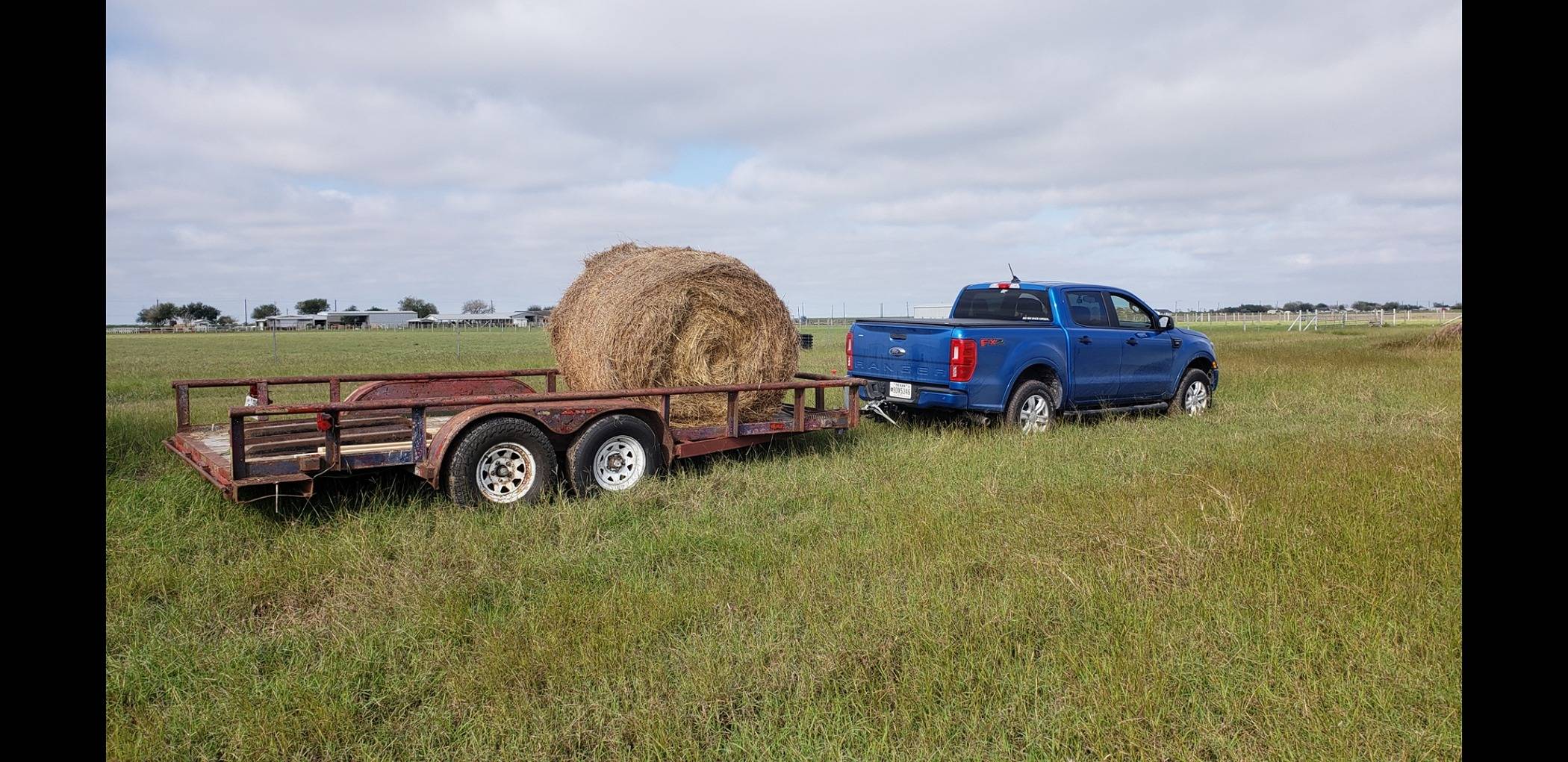

Mine drives like a truck! The more off road you use it, the more all the defects are hidden by the bumps, dips, mud, trailers, dents, scratches, and really becomes a good ol truck that impresses all my hd peeps. I have 77k miles driving the ranger and towing and, i really think my tailgate strut assist and my
GEN-Y HITCH
have held the truck together
Impressive. I wish my truck was a robust as yours. I think they cured a lot of the transmission issues by 2022. The CDF drum and some SW issues for sure.
They also updated the the plenum for the heat/AC to correct the warping issue that requires the dash be removed to replace it.
That area looks like Southeast Texas past the Big Pine country (Waco area) or maybe northwest of Ft Worth. I spent 5 years in Shreveport a long time ago. Texas is big and there is a lot of open flat land

I am in south texas. A stone throw away from Mexico. The bed does not hold up well to work. And paint is thin. But, do what i can to make it last longer. But in the end, well, we have trucks here, with my family, and we use em as such. Just sad to see em go so high in price when we use them for work. We dont even go offroad yet always find ourselves "offroad"
