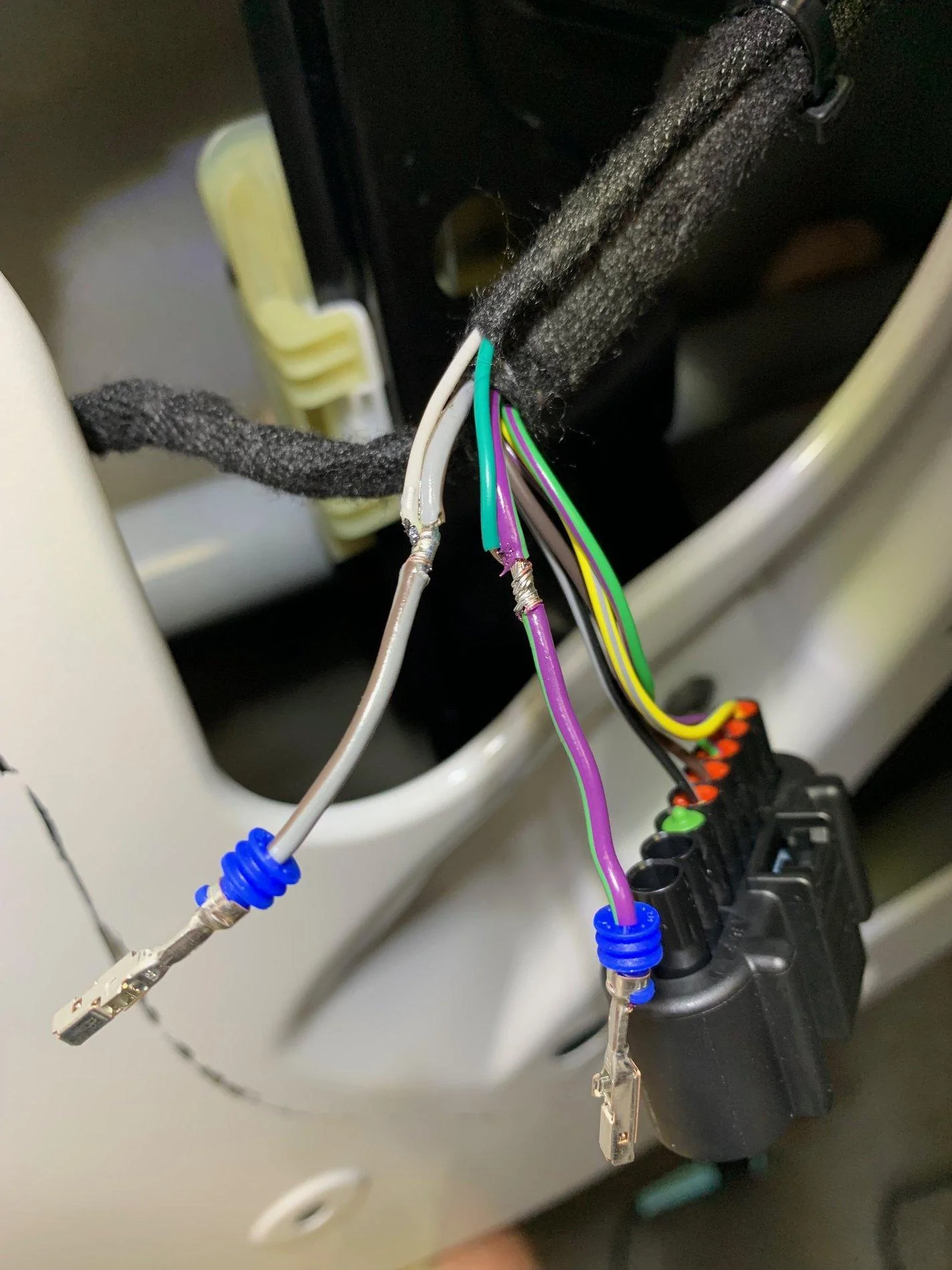

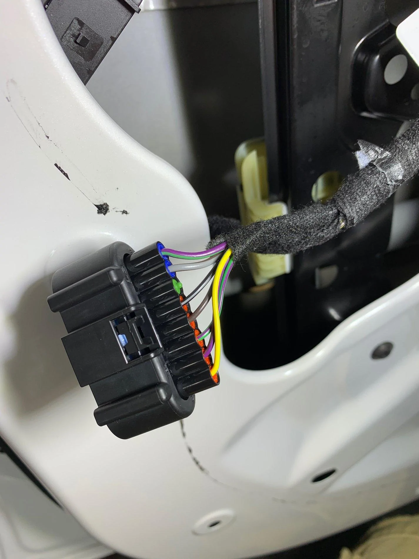

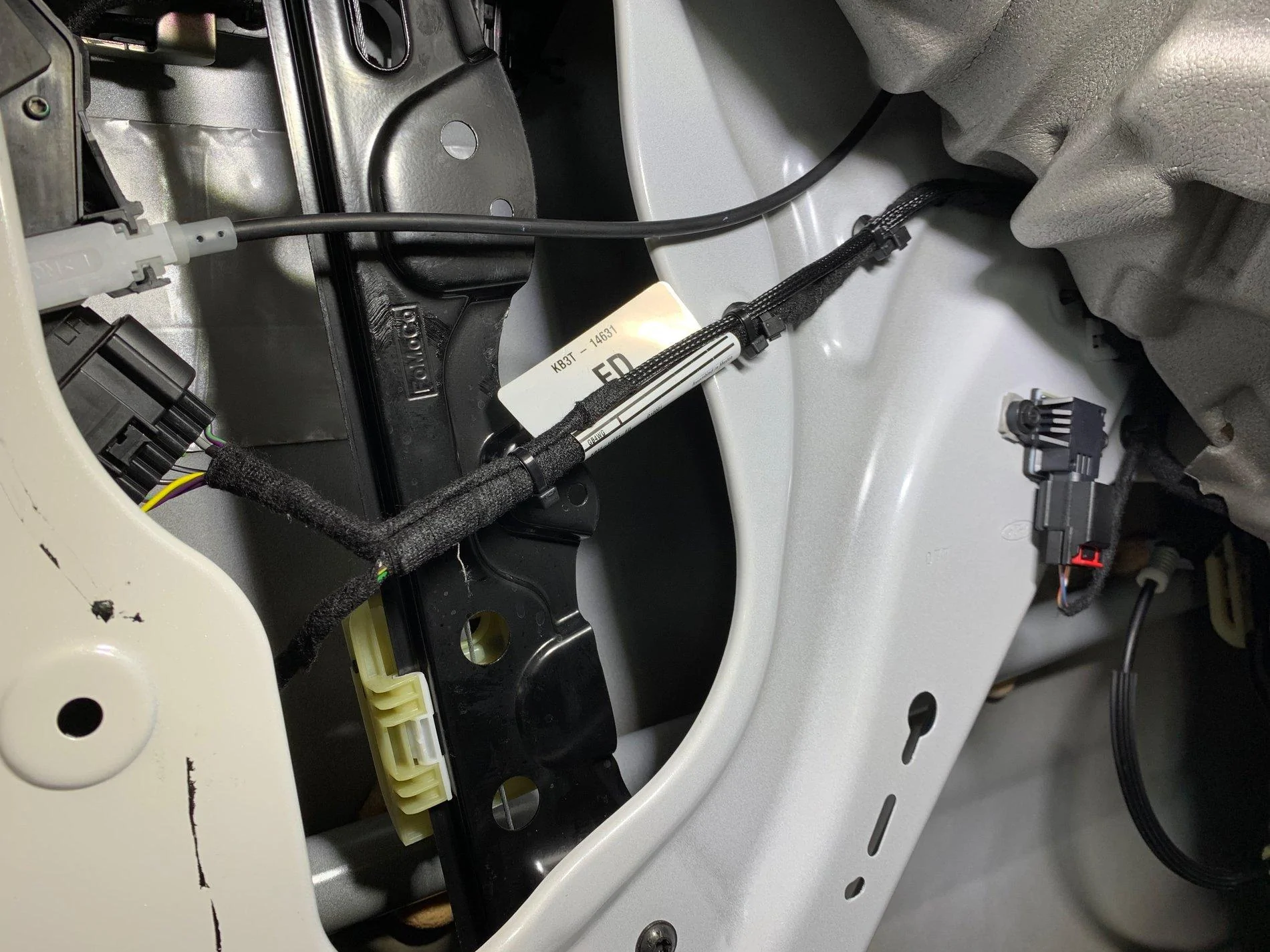

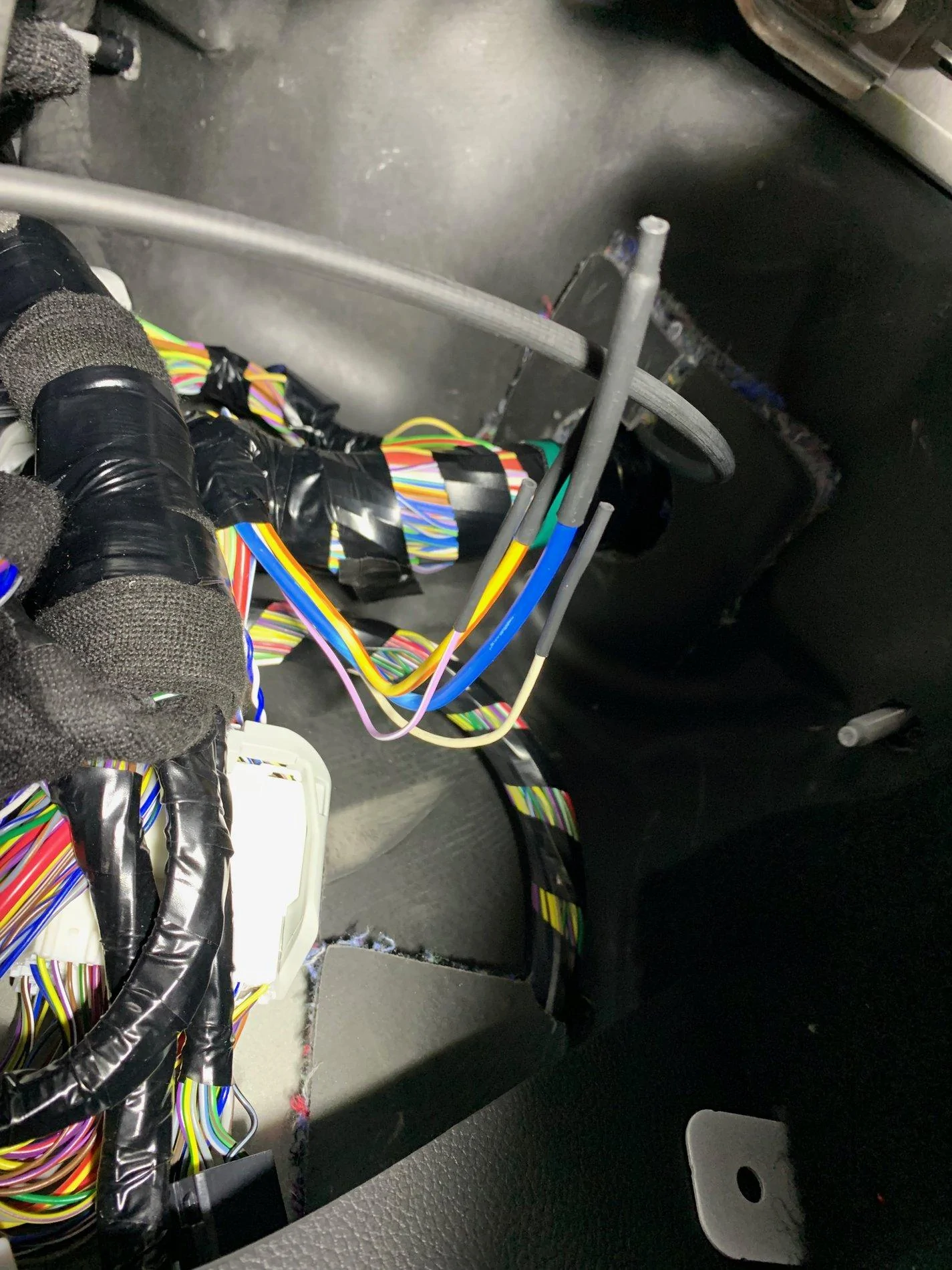

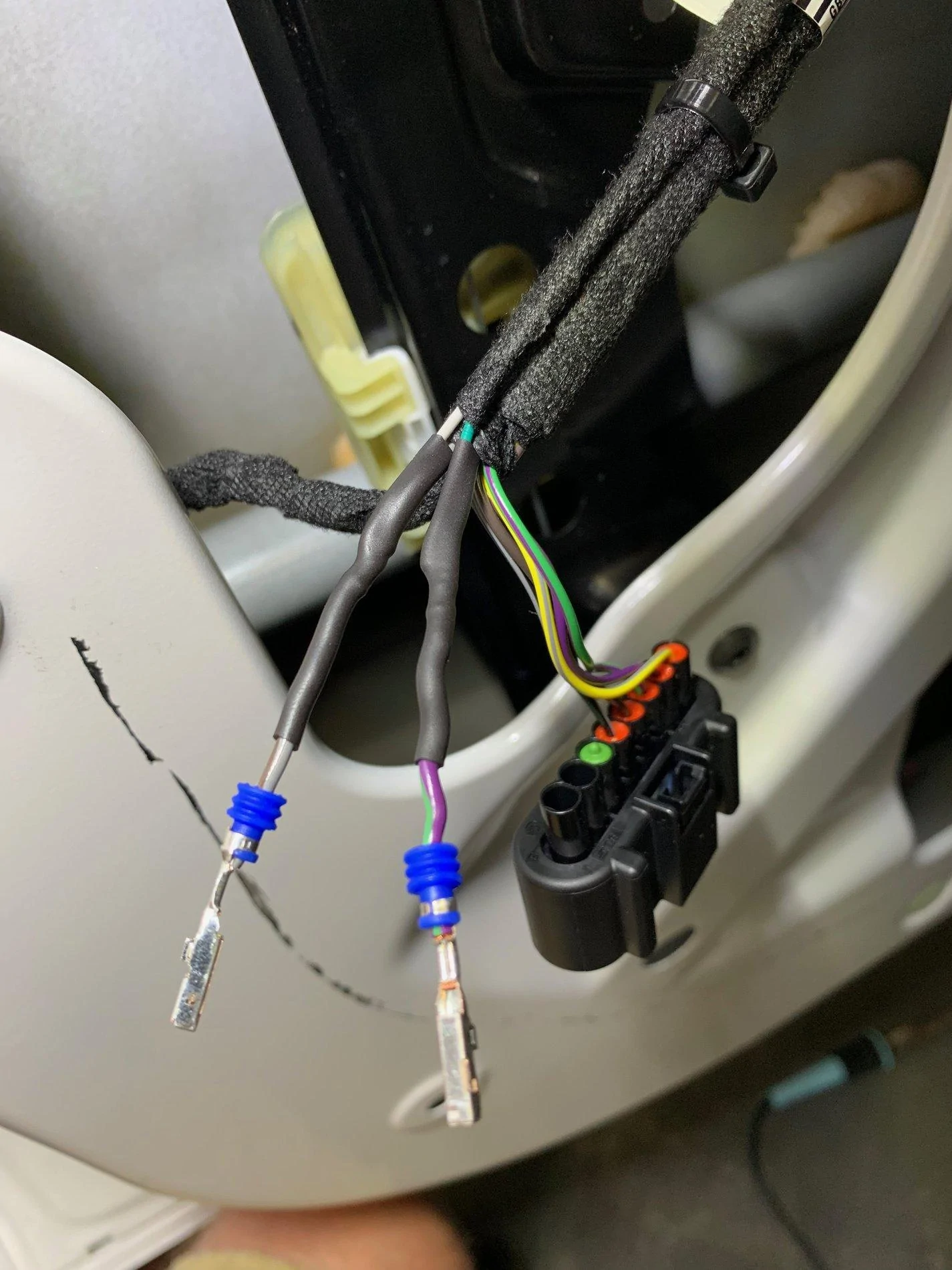

Monday came, so I had to install the RCMustang auto up/down window module, tint the front windows, and wrap a couple interior parts with vinyl.
I took a few pics of the wiring and how I installed the window module. I de-pinned the connectors so I could solder and heat shrink the wires that need to be tapped, then Tesa tape on the harness so it looks all nice and OEM.

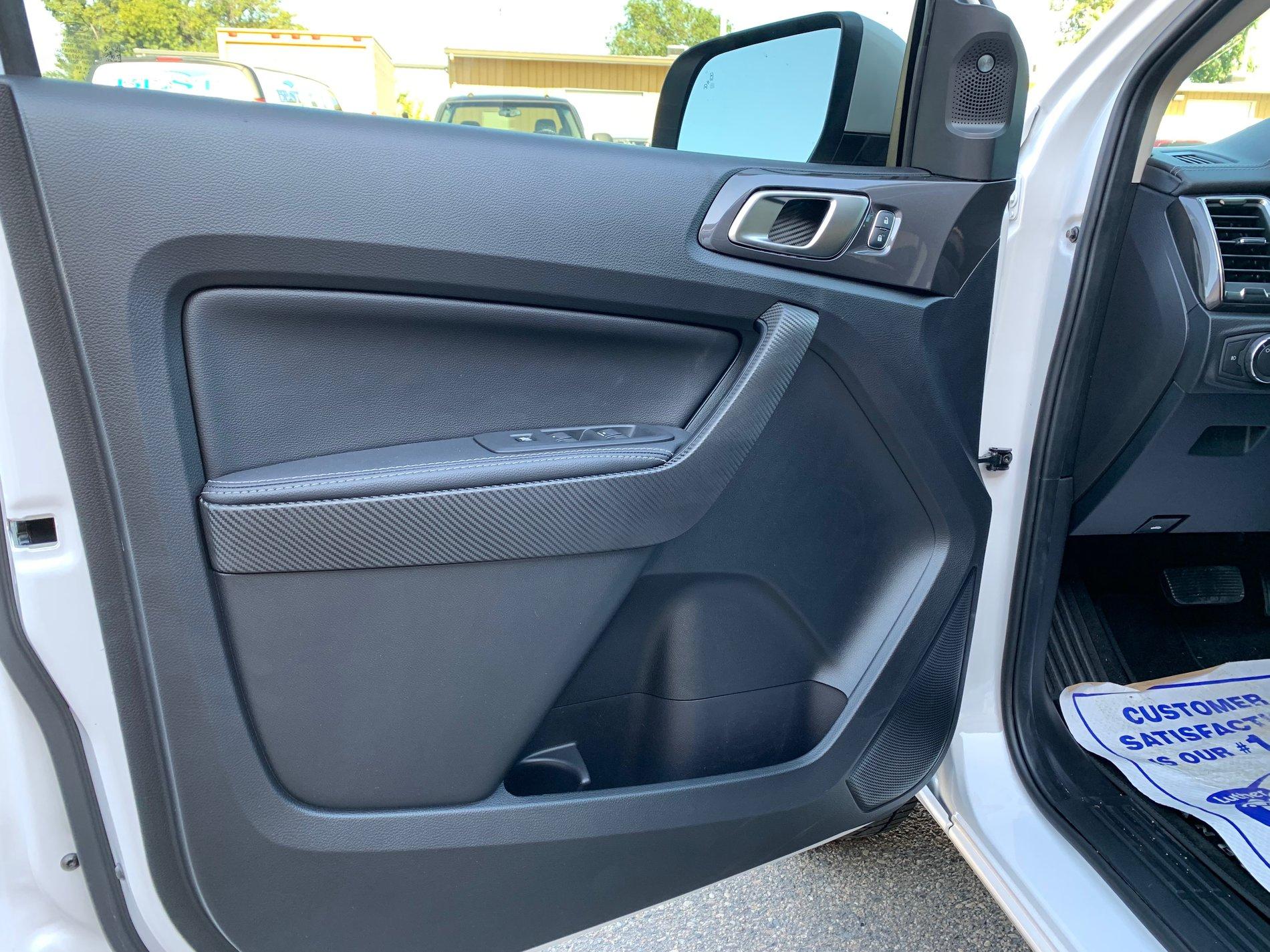

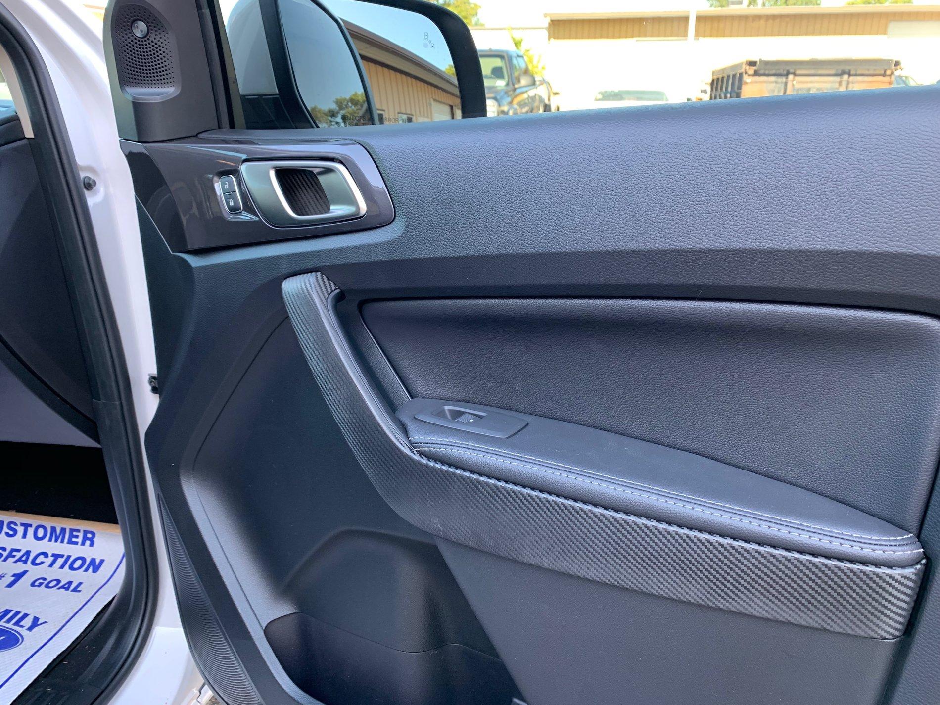

While I had the front door panels off, I used some 3M 1080 carbon fiber wrap vinyl to wrap the plastic parts of the door handles that come off. I foresee that plastic getting scratched up easily. I also did the small piece behind the door handle up top since those already had some marks on them. Haven't had time to do the rear doors yet, but will soon.

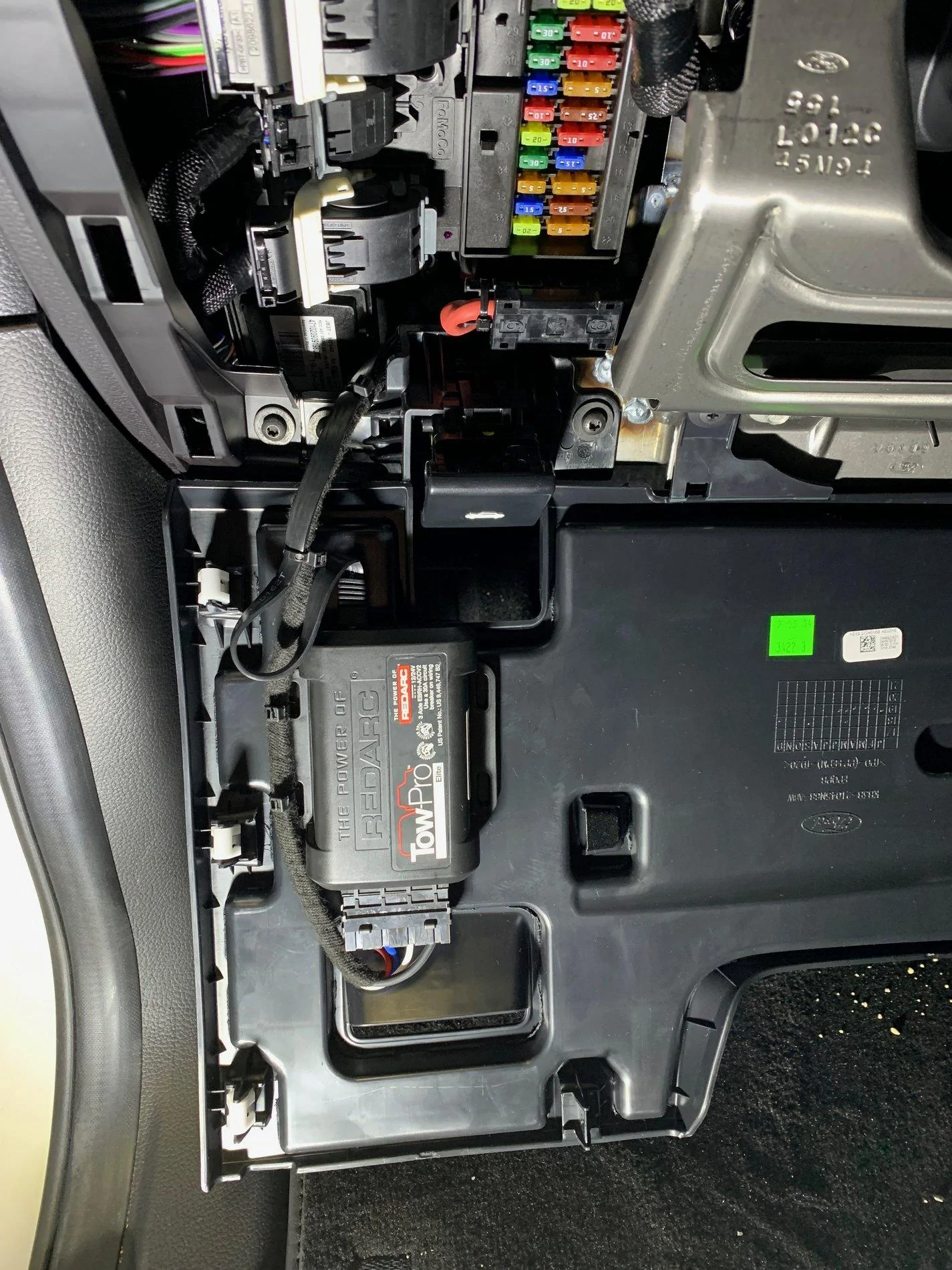

The next day I installed my RedArc Tow Pro Elite with the Lightforce switch fascia. I took a pic of where the trailer brake wires were since some people seem to have a tough time finding them. Just a note if you use this brake controller and switch fascia, you need a different RJ45 cable than what they give you. The ends on their cable are huge and interfere with something in the dash behind the switch fascia, so just grab a normal RJ45 cable and you'll be good to go. I mounted the brake controller to the back side of the driver's side fuse panel access cover.

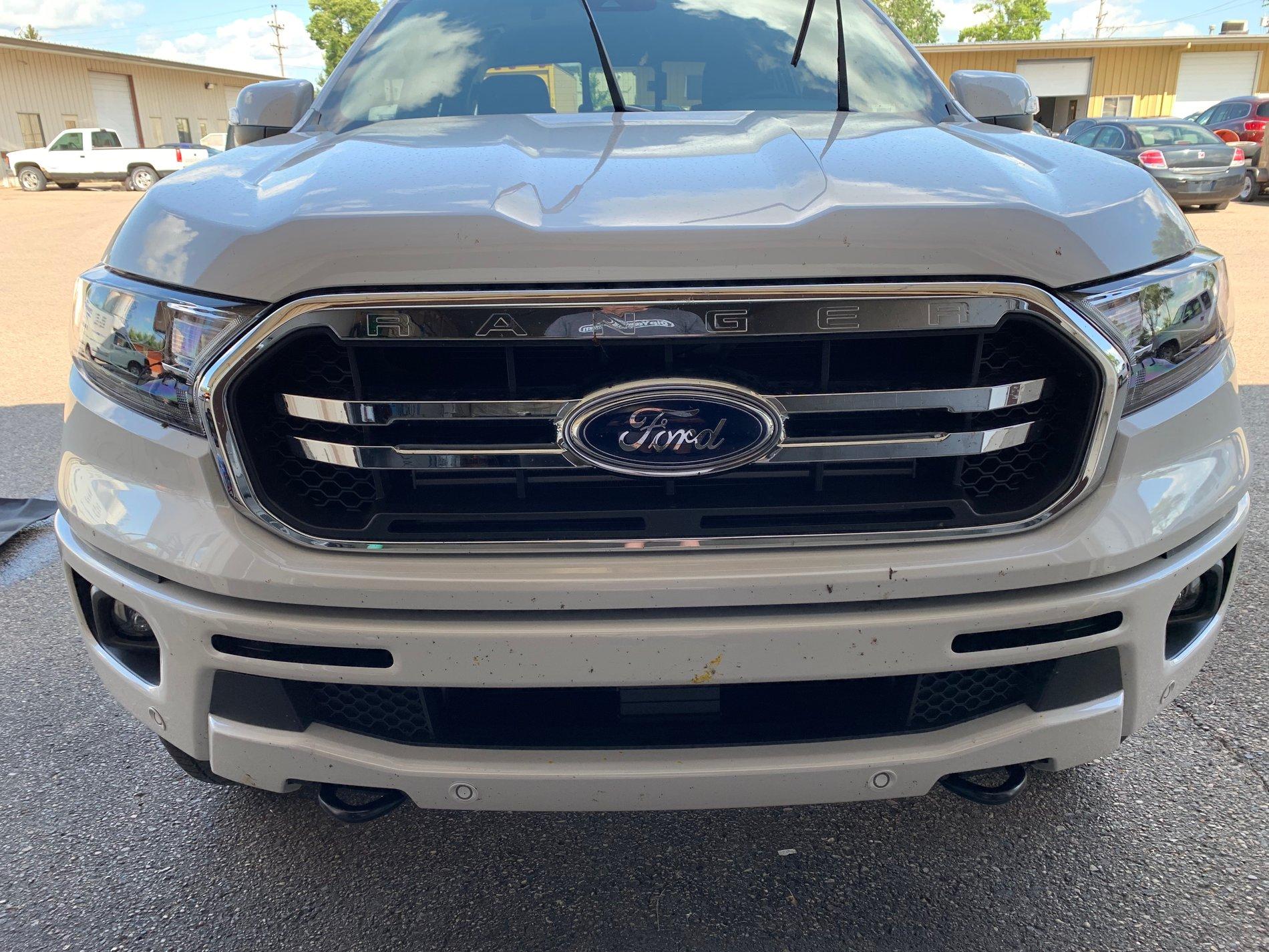

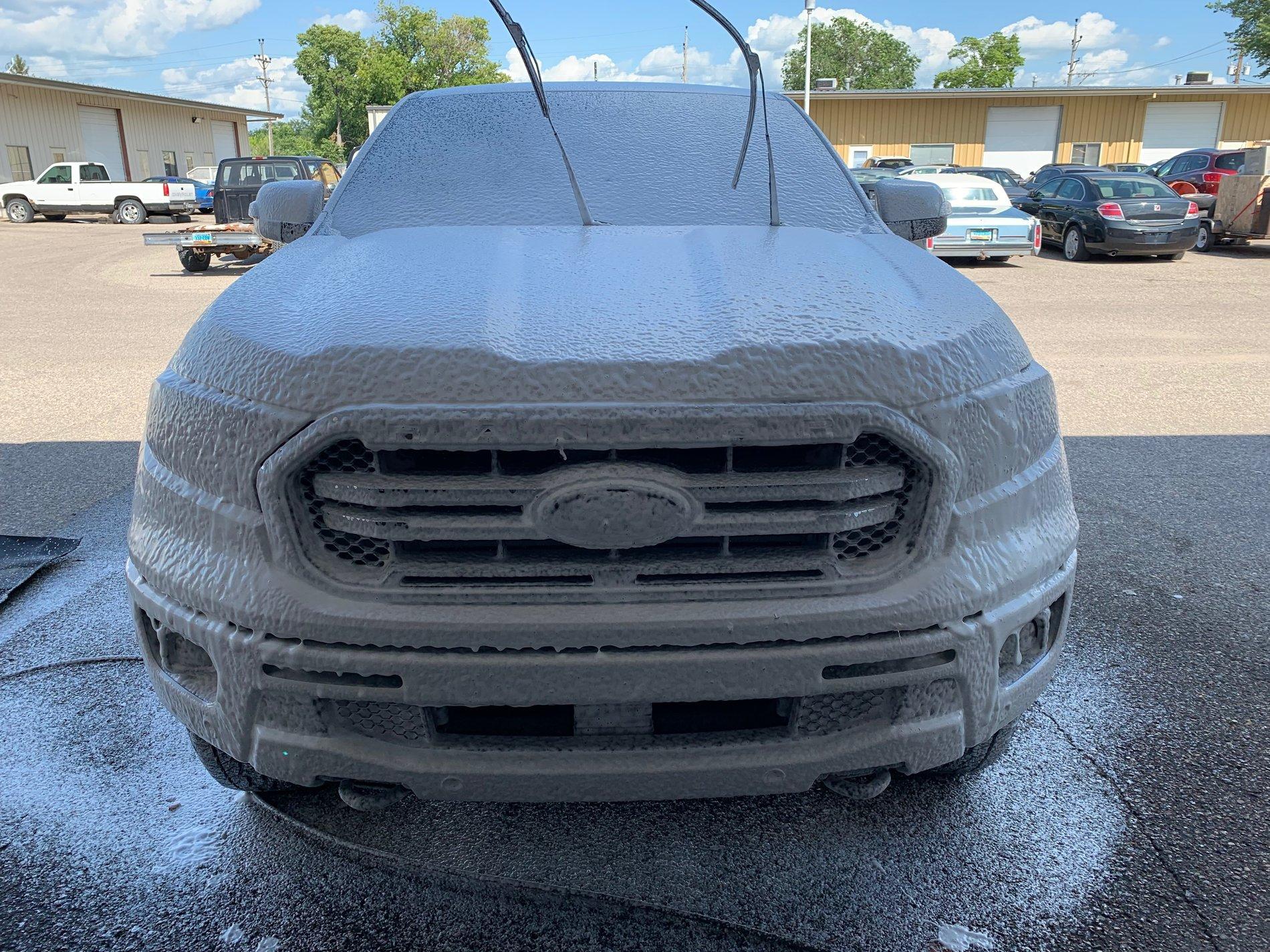

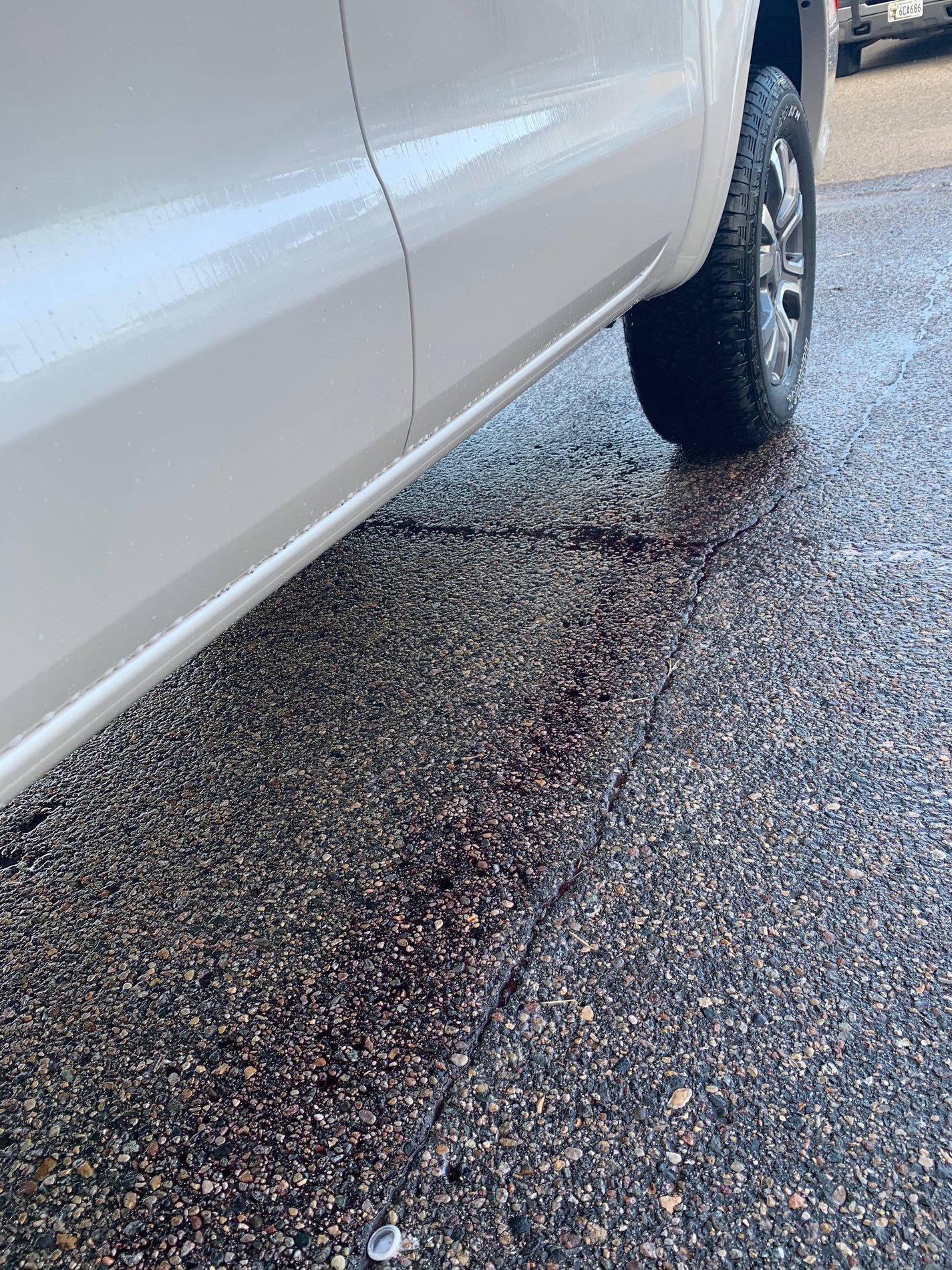

Gave the Ranger a proper bath after towing to the track and back last weekend. Scrubbed all the bugs off and then went back and decontaminated the whole truck using Car Pro Iron X. You'd be amazed at how many iron deposits are all over the truck for being so new. You can see all the red/purple iron deposits being dissolved, and on the ground it basically turned dark red because there was so much that came off.

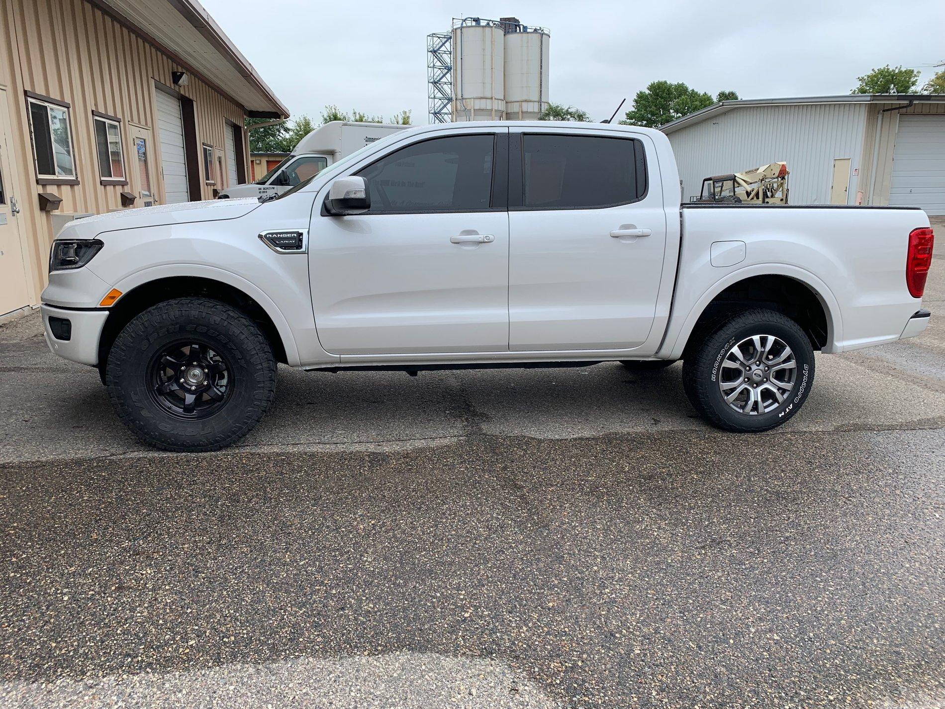

Also had to test fit a wheel/tire that I've had on my last 2 trucks. These are Konig Countersteer Offroads, 16x8 +0 offset. Tires are Toyo Open Country AT 305/70/16, so they're really wide. Looks like I'll have to install a lift, offset crash bars, and fender flares in order to run these on the Ranger.

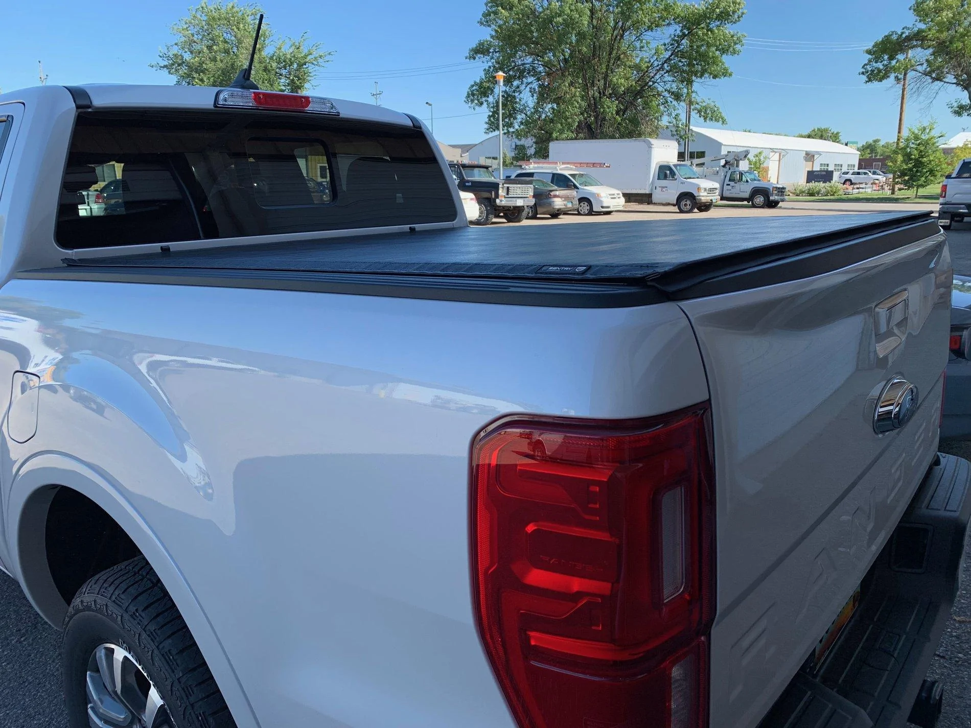

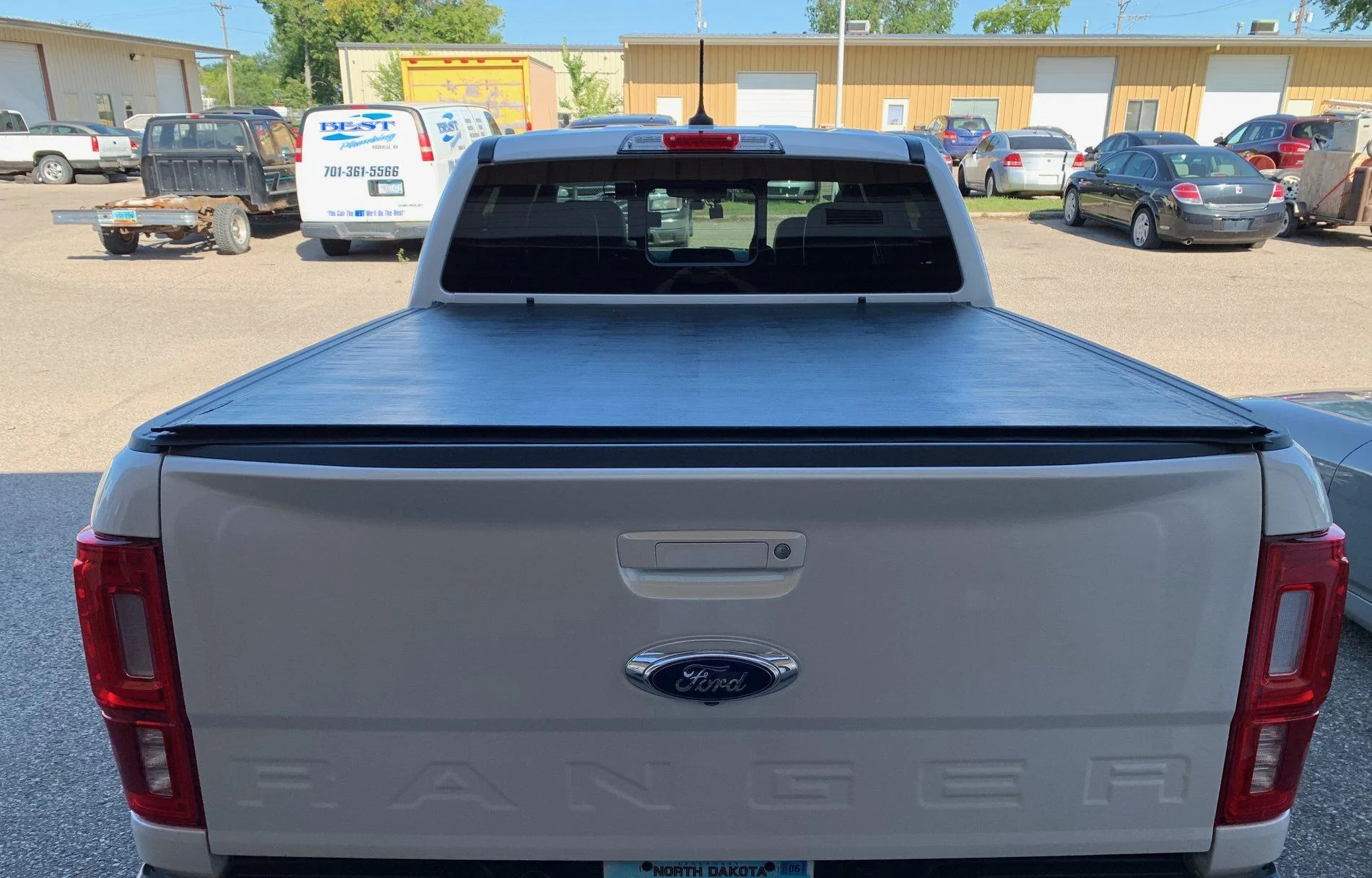

Just installed a new Truxedo Sentry hard rolling tonneau cover on my Ranger today. I got this because I had a Truxedo Titanium cover on my last truck and loved it. The Sentry is similar, but better. The latches are better, and the whole cover is lower profile, plus the under side of the cover is black aluminum slats. I also installed a Bed Rug at the same time today. The Bed Rug and Sentry cover work perfect together. After washing or rain, I'll check to see if/how much water leaks into the bed. I did add some extra pieces of foam sealing tape in the front corners of the box to hopefully help keep the box dry.

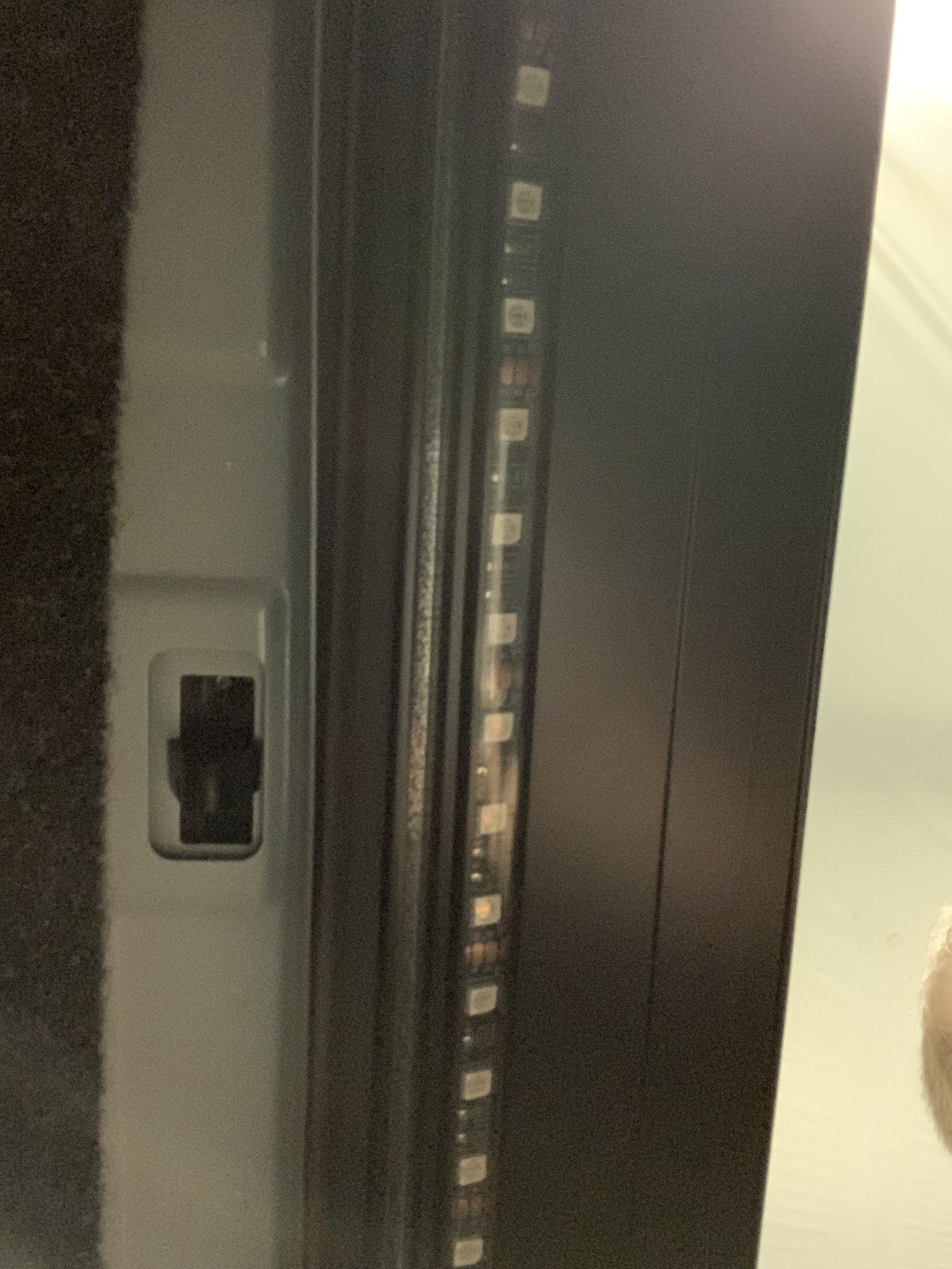

Been really busy and forgot to add some more new changes from the summer. Back in August I threw in the Truxedo Expedition truck luggage cargo carrier in the box. Also added the LED strips underneath the tonneau cover side rails to light up the box. I wired that up to the cargo lamp switch so any time the rear cargo light is on, so are the box LEDs.

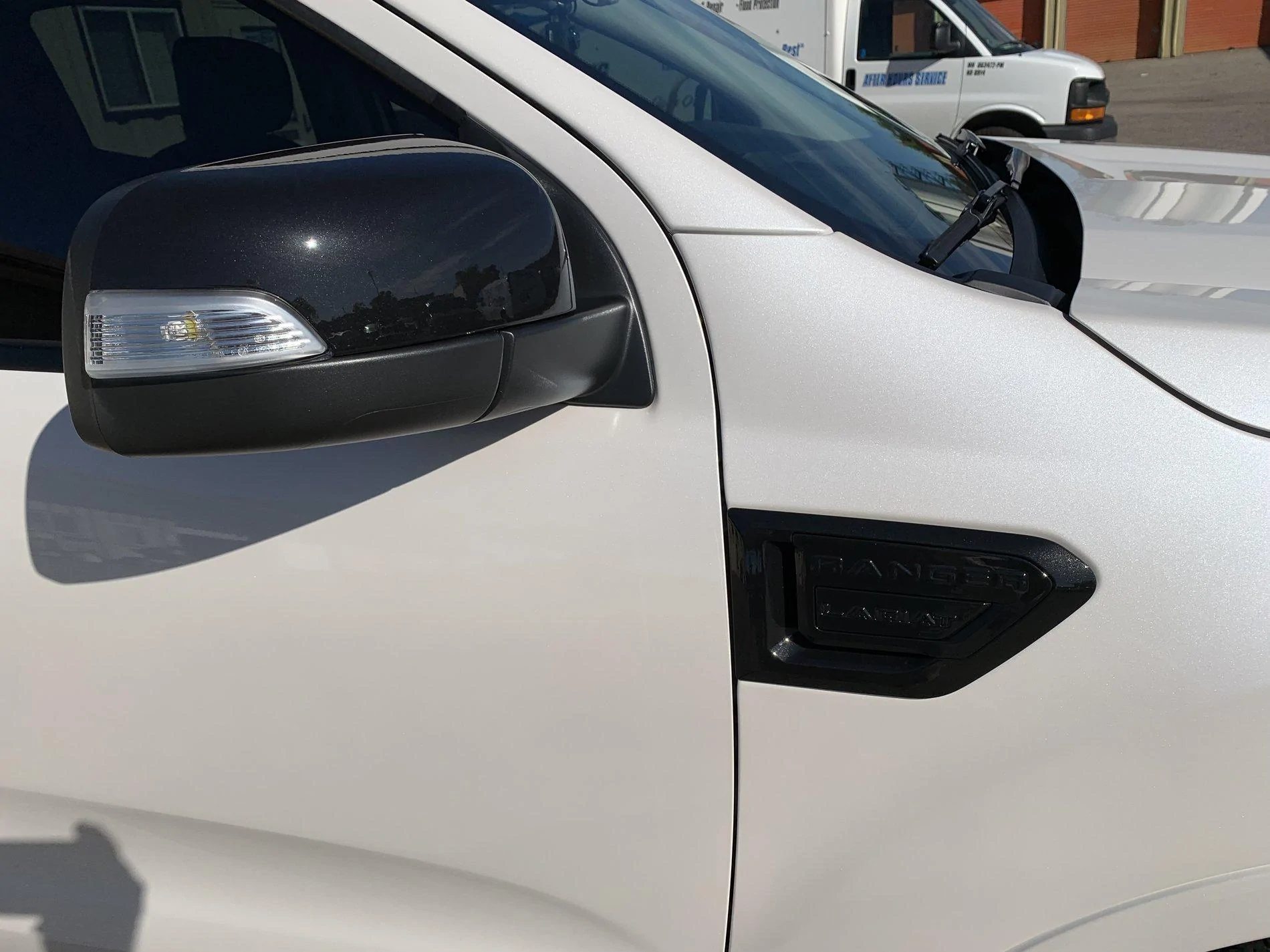

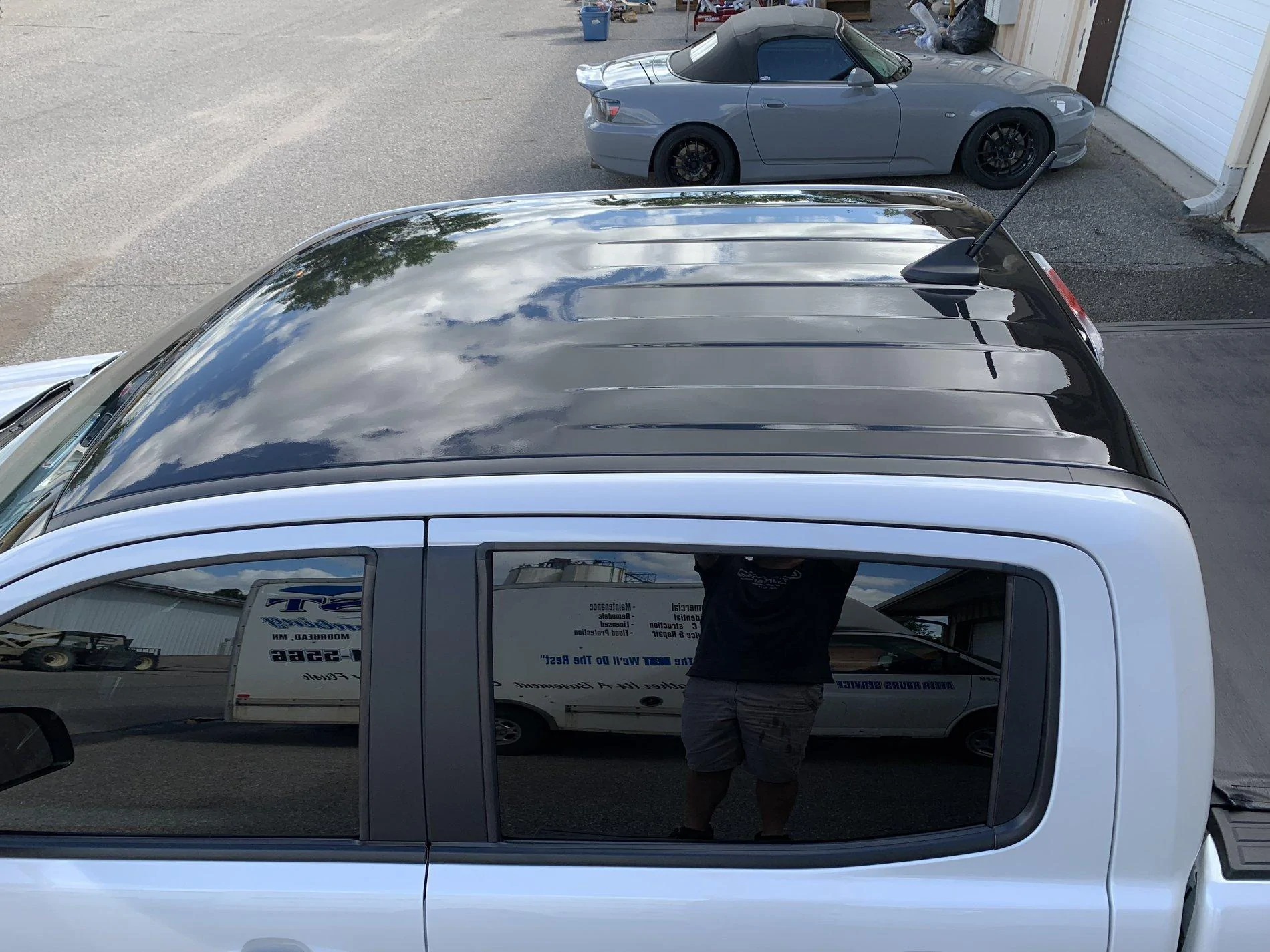

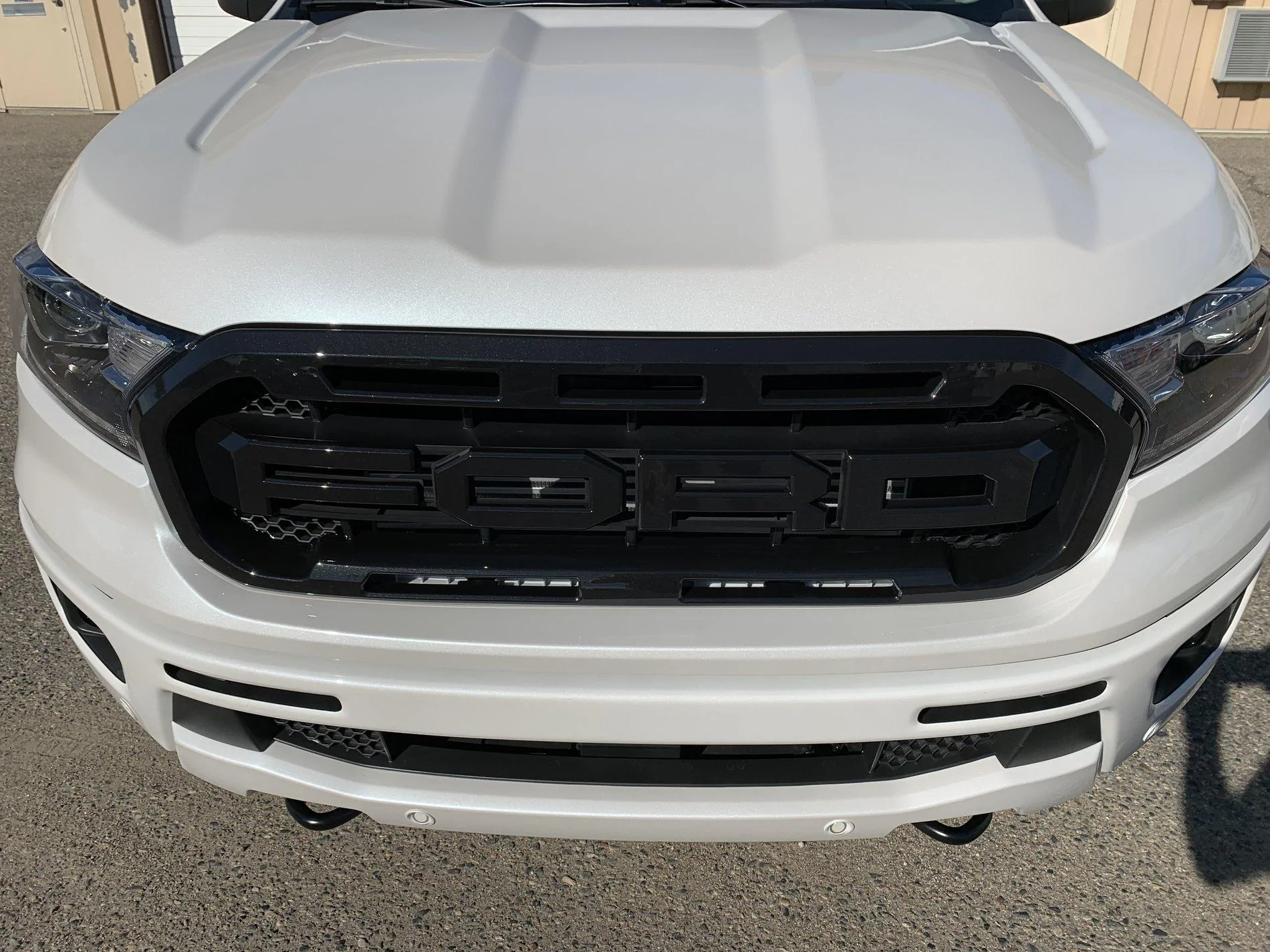

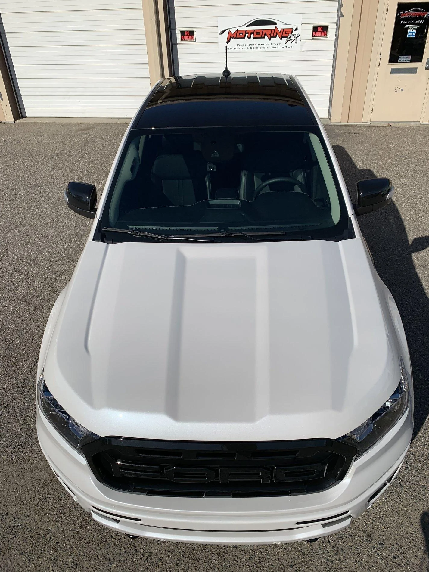

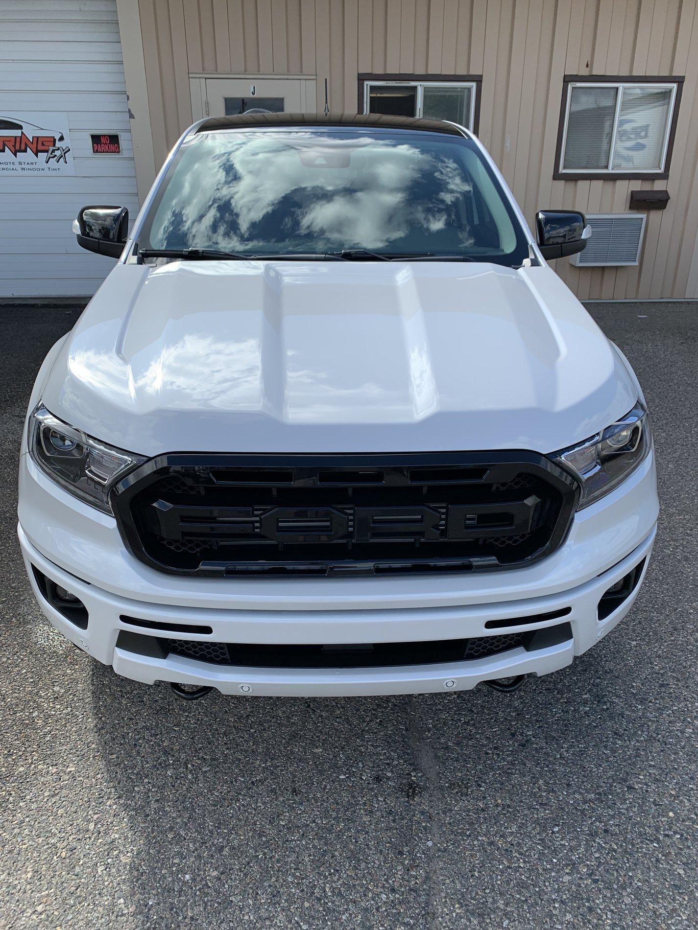

Also went a little crazy and blacked out some parts on the truck back in August. I love a white vehicle with a black roof, and decided to go ahead and do that. The roof, mirror caps, fender emblems, Raptor grille surround and letters are all gloss black with a bit of metallic mixed in. This isn't paint, vinyl, or plasti dip either. This is all done using Autoflex Express, which is a removable paint.
