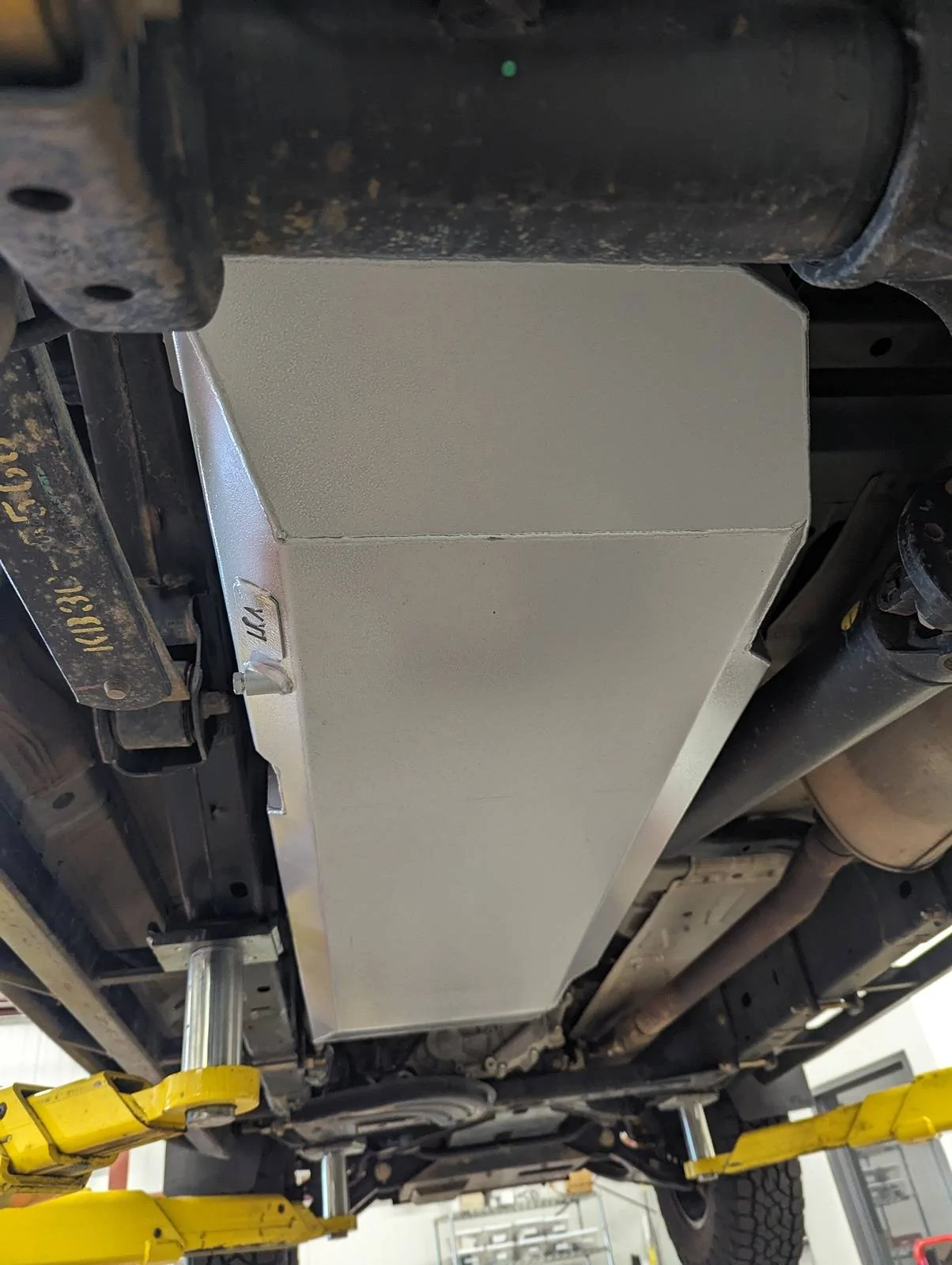

I did my LRA tank Install Last weekend, It was about what I expected, took about 6 hours total, an hour and a half to drop the tank, 2 and a half to get the hoses all set up and about 2 to get the new tank back in place. I can see where the instructions are lacking for certain items. It was no different to all the other fuel tanks I have done and far easier than any of the AUX tanks I have done from them before.

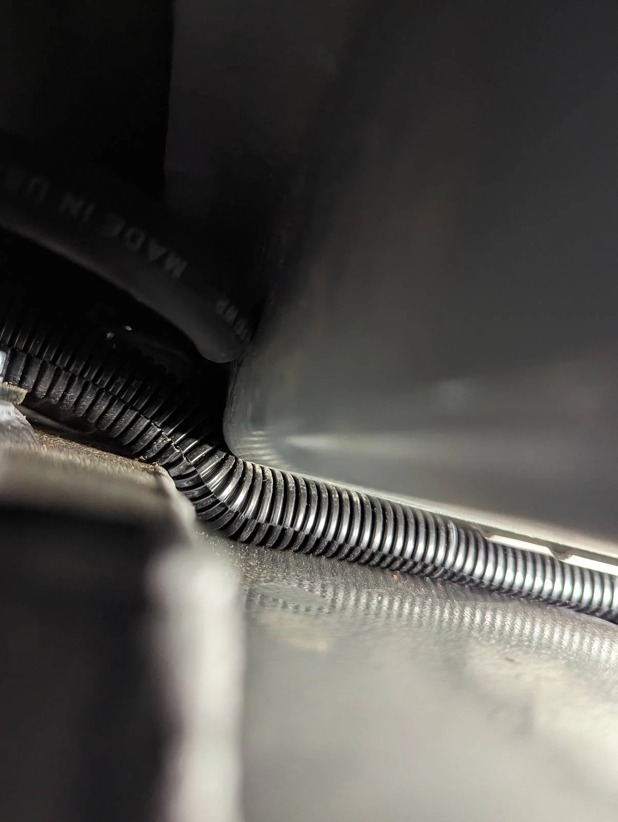

I think the biggest trap is making sure all the EVAP line go OVER the crossmember. not under, they will get pinched especially the fuel return line, (green clip up front, Yellow at Evap.) as well as making sure you done winch that same home between the bed rails and the tank, Mine is close but its only squishing the split loom.

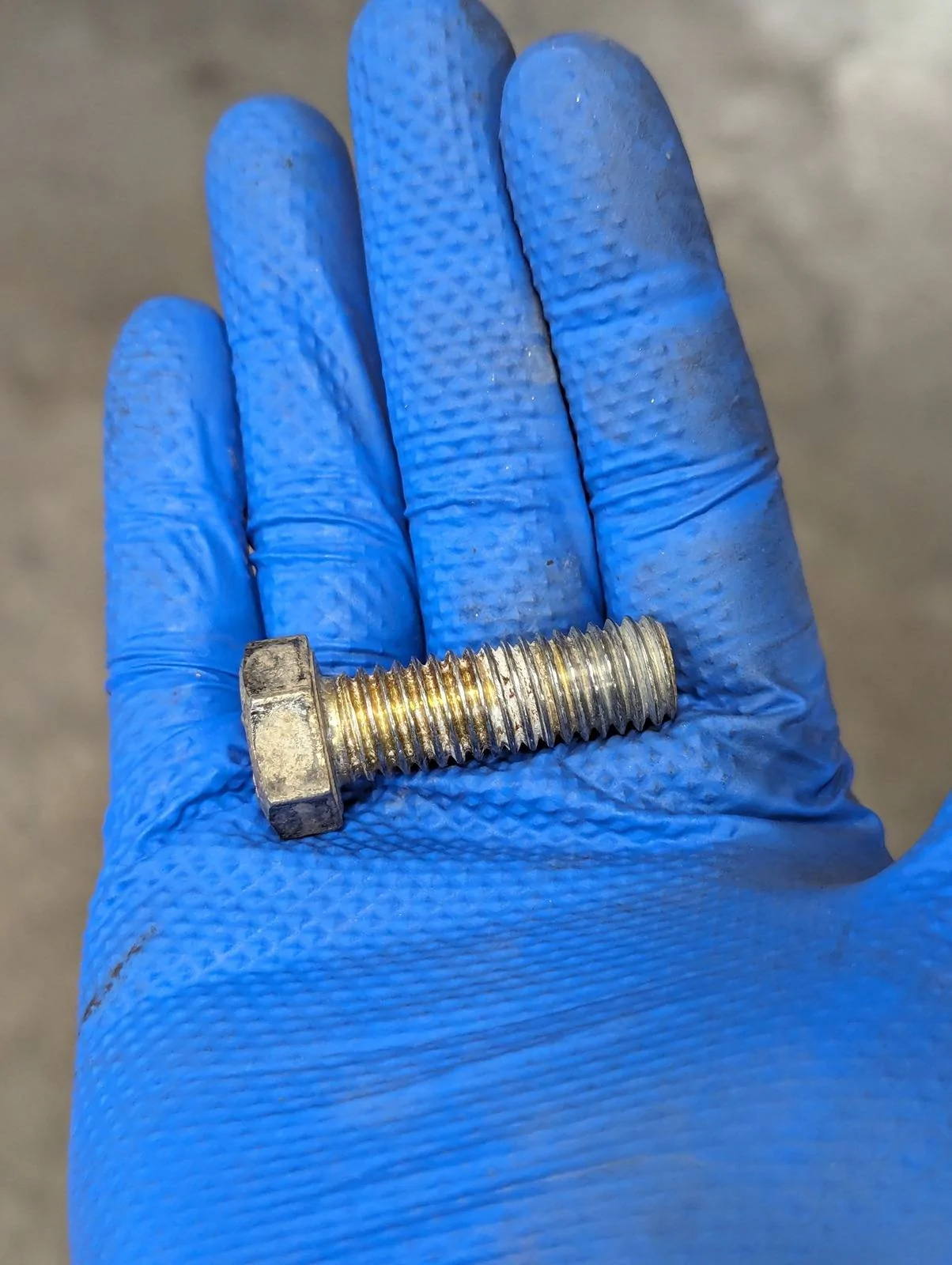

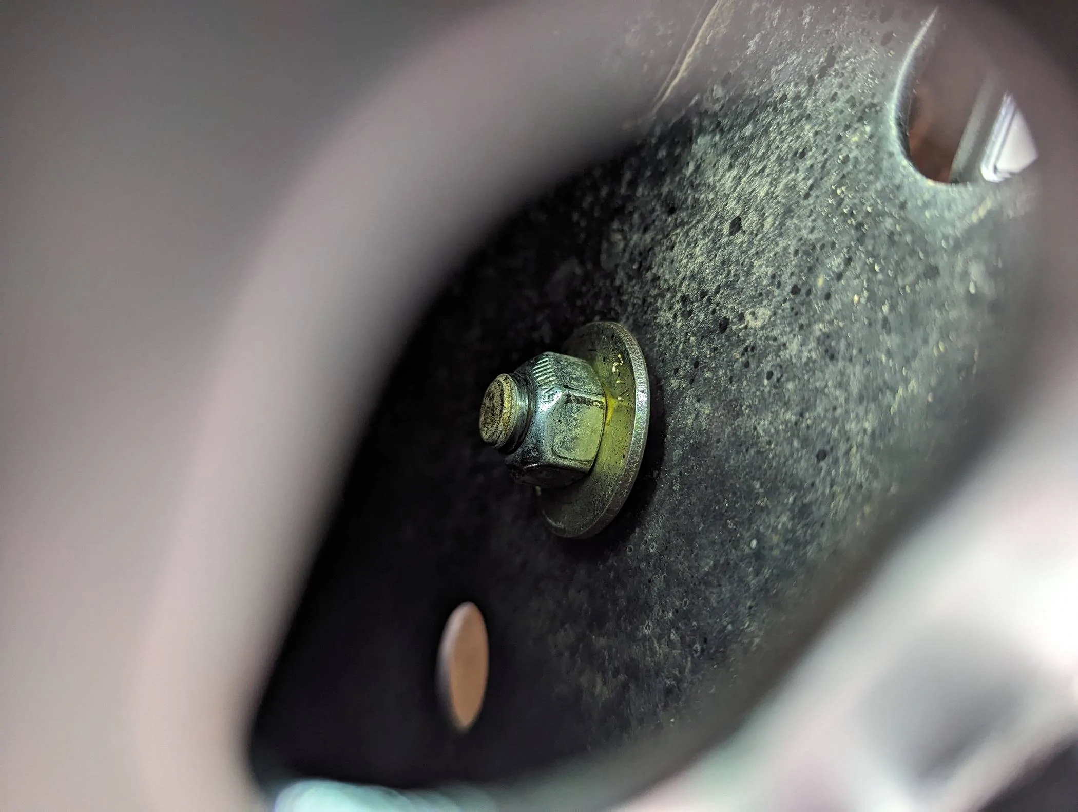

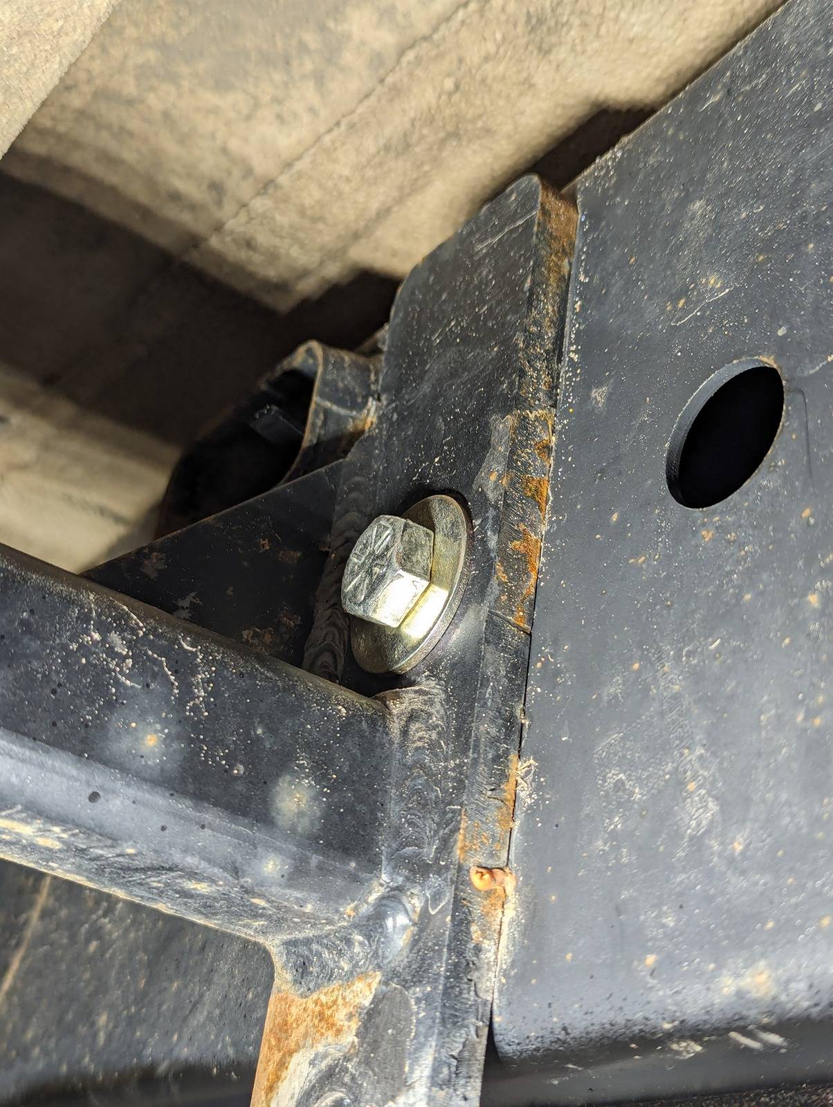

I did as anyone with the White Knuckle sliders run into the fact the rear driver side mount interferes. I am also very opposed to welding sliders to the frame and in my opinion think its the worst way to do it. So after about 5 minutes I found a work around. All you need is a 2" Long, 1/2" grade 8 Bolt, a Washer and a Nut, I replaced the upper long bol that runs through the frame with this bolt and when the tank is out there is super easy access to the back side and a perfect hole to put a 3/4" socket through to tighten the bolt. I used a Stover Nut so it wont come loose and a large 1.5" Washer on both sides. After picking the truck up with a HiLift the slider seems just as stable as before and I doubt it will move. But time will tell.
2" Long was perfect, but you could use 2.5 or even 3" without issue.
Large Washer. Clamping the Mount
Inside the hole does have a curve to it so the washer sits against that not the frame. But I could get it nice and tight, Way tighter than the old mounting system could in this area.
Is it the best solution ever, no. But It works for me and the couple times of year I actually hit my sliders, a Custom bend plate to maintain the clamping top and bottom would work but I didn't feel like spending a couple hours fabbing it up. This was cheap and easy.
